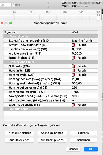

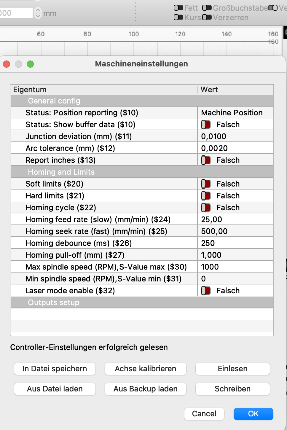

Hello Martin
- Edit \> Device settings. Please take screenshot
- In Console window - where it says “type command here”
type:
$i
press enter
press enter
Scroll up and copy/paste the full output and paste it here please

Hey thanx for the fast replay:')
Here is what I found in Console:
But I dont know how to type there and where is the Dollar Sign im my Mac keyboard?

Some of your data is a bit odd
$100=40.000
$101=40.000
$130=150.000
$131=150.000
$30=1000
$31=0
$32=0

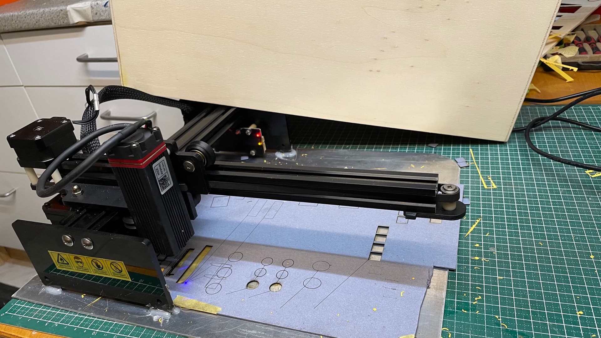

Can you post a picture of your laser please?
<div class="post-metadata">
**Author:** ![Maexhoe](https://forum.lightburnsoftware.com/letter_avatar_proxy/v4/letter/m/ba9def/32.png) [@Maexhoe](https://forum.lightburnsoftware.com/u/Maexhoe)\
**Post date:** [July 23, 2024, 12:24pm UTC](https://forum.lightburnsoftware.com/t/neje-master-20-laserleitung-nicht-regelbar/144608/5 "2024-07-23T12:24:51Z")
</div>
![IMG_6766](https://forum.lightburnsoftware.com/uploads/default/original/3X/f/b/fb7d128c118af4ad86210fc33263442f52443788.jpeg)
its a Neje 20 Watt Laser
