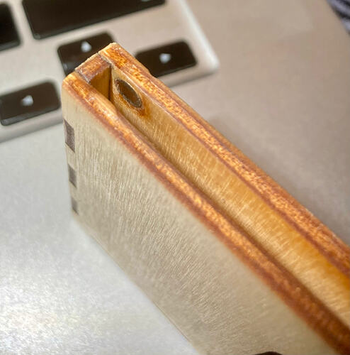

This is how I do it ;-), I use it occasionally for locks on my boxes and similar projects.
You need to find a piece of leftover material and test your engraving. I use crosshatch for that and sometimes several passes. Finally I scrape out the burning material and pressfit the magnet into the hole, a drop of superglue to secure it all, done.
When I insert the magnet I have 2 magnets on top of each other in my fingers, otherwise it can happen that they are mounted with the wrong polarization.

Here is a small example
