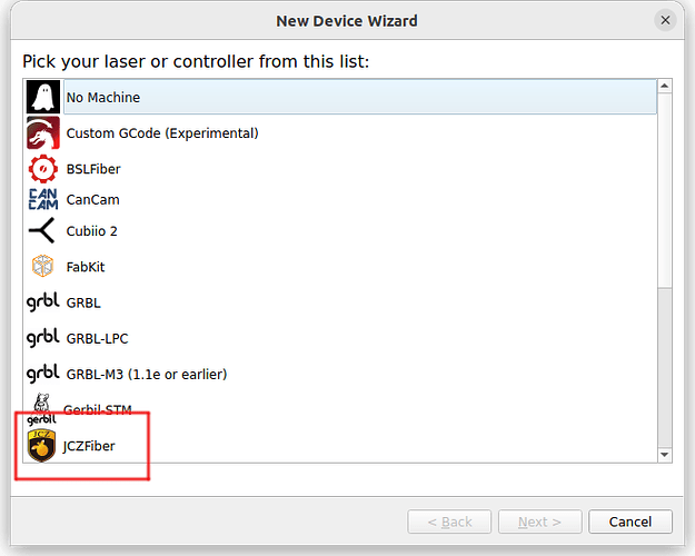

**My setup:**
- LightBurn version: 2.0.02 (Windows 64-bit)
- License type: Pro (GCode, DSP, Galvo enabled)
- Galvo hardware: BJJCZ Laser Mark Control Board V4 [USB]
- Drivers: BJJCZ driver installed and confirmed working in Device Manager
**What I’ve tried:**
- Fully uninstalled and reinstalled LightBurn (cleaning `%appdata%\LightBurn` and `C:\Program Files\LightBurn`)
- Installed the EZCad2 driver during setup
- Ran LightBurn as administrator
- Verified license activation shows “GCode, DSP, Galvo” enabled
- Device Manager shows: `BJJCZ Device → Laser Mark Control Board V4 [USB]`
- Despite all this, the **“Galvo” option never appears under Devices → Create Manually.**

> [@Am4828](#):
Don’t know that much about UV machines, but the EZCad2 driver will not work with Lightburn on my fiber, I’d suspect the same thing with a UV as the only difference is the laser source.
[![](https://img.youtube.com/vi/lGO9IsJbN14/maxresdefault.jpg "EASY! Swap Between LightBurn and Ezcad FAST") ](https://www.youtube.com/watch?v=lGO9IsJbN14)
Might have to create yours manually, but you have to use the correct drivers.
> [@Am4828](#):
It may be only listed as a JCZ device.
 ![image](https://forum.lightburnsoftware.com/uploads/default/original/3X/9/d/9d26715527c86e337d756fecd1b4d6d92e1073f2.png)
The last one is the controller. Might not say galvo.
