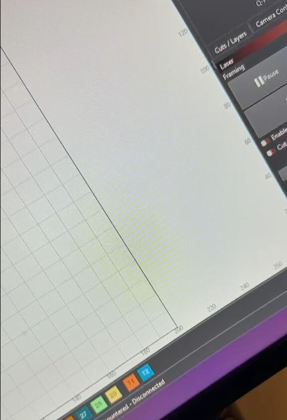

New galvo set up second decice getting error disconnected message
New Chinese galvo
100w JPT MOPA
Windows 11
Lightburn 2.0.?
First power on LightBurn found the laser
It came with the 110 lens installed so I set up that device.
Did a test cut/mark -success
Went to add a device to set up the 200 lens.

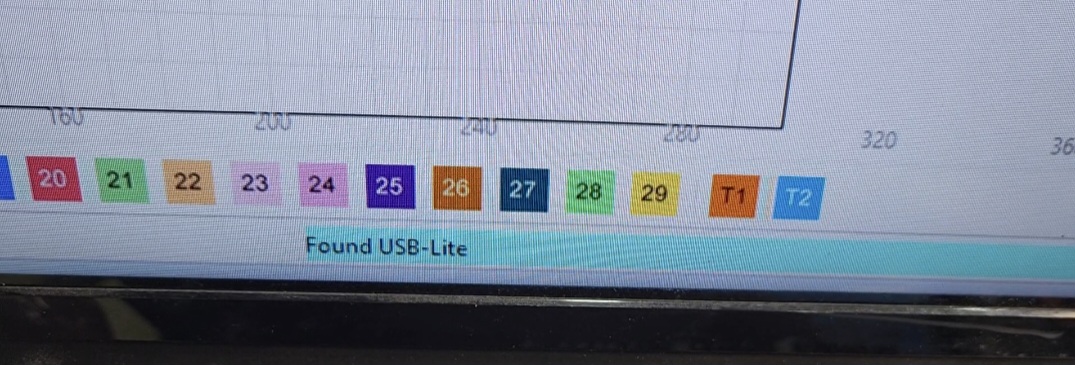

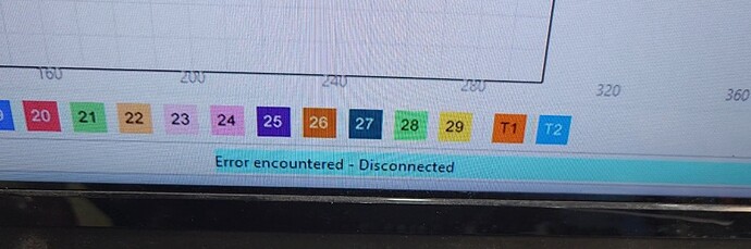

And that is when LB started to present the message at the bottom of the screen. “Error Detected - disconnected “ then presents " Found USB-lite"
Has anyone ran into this?
Im sure this is self induced, but figued i would ask before i started to assume remedies.
Thanks in advance

After you see “Found USB-Lite” does the galvo work again?

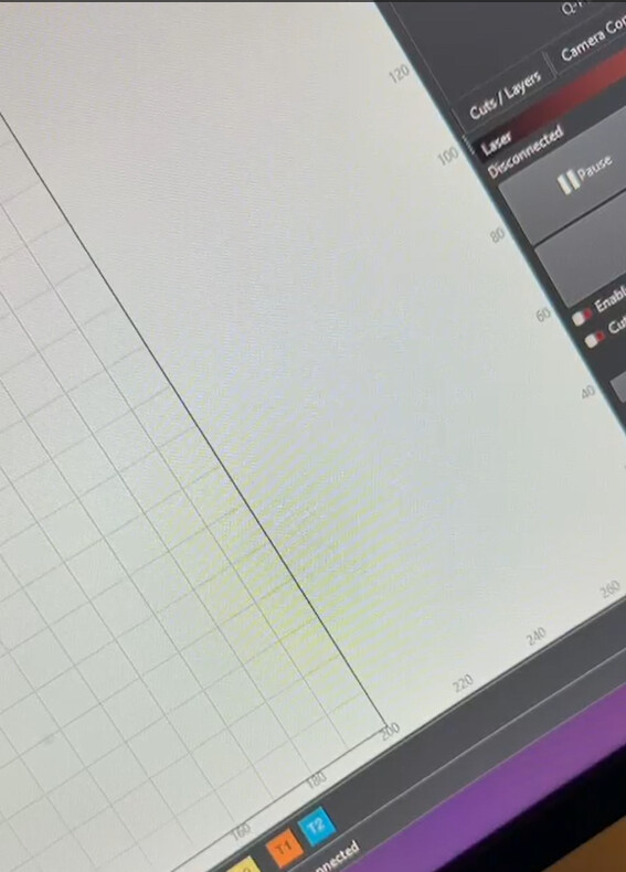

The two messages flip constantly between error … and found …
I attempted to post the video but format prevented that.

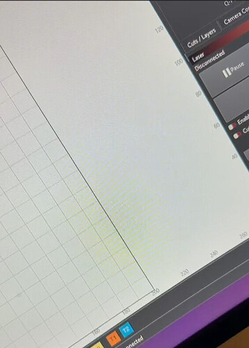

The laser control window flips between framing and disconnected. Which makes sense with the other messages.
Is there a log somewhere that will describe the error found?

Hi , Aaron.F. My new machine has a strange problem. Has anyone else experienced a similar issue?
When I use the machine, the Lightburn connection prompt keeps switching between Ready, Framing, and Disconnected. I’ve tried downgrading Lightburn to version 1.7 and using version 2.0, but the problem persists.

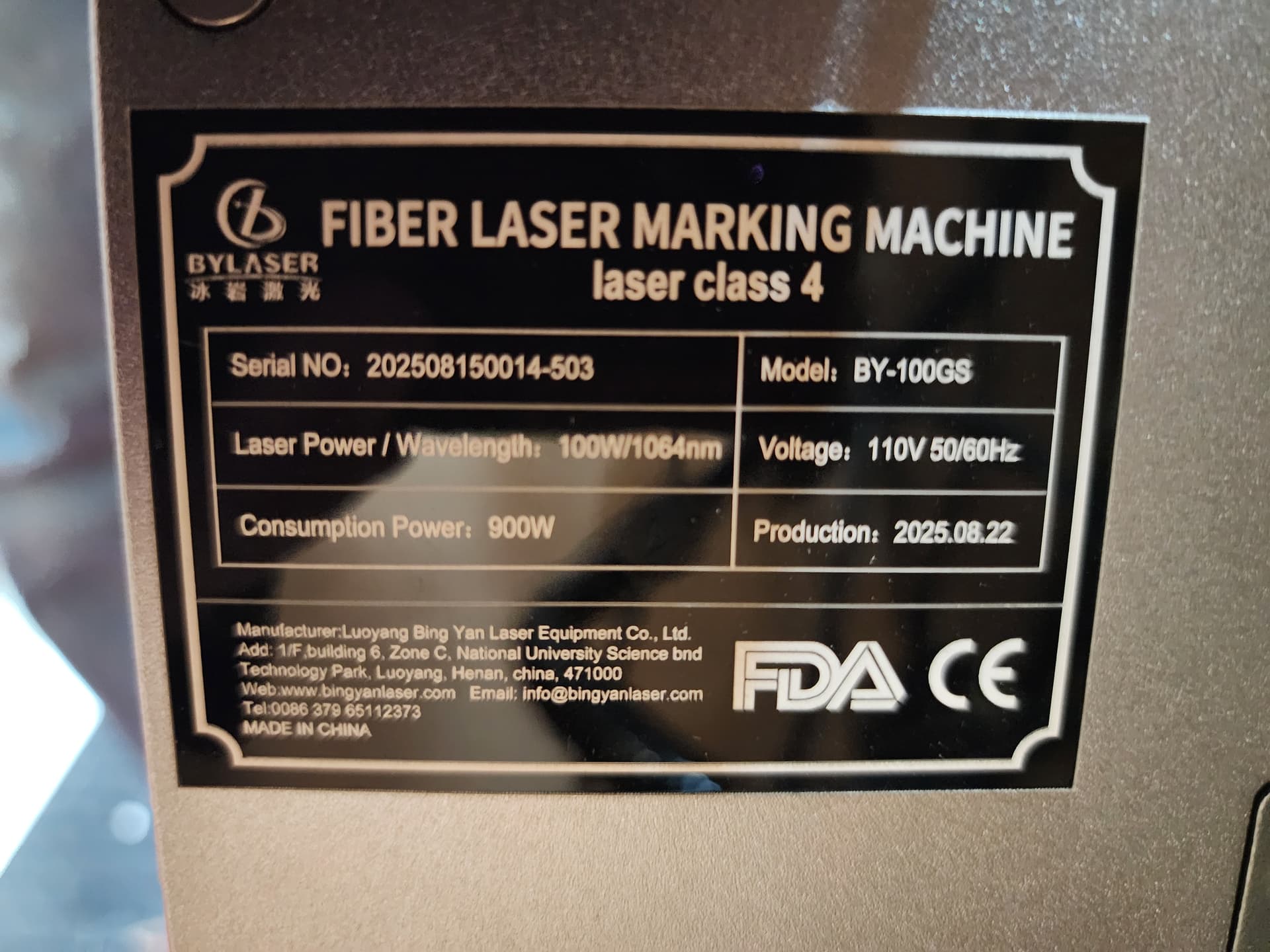

@AndreGomez What you’re describing sounds similar to what @Tbdllc-usa reported.
Can you both share the brand and model of your laser?

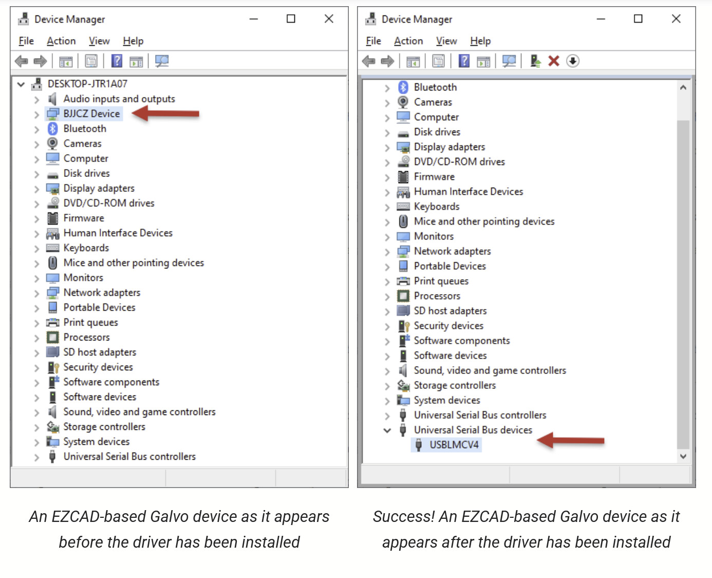

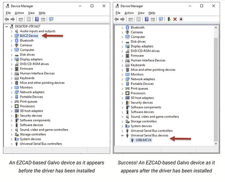

One thing to point out is that you need to swap the driver when going from EZCad2 to LightBurn.
I would have expected that it wouldn’t connect at all, if the wrong driver was installed, but it’s worth making sure:
After installing the driver, the laser will appear under Universal Serial Bus devices as USBLMCV2, USBLMCV4, or something else similar.

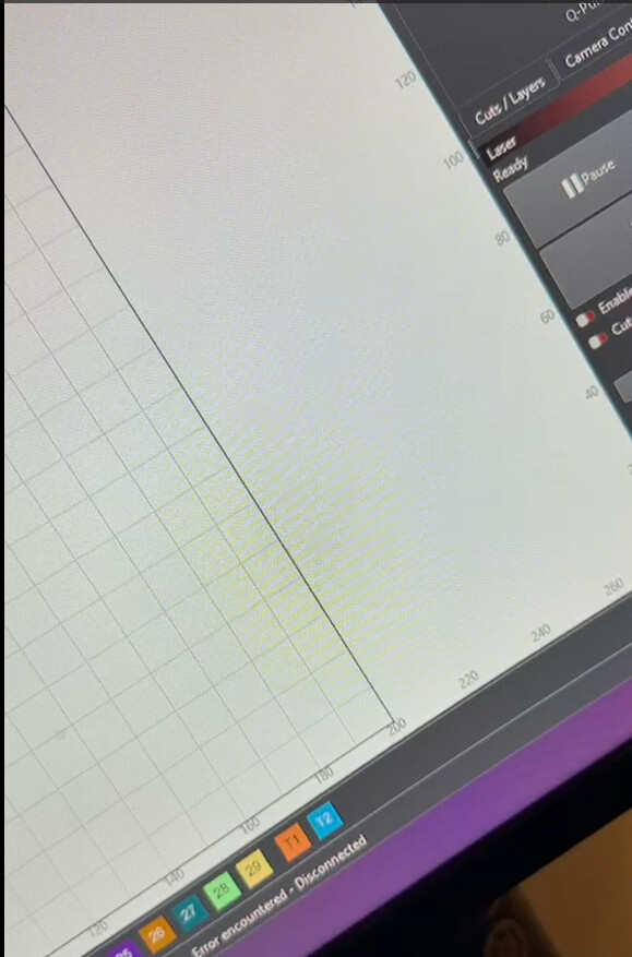

UPDATE
The situation has returned. I have been using the machine earlier today. But came bac this afternoon and LB is throwing this error again.
Video here https://youtube.com/shorts/AhonGNn9Mwk?si=ABWOEGd_WyM0FiCi
Machine dataplate picture
I did catch the error. “Bad board signature” you can catch that in the video.

So what a difference a day makes.
Fired up the system and no issues. I created a second devices as described by duplicateing the one that worked. The loaded in the mkcfg7 file for that lens and both devices seem to work well.
No hardware change or adjustments needed.
Thank you for the support. If this reappears ill post video.
