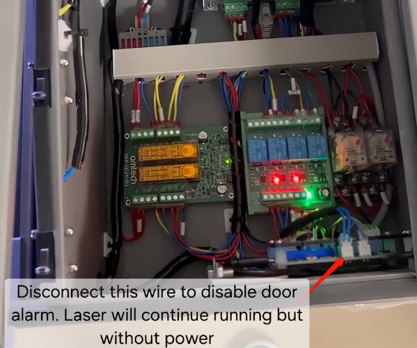

New laser owner! I have to type $X to unlock every time I open and close the door?
So I haven’t tried that option yet - was just gonna go ahead with using the stop button in place of typing $X.
I did ask them for a picture of the wire in question and they sent this, if it’s of any help to you. But again, I haven’t tested it myself. Let me know if you do!
