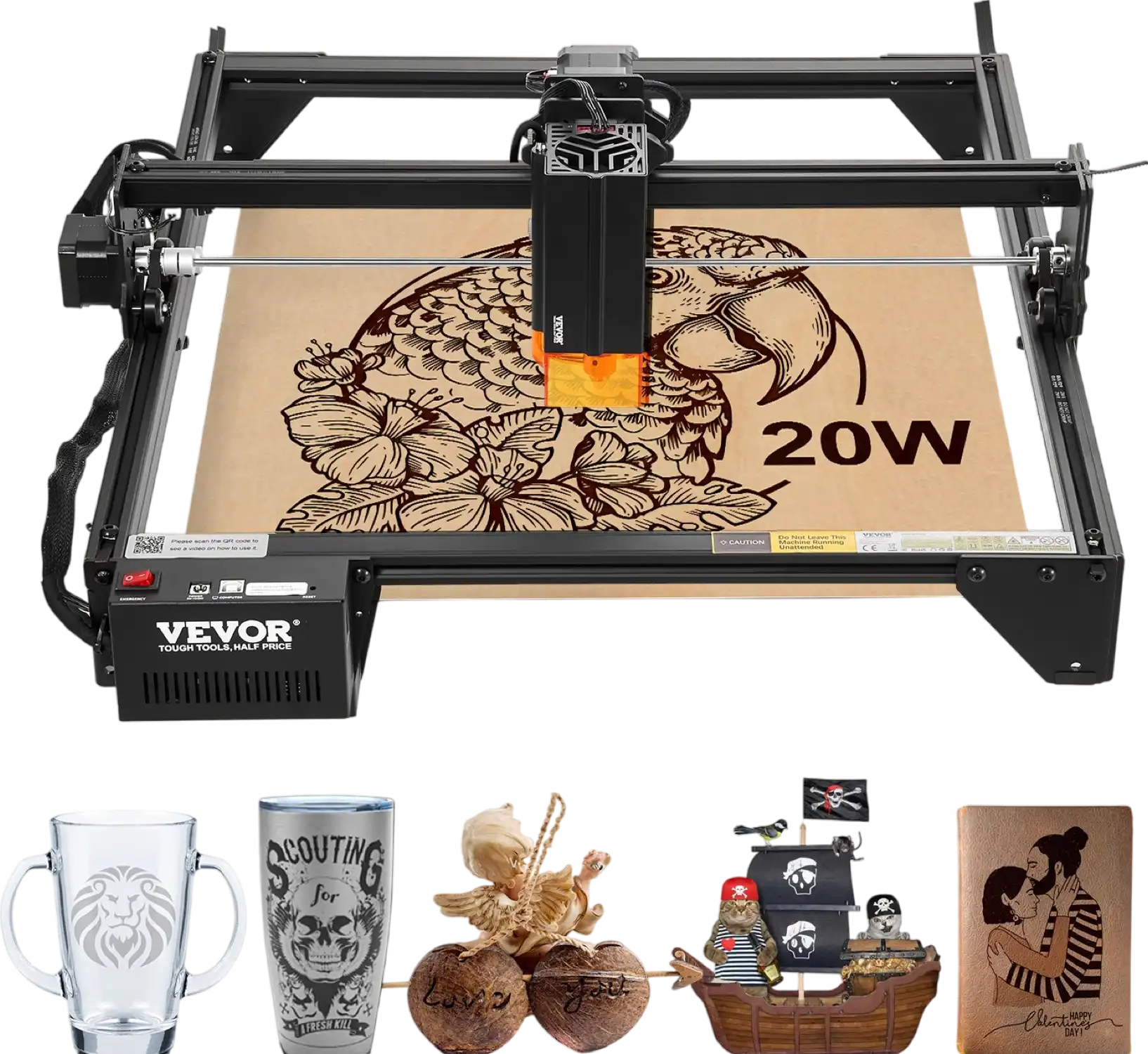

New User Vevor G3 20watt Co2 - low power and doesn't carve
The Laser is always at low power and I cant figure it out
Have you confirmed that your focus is set to be correct?
Vevor G3 20watt Co2
I can’t find this one.. Do you have a link to it?
:grinning_cat:
The focus is set with an 8mm plate and it is set.
