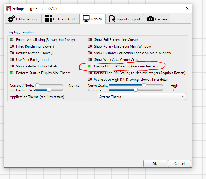

Hello good day to all, just installed version 2.1 in my laptop and we I run it my screen was almost imposible to read so I re intalled version 2.0.05. To my suprise al menu options remain very hard to read (very small letter) can you help me on how to repair this? thank you

I had the same issue and fixed it as a workaround for now by toggling the option I’ve highlighted on image here (Menu - Edit\>Settings\>Display)
