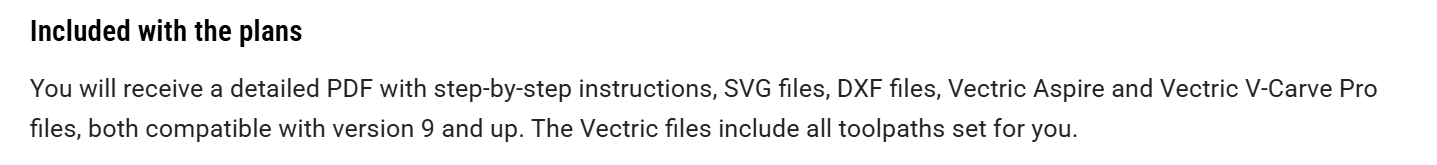

From that ToolsToday link it looks like you get both Vectric files and vector (design) files for those projects:
For MillMage, you will want to import the .svg/.dxf files into MillMage, then program the cuts along those paths as desired.
