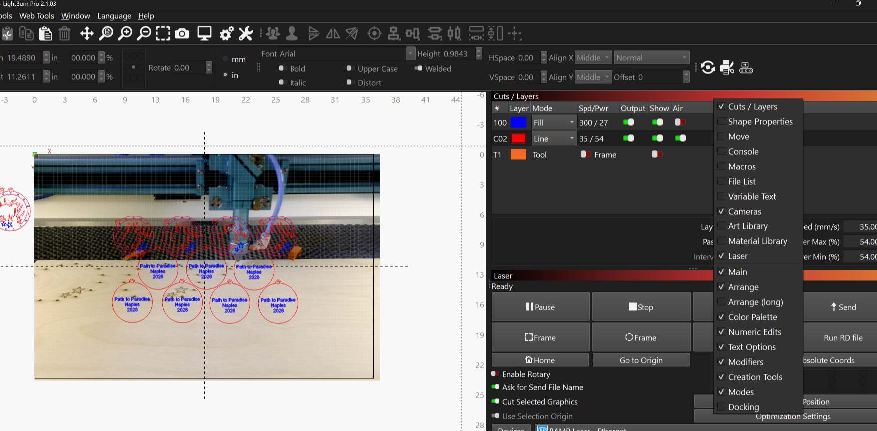

Although my camera is configured, working and selected in the Windows tab, the Camera Tab does not show in the right-side docking windows. What am I missing?
Perhaps enabling the Camera Control window:
If you look at my screen shot you would see that “Cameras” is selected in the “Window” tab. I even reset the docking windows to default, restarted Lightburn and made sure that “Cameras” was selected again. None of that helped to get the “Camera” tab to reappear into the docking windows on the right side of Lightburn.

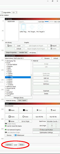

The screenshot is missing a slice along the bottom edge. The Camera window could be a tab lined up along the bottom of the other windows, thusly:
If so, click on the Camera tab it to make it appear.
Automatic docking as a tab seems to happen by default when the number of windows × their minimum size exceeds the number of vertical pixels on the display, so there’s nowhere to put the new window except in the same space as previous one.
Thank you, you solved my issue. The Camera tab was hidden out of sight at the bottom of the screen. All is better now.
