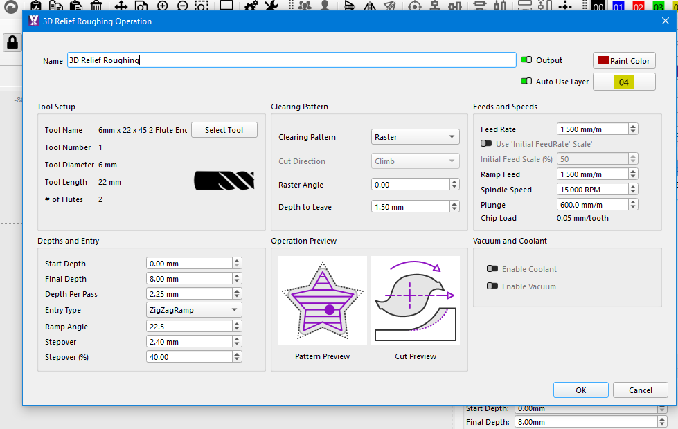

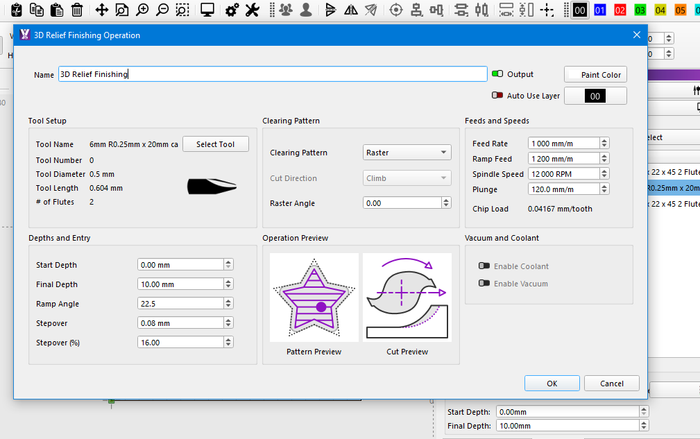

Hi, I am having trouble understanding 3d relief finishing as I can’t control how much is carved at a time after doing the 3d relief roughing pass with 6mm bit. The Rouging is going from start depth of 1mm to 12mm finish depth, then I was thinking of doing 1mm to 14mm finishing which is 2mm greater depth but I am only using a 1mm tapered ball nose. I would like to do this in 3 passes but there is no setting for this to do. Or is there an auto depth setting for the finishing pass?

No, you appear to have the correct operations, and in the correct order. However, it is your settings that need to be reviewed. For example, In the 3D Relief Finishing operation you have a Final Depth of 14.00mm. However the documentation clearly shows that field should contain a percentage.
I recommend you review the documentation step by step and make no assumptions about what a field should contain. In other words, do not skip over any of the information. If something is confusing, come back and post your questions.

It does say a measurement as well so I set that at 14mm as that is the depth I want to finish at in the 17mm material and I don’t want to cut right through. I tried the % and measurement but relief finishing dives down to the final depth (82% or 14mm) and not carve at 1 or 2mm layers as that is how I did it in Carveco. The bit has 1mm depth per cut in the bit settings so I presumed that MM would calculate that as the depth per carve down to the finished depth
The Final Depth field can accept values with units of measure or as percentages. Setting the Final Depth to 100% will cut to/through the current stock dimensions Thickness value set in Project Setup.
The Start Depth and Final Depth settings combined control the thickness of your 3D relief carving. Subtract the Final Depth from the Start Depth to determine the 3D relief carving thickness.

I feel there should be a depth per pass option for the 3d relief finishing path so we can control how much to take off for finishing bit
You can make a roughing to 12 mm after a finish to 13mm then a finish to 14mm. 3 Ops.
Thats what I had to do but I would have thought it would be way simpler to have this done in one operation like the roughing pass

1 X roughing operation going by your settings , 8 passes at 1.5mm = 12mm

by setting your 3D Relief Finishing operation final depth to 14mm, your actual cutting depth for this operation is 3.5mm not 1.5mm,
