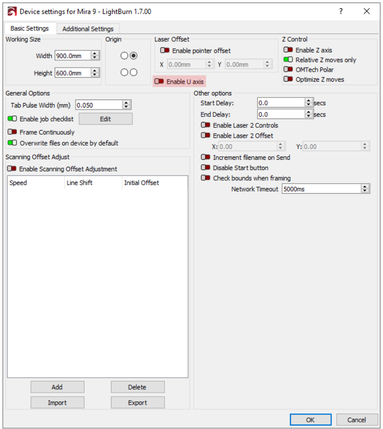

No Z-Axis movement when sending a job to Ruida Laser
Z axis enabled
Relative moves enabled
Optimize Z moves enabled.
Z axis moves up and down correctly when using the move panel.
However the Z axis position information is not updated correctly after move.
Job is sent to the Ruida controller, the machine never moves the z axis.
However the Z axis position information is updated to the position is should be if the job actually ran correct.
I’ve looked through hundreds of posts and haven’t found a working solution.

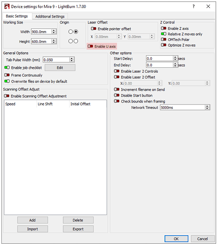

Depending on a number of imponderable factors, including which Ruida controller you have, the controller may be using the U axis instead of Z, in which case turning on the Enable U axis moves switch could help:
Heck, the whole U/Z axis thing is so imponderable you may as well flip the switch just to see what happens … :grin:

Don’t have the enable u option. So no luck there.
Like I said: imponderable.

I don’t have a Z option …
