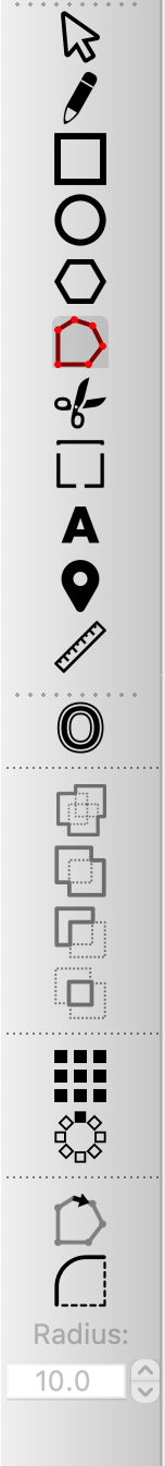

Make sure you’re hitting the real Edit Nodes tool icon, not the distressingly similar Primary Shapes hexagon icon right next to it:

OK. I see my error. I was trying to use the icon 2nd from the bottom, just below the separator, not the true node edit tool sixth down from the top.

The tiny arrow in that icon suggests you’re picking the starting point for the shape, but until you know that, they’re all pretty much indistinguishable:
