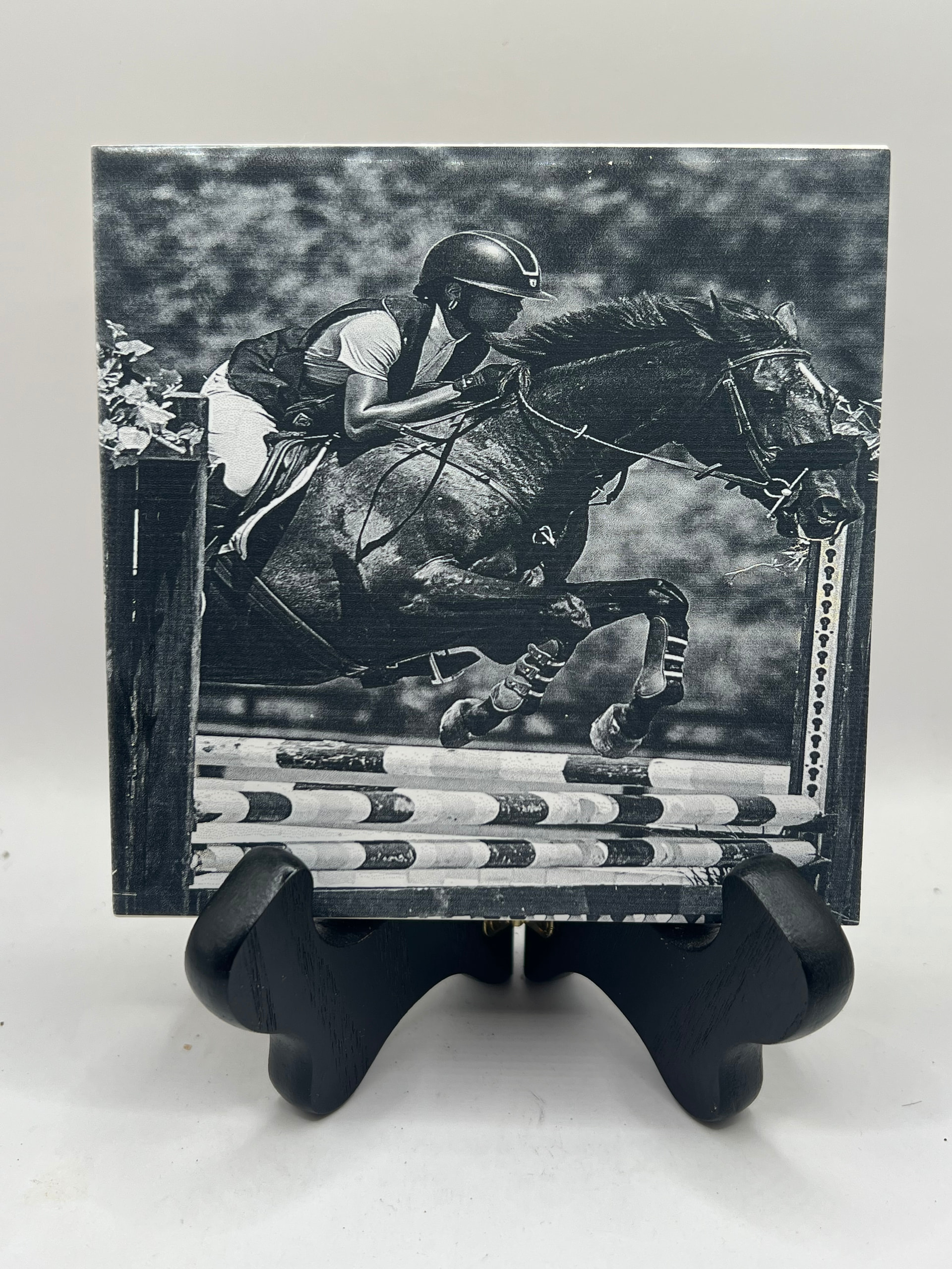

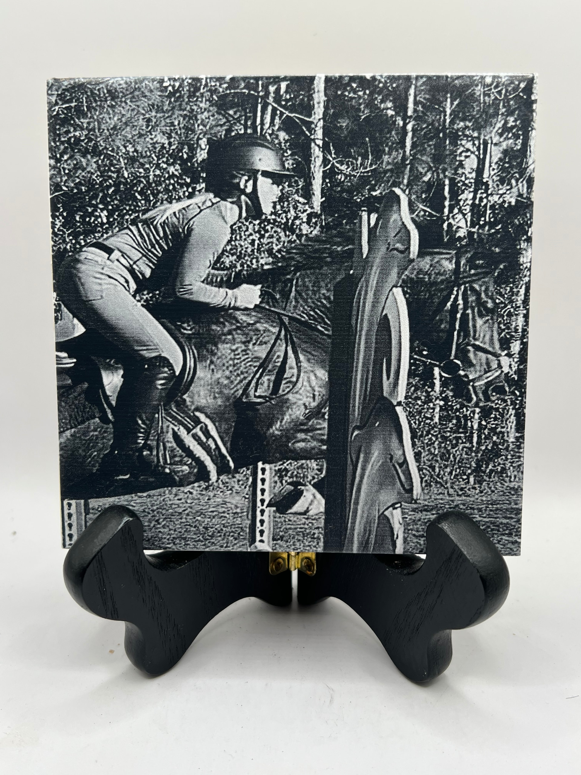

Just thought I’d post a few tiles I did using the Norton white method. I think they came out pretty good, it really does help that the photos were pretty good quality, anyway I think I’m getting the hang of it. FoxAlien Reizer 5.5w output laser, 40in speed 35% power used heirloom white spray paint cause I ran out of plain white
