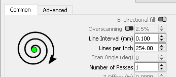

Not able to get Bi-directional Icon to enter
I currently get this only. I’m new to LightBurn so I’m sure this is user error. But any help would be appreciated. Thanks-Johnny
It’s going in a circle, how is it supposed to be bi-directional with a circular fill?
Not sure how it got to a circular fill. Is there an icon to select this option?
Thanks, Johnny
In the layer, you have it set for ‘offset fill’…
Ok, I’ve learned something new. I was under the impression that I needed to select the Bi-directional. Did not know that it would change with Offset fill. I do now though. Thanks
