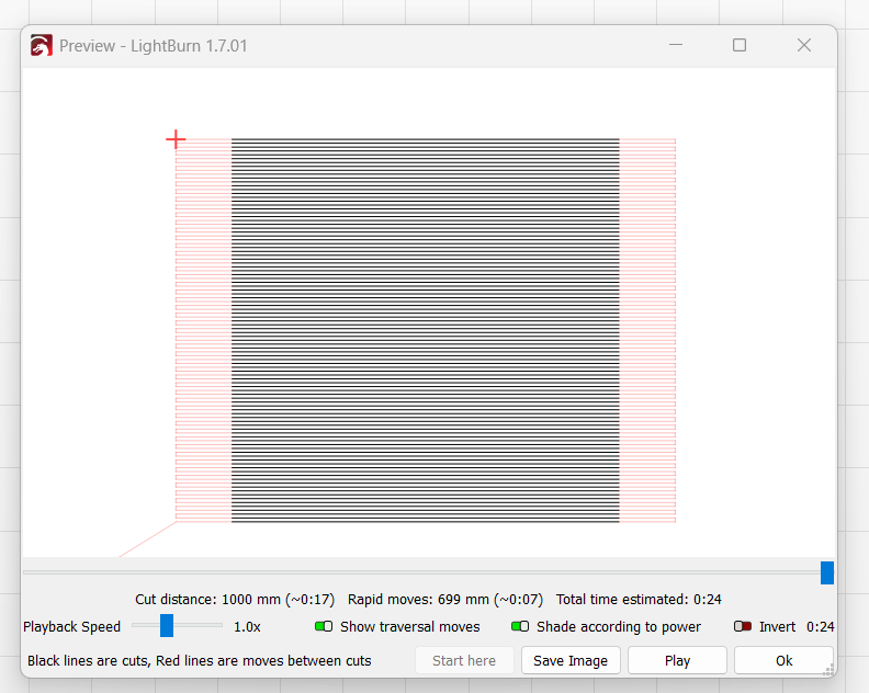

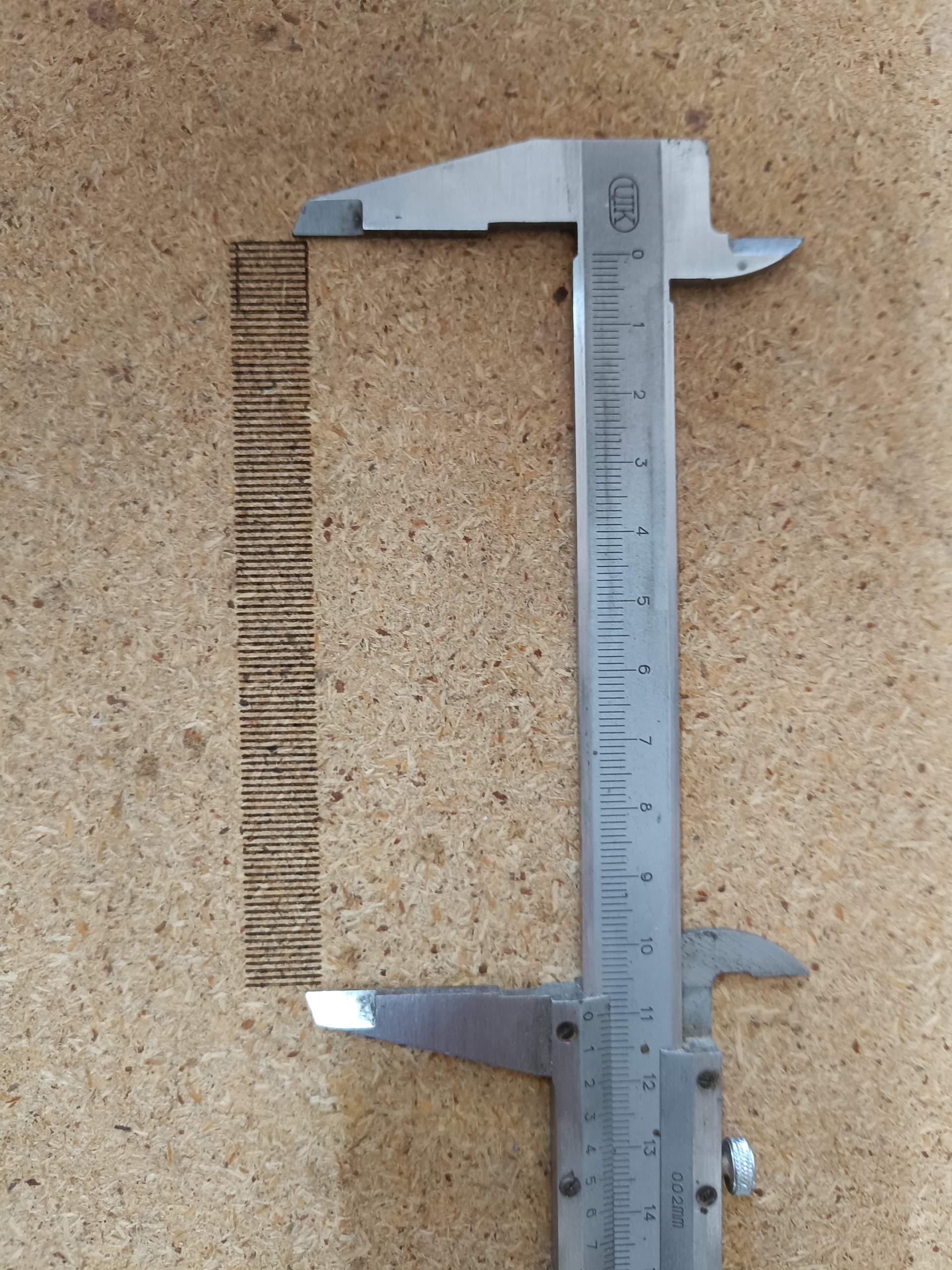

First of all, it is a GRBL diode laser, when I let it engrave lines, everything is fine, it engraves normally, but when I let it engrave a fill or an image, then along the y axis it makes distances between the lines. For example, the square is 10 by 10 mm, when it is a line it is accurate and precise, but when it engraves along the x axis it is good but along the y axis together with the distances made it is 110 mm.

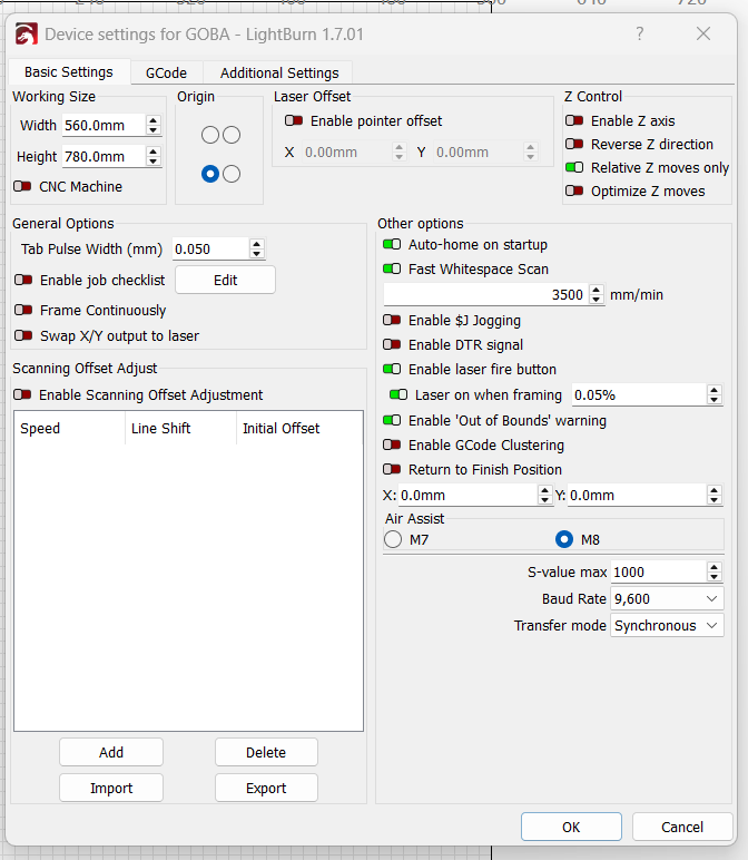

Also, when I move to empty on the x axis, the y axis also moves.
So, you’re saying both images are the same 10mm square, just one line and one fill?
Is this a new machine? Has it ever worked properly? What does the preview window show for the filled square?
If the Y axis calibration was off it could give these results, but that would affect line mode as well as Fill. This isn’t making sense.

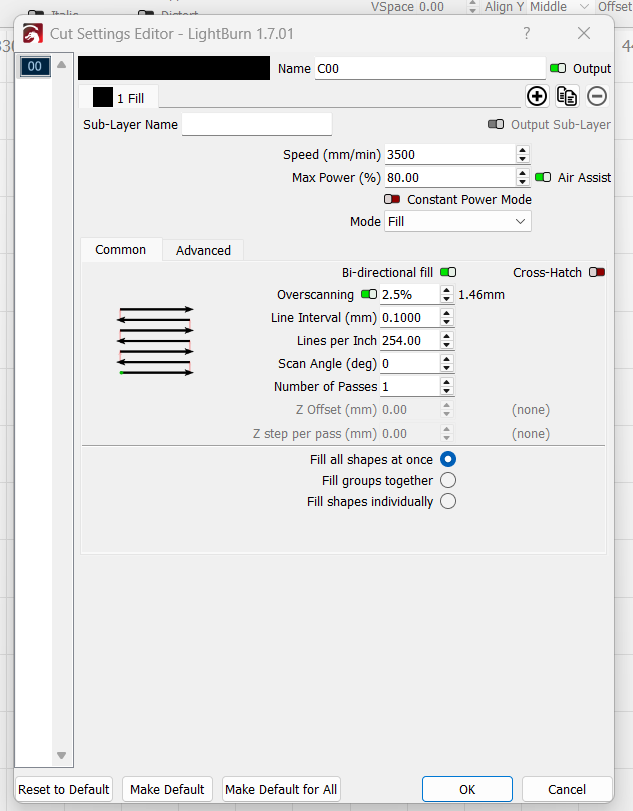

Post a screenshot(not phone pic) of your Cut settings editor with this layer loaded in fill mode, also the preview window.

Things aren’t adding up here. Your cut settings that you posted first show a 90* scan angle and a line interval of 1.000. Now you show a 0* scan angle and 0.100 scan angle. Which settings did you use when you got the weird results?
both, but same result…
line interval is 0.100, i tried different, but the resultat was same
A 90* scan angle will producedifferent results than 0*, and a scan interval of 1.0 will be quite different from 0.1. Try running your fill again at 0* & 0.100. Run it on scrap so you don’t waste good material. Frame the output before running and see if that looks correct. Then next to it run it again at 90* scan angle for comparison. Post the results.
