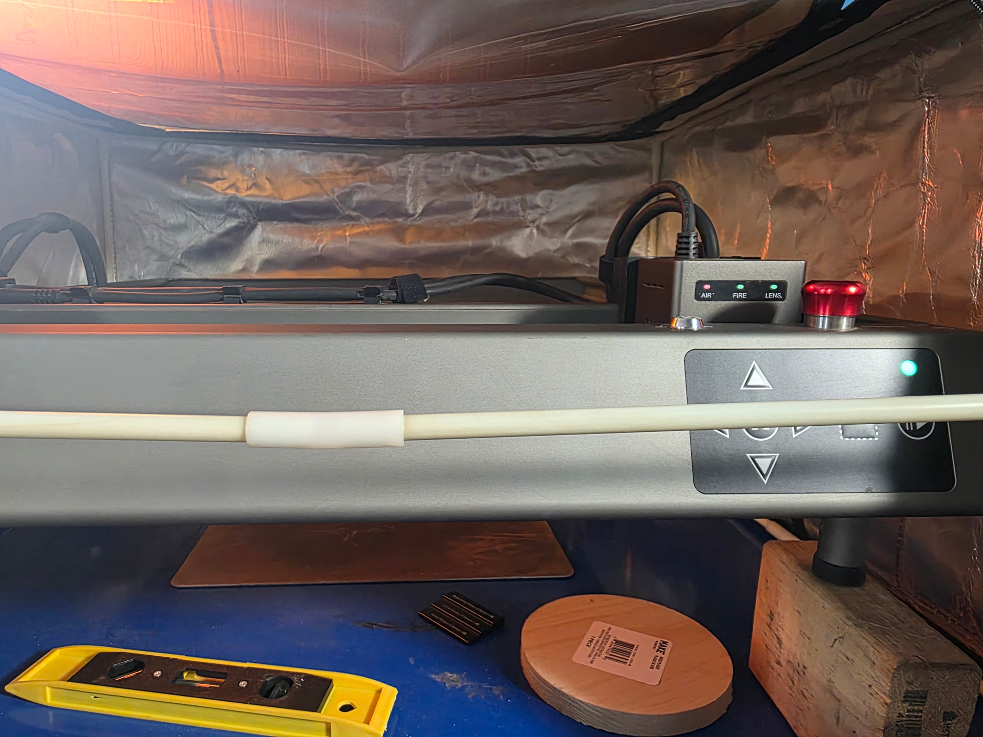

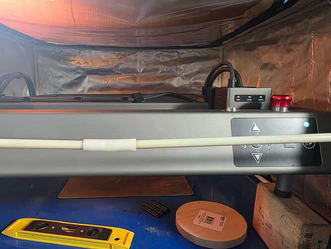

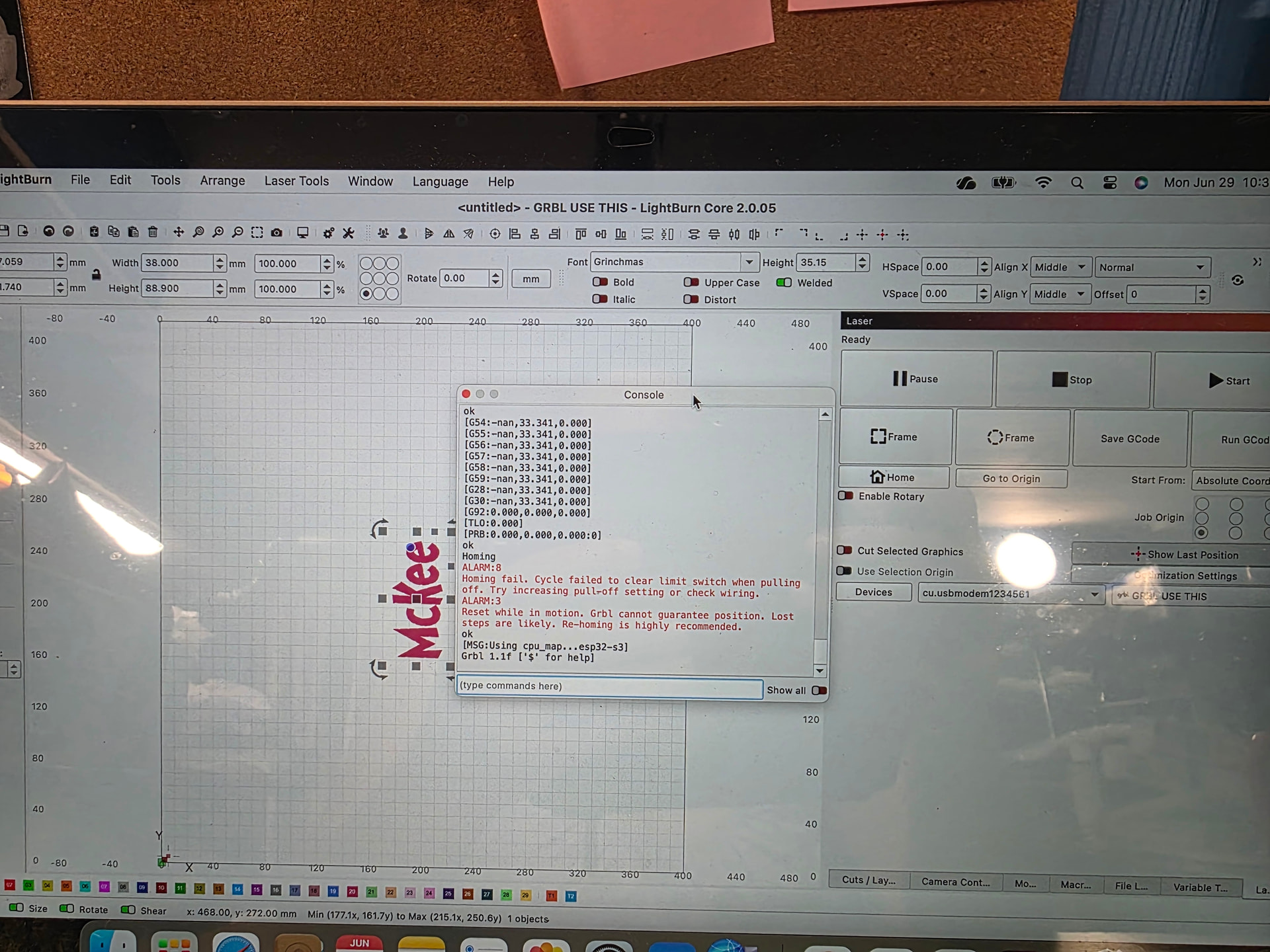

Good day, I took pictures of settings and where laser ends up.

Turn machine off and move laser to center. Turn on machine and home. Does laser move toward limit switches? Does laser hit a rail? Looks like it’s going to front right corner. Not usual for homing position. Is that where switches are located?

I have it set to front left … i do set laser to middle when homing it only moves forward wont go to the left. Sorry in the pic i didn’t move to centre it was to the right, so laser ended up front right corner.

> [@ball](#):
You started with **Alarm 9** , meaning a switch did not close when it approached the switch.
Your image shows **Alarm 8** , which means it found the switches, but one failed to open when pulling off.
To ensure you see the Home cycle in the proper sequence, please read the text below. Then do a Home cycle and let us know where your machine differs from the text.
**HOME**
1. Trolley and gantry rapid move towards the switches.
2. When the switches are hit, the machine will stop and reverse. First Zaxis must complete if installed, then X and Y. It may not reverse X or Y until both switches are found for X and Y.
3. The machine will pull off the switches slowly until the switches open.
4. The machine will reverse back onto the switches very slowly until the switches close.
5. The machine will reverse and pull off the switches slowly until they open.
6. The controller establishes this as the Home (and Origin) position. It is usually shown as something very close to 0,0 as the position if the controller is set for the first quadrant. If it shows large numbers, this can be changed with the G10 command or the CNC Mode switch.
_There is no other version of the_ **Home** _cycle_. If you have limit switches, this is how it should work.
If you do not have limit switches, where it powers up is the **Origin**. Home is a machine mechanical function. Origin is a software design position. They are not the same thing.

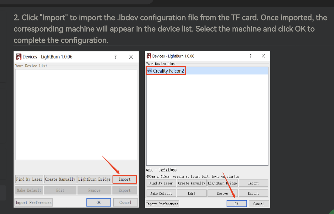

In your manufacturer’s tutorial, they reference a .lbdev file that you can import into LightBurn’s device window.
Are you using your laser manufacturer’s recommended settings from the TF card?
> **[LightBurn Software Compatibility Machine Tutorial](https://wiki.creality.com/en/laser-engraver/creality-falcon2-series-troubleshooting/lightburn-software-compatibility-machine-tutorial)**
 ![Screenshot 2026-07-02 at 10.59.54 AM](https://forum.lightburnsoftware.com/uploads/default/original/3X/7/d/7de63348923a80e95771362c89a4c1ecb7cf190c.png)
