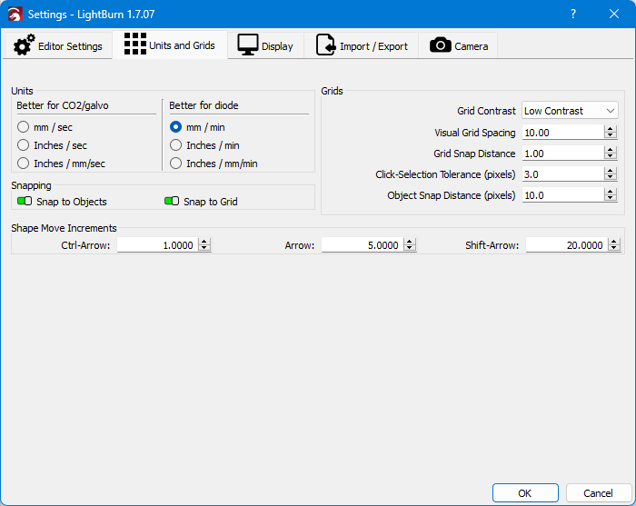

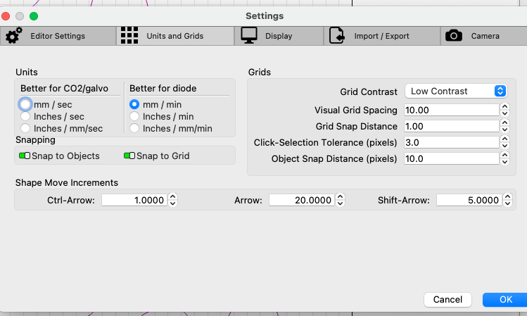

You are very likely trying to engrave at too high a speed for your laser. A common error is having Lightburn set to mm/sec, where it should be set to mm/min. mm/sec is 60 x faster than mm/min and your laser is not capable of engraving at those speeds. Go to the Settings menu (Gears icon) and change to mm/min then try your test again starting at roughly 3,000 mm/min and 75% power.
NO, the settings were as you suggested. I have just noticed that I get an error in the transcript window

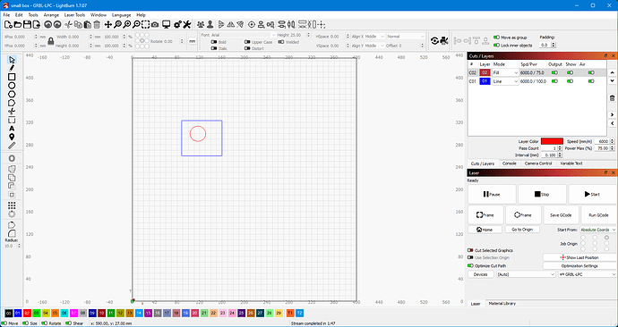

Also, Please post a screenshot (not a cell phone pic) of your entire Lightburn screen with your project loaded and the Cuts/Layers Panel and Laser Panel visible. Also post a screenshot of the Settings Window (Gears icon) with the Units and Grids tab visible and post a screenshot of the Device Settings Window (Wrench and Screwdriver icon). https://www.take-a-screenshot.org/

Well here is best I can do - I am usually on a Mac so Windows is a strange world.

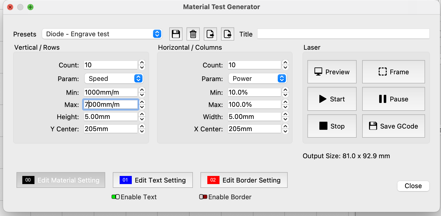

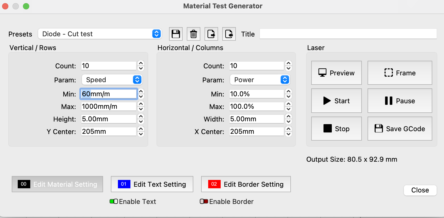

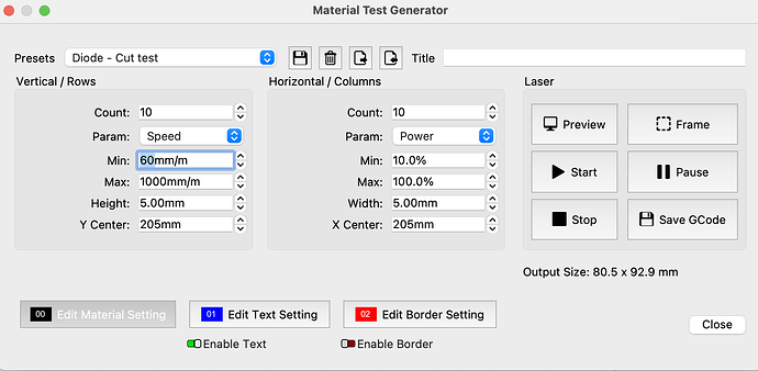

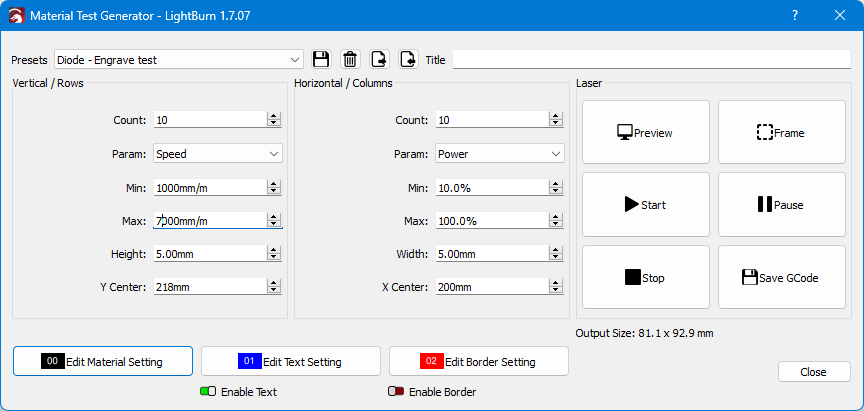

Since we have no idea what speeds the laser was running with the preloaded files, run a couple test grids. You should get some kind of output. Lightburn has presets for diode laser. Load those and change the speed for engrave to 1,000 & 7,000 and Cut to 60 to 1,000. Run both the engrave and cut tests and post your results. 6,000 mm/min may still be a little fast.

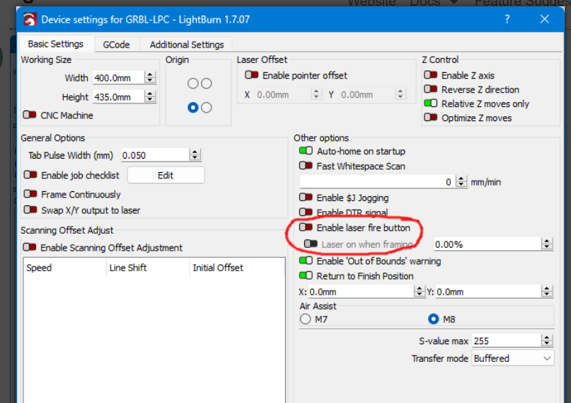

Been a while since I’ve grbl’ed, but doesn’t the laser have to be enabled?
I enabled that. I then setup the engrave test using the parameters suggested
then got this result
None of the text appeared!

The darker line on the left of the test patches may be indicating that overscan isn’t selected in LightBurn. It also suggests that the difference between the travel speed and the engrave speed may be a little high or there may be another issue with the motion controller.

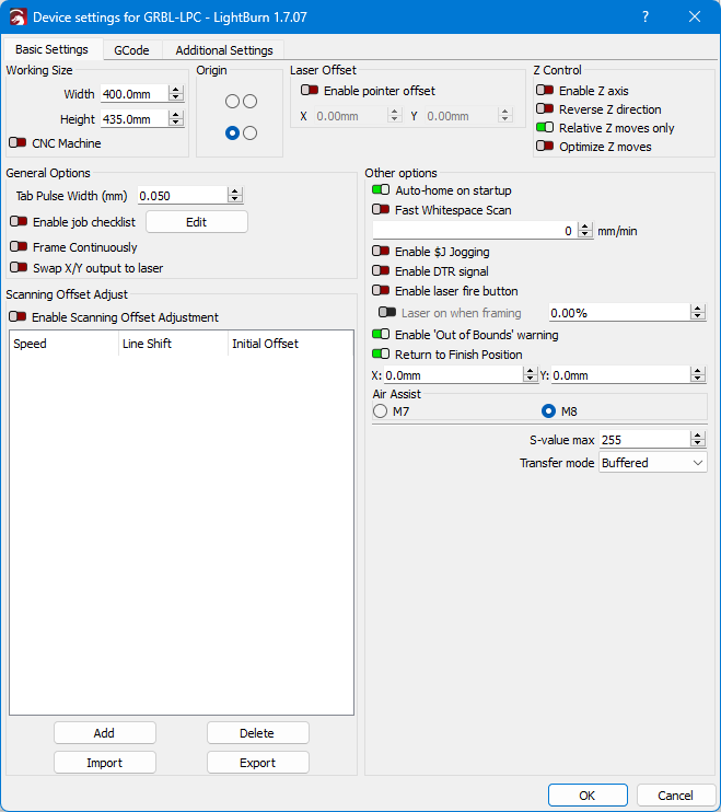

The most useful data is probably the Machine Settings, particularly $30=1000.000
In LightBurn, open Device Settings (under Edit) and confirm that the value assigned to ‘S-value max’ is 1000.
Device Settings is also available by clicking the Wrench & Screwdriver icon in the middle of the toolbar.
Edit S-value max if it doesn’t match the value for $30. When finished, click OK at the bottom of that pop up window to ensure the setting in LightBurn is changed.

Change the s-max value in the machine preferences window to 1000. This is the reason it doesn’t burn.
