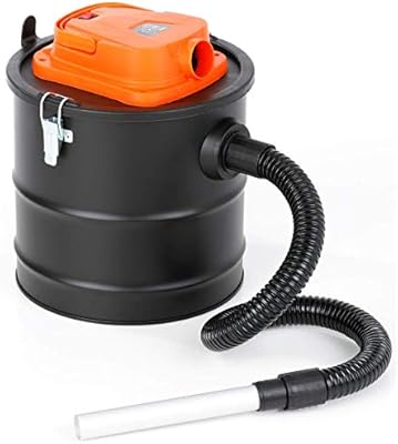

Silly question but could this be used as an airblower if tubing allowed for the air to be blown into a normal air assist type tube end.
It blows air (it also sucks but it has a blow option only)
I ask as I have one of these for dust extraction (used with the ash hoover in suck mode) but would it work as an air assist in ‘blow mode’.
… it will make a lot of noise but I’m sure it will work. But make sure it does not get too hot, they are not intended for hours of operation.
