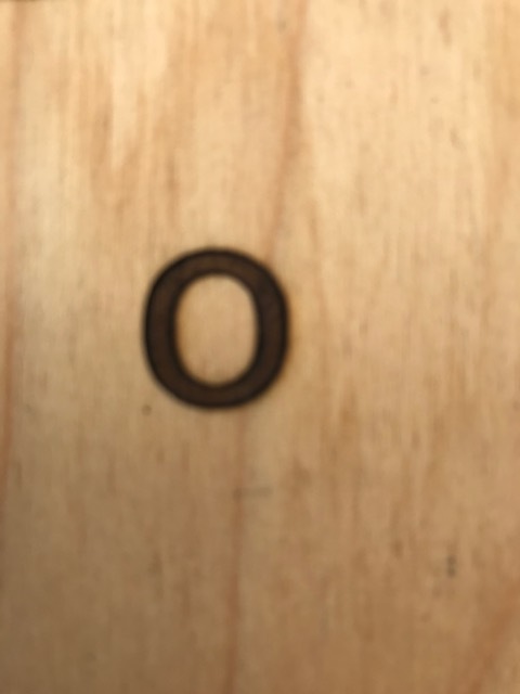

I’m trying to get ‘Filled vectors’ working in Lightburn with Mach4 using GRBL-3 post processor.
The image preview of a simple letter ‘O’ looks good in lightburn and the output gcode is generated…
However on opening the Gcode in Mach4 the screen shows a solid full ‘O’
Can anyone hep please.
Have you tried running the gcode?
Fills in LightBurn are all G1 moves, with only the power value varied, so that the speed is consistent. Constantly switching between rapid moves and feed moves (G0 and G1) would make the preview look better, but can cause wobble in the output.
Hi Oz, yes the Gcode runs fine, however instead of a donut I get a filled letter O. Heres the first bit of my code:-

Those lines are alternating between S0 and S114.8. S0 is “laser power to zero”, and S114.8 is “laser power to 45% (114.8 out of 255)”
It looks like whatever script you’re using to inject the extras is ignoring those.

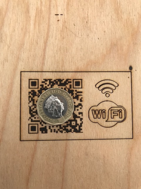

Looks like we got there at last.
Mach4 and Lightburn GRBL3 Gcode.
After a bit of changes to the GRBL3 Gcode produced by Lightburn I finally achieved the results shown.
GRBL sends ‘S’ to to turn laser on and of.
Any ‘S’ followed by a number’ I.e S57 means turn laser on at 57%. This simply needs replacing with M62P20
An ‘S’ number followed by a 0 means lase off. And needs replacing with M63P20
When you wish to create filled text like the letter ‘O’ shown be sure to tell Lightburn that your text is ‘Line and fill’
Here is a small part of the code I used.
; LightBurn 0.9.16 George’s WIFICARD

I hope this is of some help to others.
George
