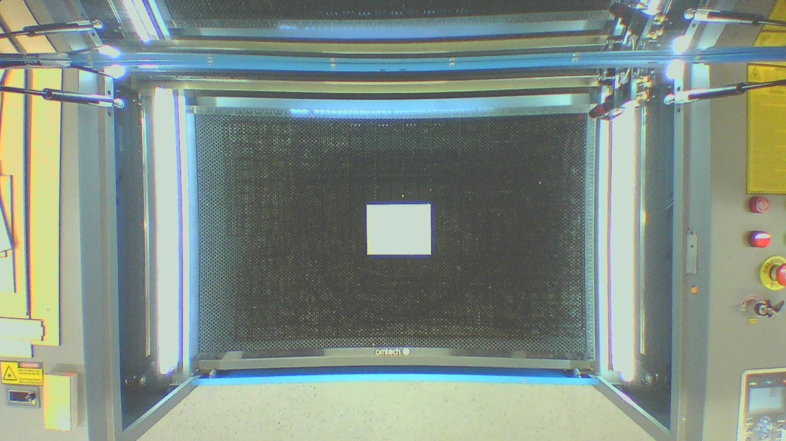

Recently set up a camera on my machine (OMTech USB1006 with a 20"x40" bed size) and am getting a blue glow on materials i put on the bed. The camera is mounted on the open door to be able to capture the full bed size and comes in mostly clear. I see a slight blue halo in this image from the camera app.
 ![Screenshot 2026-09-11 110111](https://forum.lightburnsoftware.com/uploads/default/original/3X/9/5/959fdaeafed1bb40339c49cd324bd2599d33ada7.jpeg)

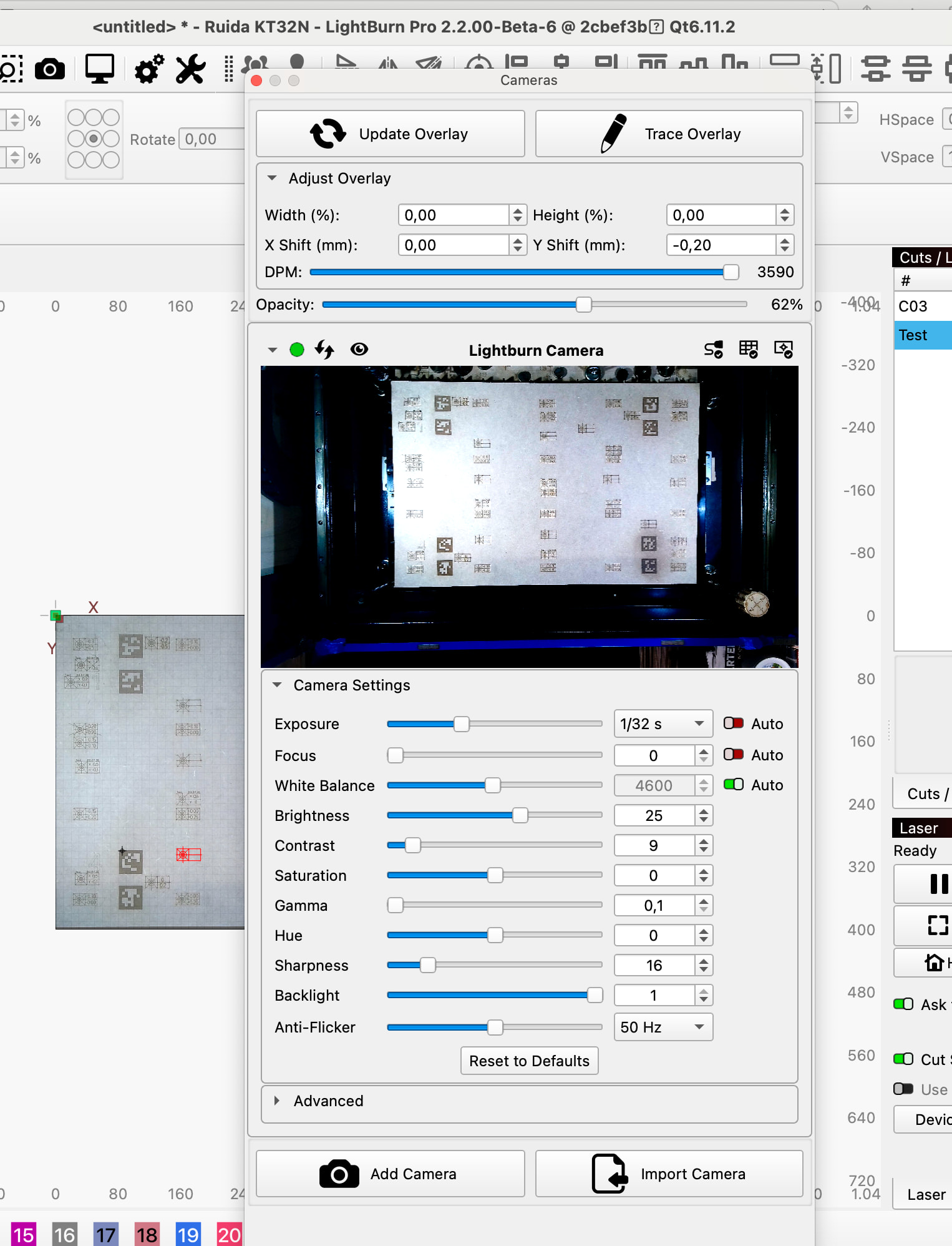

Here is the image from the camera utility with the settings:
 ![Screenshot 2026-09-11 110249](https://forum.lightburnsoftware.com/uploads/default/original/3X/4/9/49e52f12b7be15ad7bfe0ba92a264c4b492619c3.jpeg)
The blue glow/halo is much more pronounced. How can I correct this? Between this and the low resolution, it throws off my alignment some.

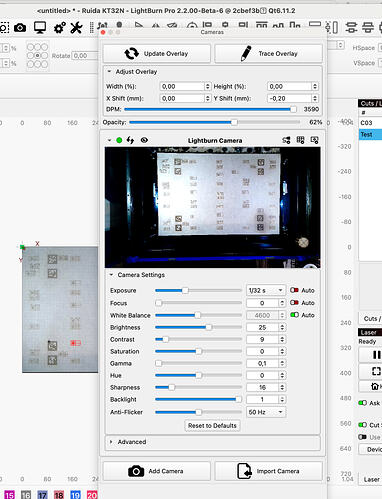

If you have the same ability as me to manipulate the settings, it’s probably “saturation” that needs to be adjusted / set to 0.

Alas, I do not have Saturation on my list of options in that panel.

> [@travisstdenis](#):
Me neither, but my USB camera was $12 so I am not disappointed.

Before LightBurn introduced adjustment options for their cameras also for MacOS users, I used an external program/app for it - “Webcam Settings 2.3”. It worked very well. I’m sure there are similar apps for Windows if Windows’ own built-in app for that doesn’t work satisfactorily.
If your image has been ok before and your camera is not broken, then it can also be set back to “normal”.
