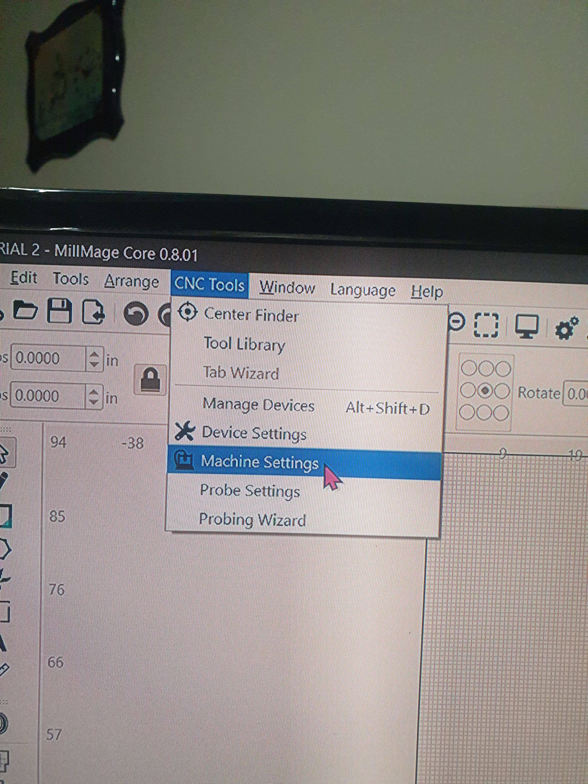

In the Console Window, please enter
$130=400
and also
$131=400
Which will update the max travel for each axis, should fix your problem.

Changed that over, now showing below - Interestingly, the promp came back, I accepted the change, but it didn’t change anything in the $ code. weird.
Had a play about but alas, still showing as -380 max travel on the machine positioning when using jog, it will not go past -379, pressed home and its now 397 - extract of $$code below

Checked the Worksize in the Device Settings tab, and that had been changed back to 380mmx380mm ( I now assume this is what the prompt changed)
Flicked that back to 400x400mm and the machine seems to be jogging as intended!
Hurray.
