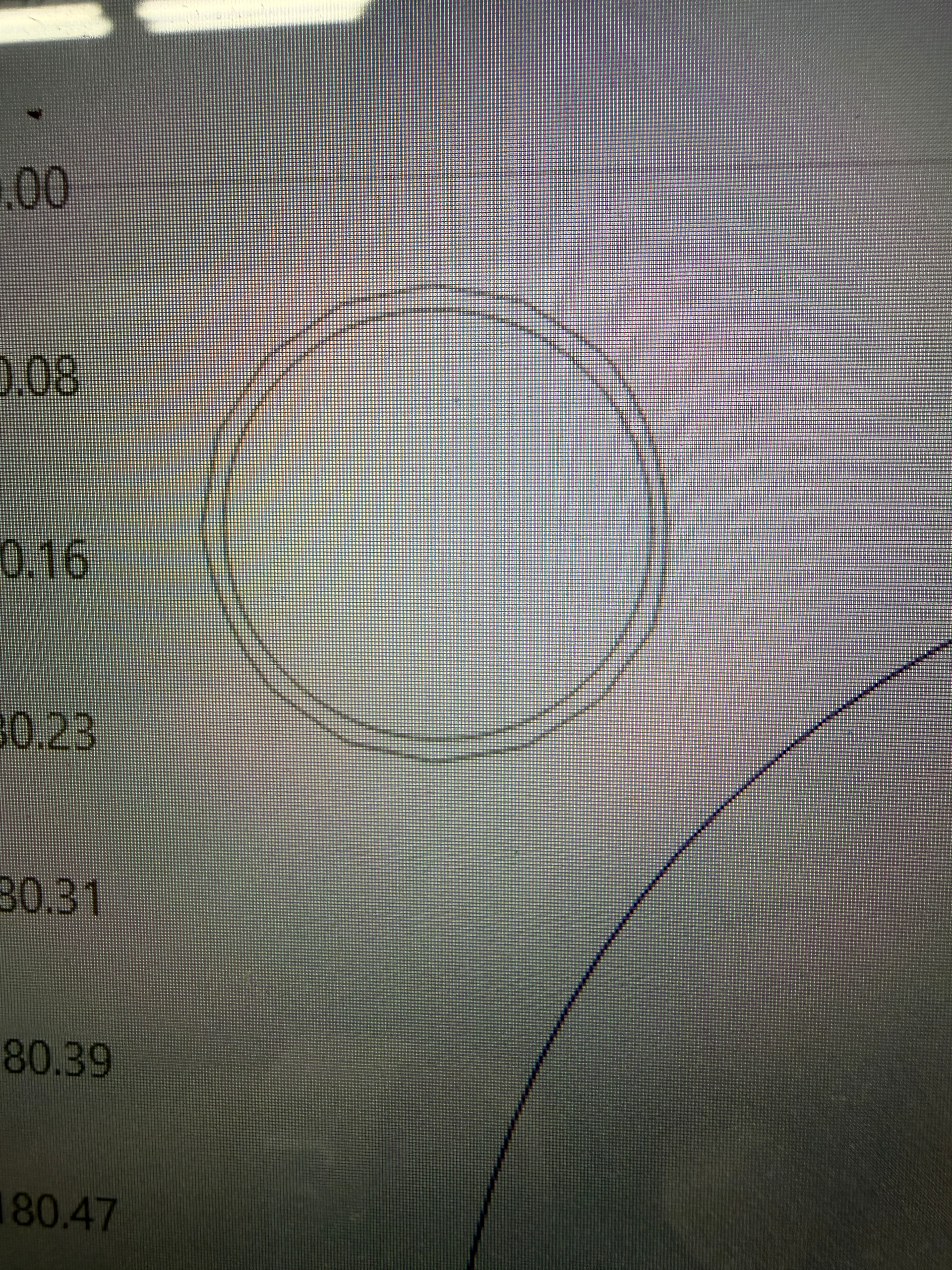

After the latest software update, I am noticing my offset is not working correctly. I have a circle selected and then chose offset. I have outward selected, round selected, and optimize selected
 ![IMG_9037](https://forum.lightburnsoftware.com/uploads/default/original/3X/d/a/da0c4ceeaa302cd3bde26ed9c56dd795734870a1.jpeg)
. Am I missing something?

> [@LHankins94](#):
> a circle selected
The numbers along the Y axis suggest that is an _extremely_ small circle, so you may be seeing the effect of a `Low` setting for `Curve Quality` in [`Settings → Display Settings`](https://docs.lightburnsoftware.com/2.1/Reference/SettingsPreferences/?h=quality#display):
> **[Curve Quality - Settings/Preferences - LightBurn User Guide](https://docs.lightburnsoftware.com/2.1/Reference/SettingsPreferences/?h=quality#curve-quality)**
> The Settings window contains global user preferences for LightBurn — these settings apply regardless of what lasers you have set up, and which one you currently have selected.
Crank that up and see if the picture improves …

Thanks. It doesn’t seem to matter how large the circle is. It’s just strange that I have never had this issue before on the small circles. It is for an earring, so the circle is small.

I have increased it to perfect, without change?

> [@LHankins94](#):
> without change?
Upload the `lbrn2` file and a [screenshot](https://www.take-a-screenshot.org/) of the `Settings` → `Display` tab so the hive mind can ponder the details.

Thank you so much for helping. As I was preparing to send the screen shot, I realized my measurements had been changed to mm instead of inches. When I switched it back, viola, it was all fixed. Kinda crazy, not sure how that got changed???

> [@LHankins94](#):
> [@LHankins94](#):
There was a change in how design and control units were related. Revisit the Device Settings window:
