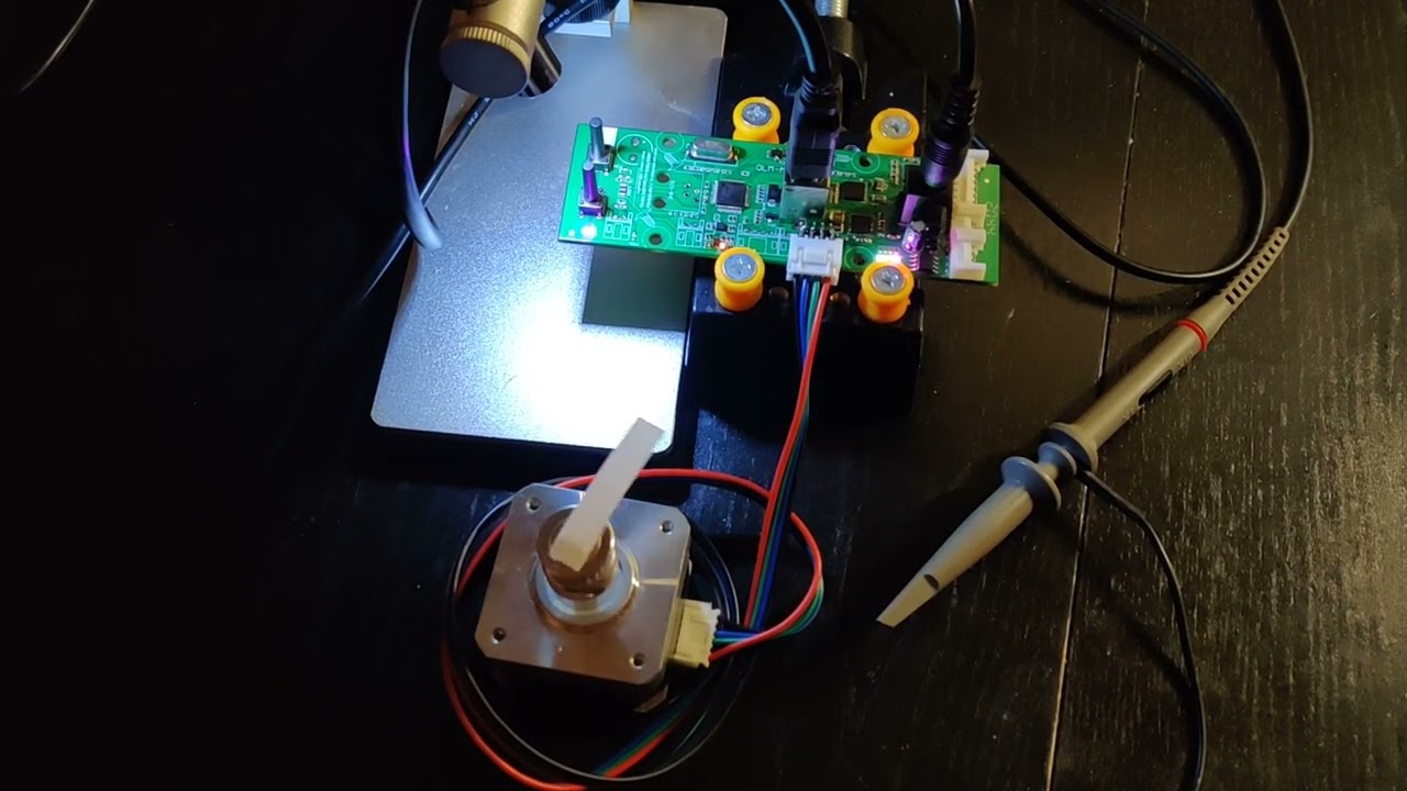

I haven’t received the HR4988 driver yet, so I wired up a TMC2209 board and I’m happy to say that it works.
That on the other hand means that even if the HR4988 (and all the other missing auxiliary components), when soldered to the main board, does not work, one could still grab the signal from the mainboard and feed it to an external driver and be able to control a stepper via the jog buttons.
This is the driver board I’m currently using:
 ![image](https://forum.lightburnsoftware.com/uploads/default/original/3X/7/7/77ef5cb16ba12a0eed52ccc82e1cbd7d49c52999.jpeg)
Here is a video on Youtube where you can see me control a stepper via the unpopulated pads on the Laser Master 2 mainboard from LaserGRBL:
[Video on Youtube](https://youtu.be/7KUjvl8RZng)

Excellent progress. The clicking sound in the video, is that from a button press or that’s coming from the stepper? Overall, the driver seems to be driving the motor more quietly than the factory part.
<div class="post-metadata">
**Author:** ![DanielS](https://forum.lightburnsoftware.com/user_avatar/forum.lightburnsoftware.com/daniels/32/36160_2.png) [@DanielS](https://forum.lightburnsoftware.com/u/DanielS)\
**Post date:** [January 6, 2022, 3:31pm UTC](https://forum.lightburnsoftware.com/t/olm2-adding-z-axis-stepper-driver-to-mainbaord/55869/12 "2022-01-06T15:31:44Z")
</div>
Oh, that’s just me clicking the Z jog buttons 🙂 . The TMC2209 runs in StealthChop mode so it’s significantly quieter than the HR4988. I should get the HR4988 in a few days and then I’ll compare the two.

> [@DanielS](#):
> all other steppers lock up to hold position
Hmm… You’d think it could support at least 1 additional stepper since that’s normal, especially without a laser drawing current. Curious if there’s something else potentially going on. Or maybe just your new stepper draws more current than the original ones.
> [@DanielS](#):
> I bought an adjustable mount for the laser head and the plan right now is to 3D-print a bracket for the stepper and then see how that works out.
Very cool and a nice hack.
