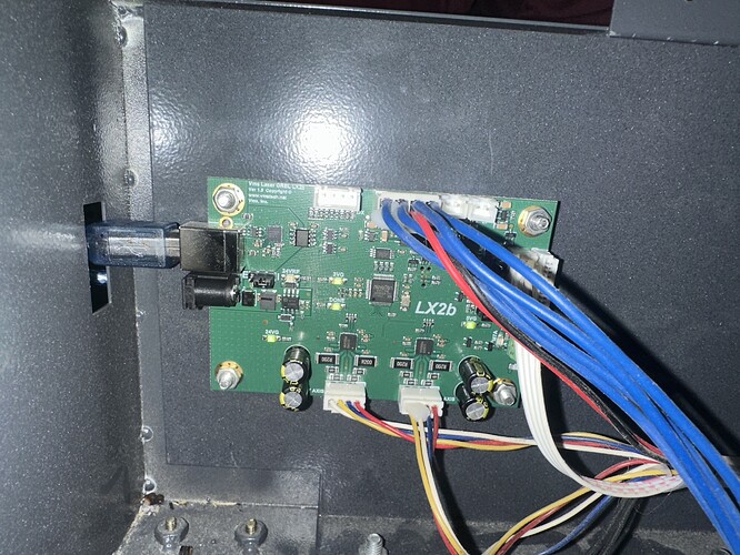

Might want to look inside and take a photo of the control board so we can see what you have.

It would also be interesting/important to know which board they have built into your machine, there are at least 5 different ones as far as I can remember. Some require specific USB drivers. Can you contact the seller and ask him about it?
Nothing out of the $$ command, the console just says “waiting to connect” over and over again. The window that you click play pause and stop says ready on one but not the other USB port. I’ll throw a picture of the board.

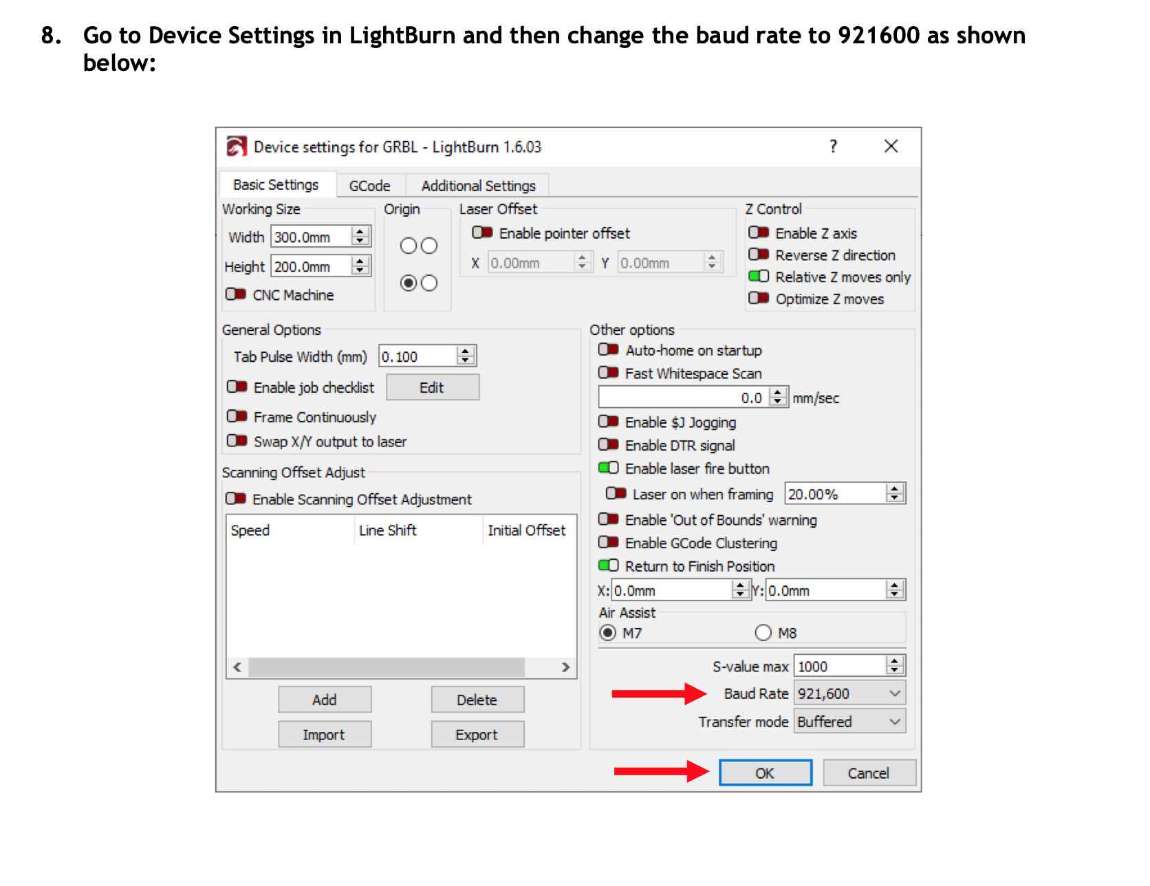

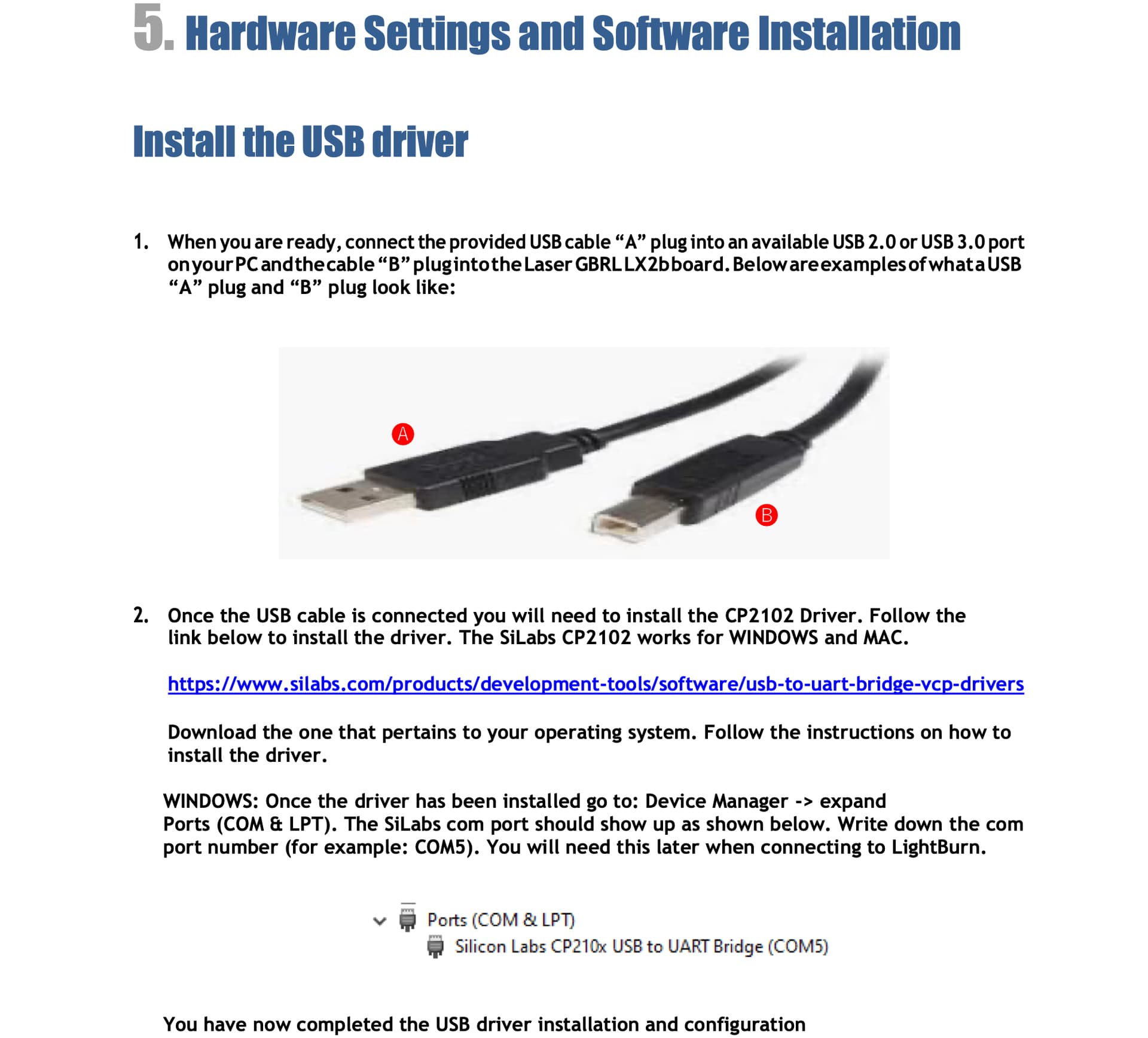

Have you checked and installed the drivers on your system and checked the settings as described in the manual?
Dude that worked!!! Thank you so much for all your help you absolutely rule
