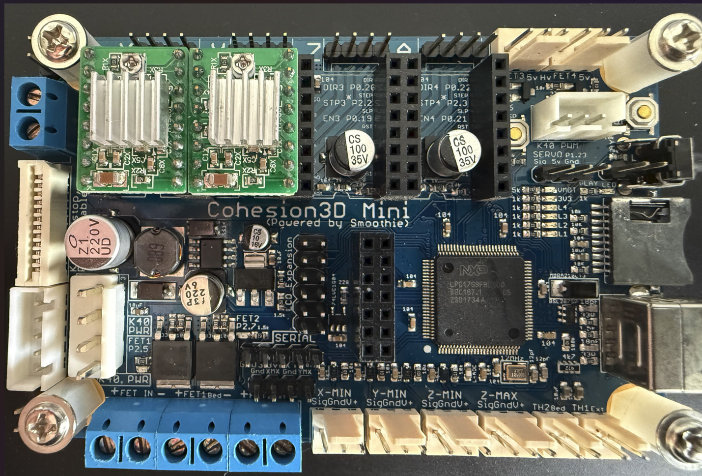

OMTech K40+ SH-G 3020 + Cohesion3D Mini: Laser won't fire under Smoothieware control (PSU: ZYE MYJG50W)
Software: LightBurn, device profile set to Smoothieware. Controller: Cohesion3D Mini, converted from the stock OMTech GD32F303-based mainboard. Machine: OMTech K40+ SH-G 3020. PSU: ZYE Laser MYJG50W (AC 110V/220V).
Motion (X/Y, endstops, homing) is fully working through LightBurn - this post is only about the laser refusing to fire.
What’s confirmed working
  • Cohesion3D Mini fully installed and functioning: motors, endstops (X-MIN/Y-MIN), and homing all correct.
  • PSU’s physical Test Fire button reliably fires the laser - confirmed via ammeter (17mA) - so the PSU, tube, and HV stage are healthy.
  • Cohesion3D’s P2.4 output is proven live: continuity-tested from the “K40 PWM Output” 3-pin connector back to the P2.4 MOSFET4 header, and the pin’s voltage measurably changes on command.

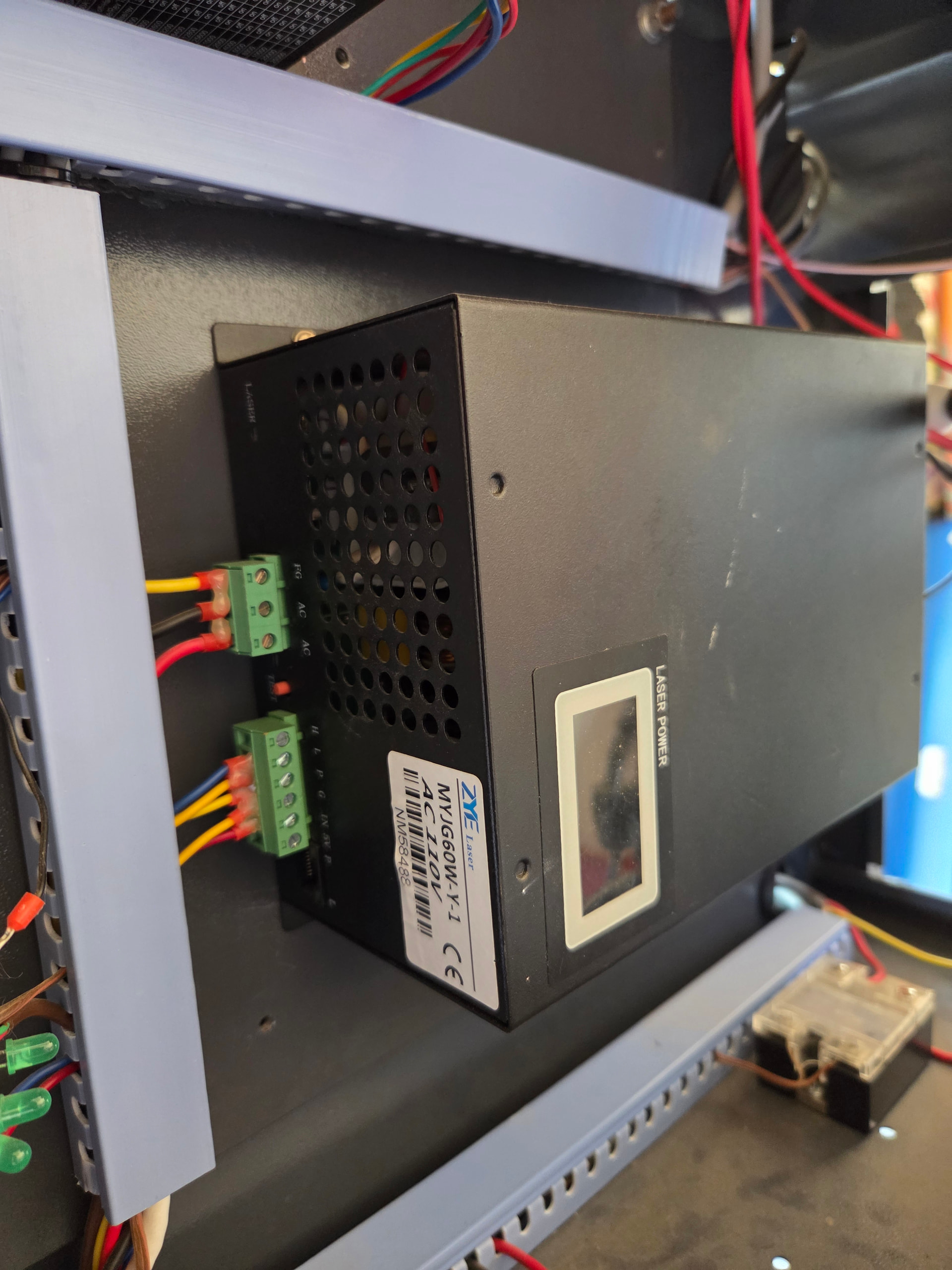

PSU terminal layout (6-pin block)
Silkscreen reads, left to right: G1 / P / L / G / IN / 5V
What’s been tried
  1. IN alone, PWM driven from Smoothieware’s laser_module (P2.4), power level set via laser_module_maximum_power 0.8. No reaction on the PSU’s “Laser Signal” panel indicator, 0.0mA.
  2. L + G, driven via Smoothieware’s switch module (M3/M5, active-low). Panel’s “Laser Signal” indicator DOES light correctly and toggles reliably with M3/M5 - but ammeter stays at 0.0mA regardless.
  3. Direct bare-wire jumper, L to G (Cohesion3D fully disconnected) - same result: Laser Signal indicator lights, but 0.0mA on the ammeter. This strongly suggests the panel’s “Laser Signal” indicator only reflects “something detected on L,” not genuine firing - it lit under every test today, including ones that produced zero current.
  4. P + G1, both via a direct bare-wire jumper and via Smoothieware - no reaction at all (not even the Laser Signal indicator).
  5. Checked the machine’s physical laser-current potentiometer, which connects to the PSU’s IN terminal via a small panel PCB (has its own chip/circuitry, not a simple 3-wire pot) over an RJ45-style cable. Confirmed:
    • RJ45 cable tests fully continuous end to end.
    • Turning the main panel dial produces no measurable voltage change on IN at the PSU end.
  6. Found a second, small red button directly on the panel PCB (near the RJ45 connector) that DOES reliably fire the laser at low but real power (confirmed via ammeter, non-zero mA). Measured IN’s voltage during this: idle 4.26V, pressed 0.68V - a real, working reference for what a “firing” IN signal looks like on this PSU.
  7. Wired a second Cohesion3D output (P2.5, via the FET1 screw terminal’s “-” position) to IN, alongside L (already working per indicator). Tried both inverted and non-inverted PWM, various S-values (S1, S0.3) - Laser Signal indicator lights, but ammeter stays at 0.0mA throughout, and IN itself reads a flat 0V regardless of S-value when measured with a basic multimeter (likely just reading the PWM average, not able to characterize the actual waveform).
Current working theory
The panel’s small button (point 6 above) proves the PSU CAN be triggered externally and produces real current at a specific IN voltage/waveform. But we haven’t been able to replicate that exact signal from Smoothieware - a basic multimeter can’t fully characterize what that panel button’s chip is actually outputting on IN (could be a specific analog level, a particular PWM frequency/duty cycle, or a short data pulse rather than simple PWM).
Questions
  • Has anyone connected a Cohesion3D Mini (or similar Smoothieware board) to this exact PSU (ZYE MYJG50W) or a similar OMTech K40+ SH-G panel/PSU combo?
  • Is there a known correct combination of pins/signals for reliable external firing on this PSU - specifically, what should Smoothieware output on IN (voltage level, PWM frequency) to replicate what the panel’s own button/chip produces?
  • Could the panel’s chip-based pot/button assembly be sending something more complex than simple PWM on IN?
Happy to provide additional photos, my Smoothieware config, or run further tests. Thanks in advance for any insight.
The laser power supply (lps) requires two control lines. The pwm is usually wired to the IN terminal. There is an L terminal, which is laser enable, it must go low to enable the lps must be held low if the you want it to lase.
This is my 60W, I don’t have a control knob. This became of interest but it was resolved that it only changes the IN voltage. If you’re worried about it, leave it unplug. It only reduces the current control voltage, can’t make it any higher.
The IN terminal is the lps current adjustment and needs to be ttl compatible or 0 to 5V swing in voltage. This can be either a pwm or analog control. The actual pwm is converted internally to a DC voltage to control current. It doesn’t matter what the period of the pwm is, as long as it’s not too slow to causes pulses in the tubes output.
Many of the 32 bit controllers have 3.3V systems and there needs to be a conversion to convert it to 5V for the pwm.
I know my DSC32 isn’t really directly compatible with these supplies as the grbl controllers are generally for led diodes and don’t even create the laser enable signal. These seem to be handled by a laser enable front panel switch to enable the laser. I put my DLC32 board in mine for a short period, but it to work, it was a learning experience, but wasn’t really worth the effort.
It then uses the pwm to turn it off and on.
Suggest you find us a schematic link to your board and how it’s supposed to interface to that supply. I did a quick check but most of the time, they are difficult to locate.
Just a setup wiring wise of your control board with the new lps would be great.

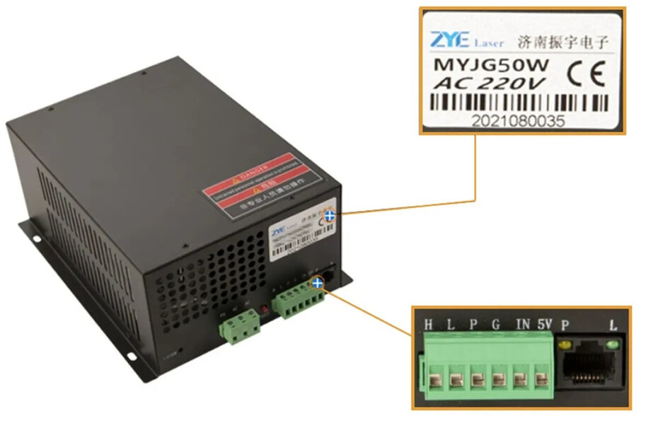

Of the things you checked, you missed the L, P inputs. L is laser enable and P is water protect.
I have a hard time reading what you say because I have no idea of it’s schematic, so device reference are difficult for me to handle.
There are lots of people here with the ability to help. If you have any issues or problems, sing out.
Good luck.

Thanks Jack, this is really helpful context - especially the note about 3.3V vs 5V TTL levels, since that’s something I hadn’t considered and may be exactly my issue.

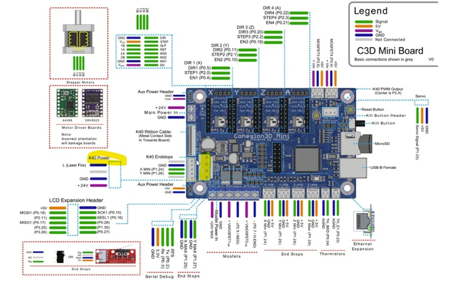

**Wiring setup (my board is the Cohesion3D Mini, not the LaserBoard):**
- **L**: wired to the Mini’s “K40 PWM Output” connector (board’s own label; center pin is P2.4). Driven via Smoothieware’s switch module (M3/M5, active-low). Confirmed via direct bare-wire jumper test that L->G on the PSU does complete some circuit (Laser Signal LED lights) but produces 0mA on its own.
- **P**: tried directly jumpered to G1 (water protect line per your note) - no reaction on the panel at all, LED or otherwise.
- **IN**: tried both from the Mini’s generic FET1 (P2.5) screw terminal and from P2.4 via PWM (laser_module, various S-values) - Laser Signal LED lights (via L), but 0mA throughout, and IN itself measures flat regardless of S-value on a basic multimeter.
**What I haven’t tried yet, and suspect may be the actual issue given your point about 3.3V logic**: the LPC1769 on the Mini is a 3.3V part. I’ve been driving IN from generic FET screw terminals (P2.4/P2.5), which I believe output unshifted 3.3V logic, not a true 5V swing. The board also has a separate, dedicated “K40 PWM” 3-pin header (Sig/5V/Gnd) that I originally had L wired to before moving L elsewhere - I haven’t yet tested whether THAT specific header includes any level-shifting circuitry that the generic FET pins lack.
Does anyone know if the Cohesion3D Mini’s dedicated K40 PWM header does any 3.3V->5V conversion, or is it just a direct breakout of the raw GPIO pin like the FET terminals? If it’s level-shifted, that would explain everything - I’ve never actually tested IN through that specific header while L is simultaneously held low elsewhere.
Also worth noting: the machine has a small daughterboard behind the front panel dial that appears to be a DAC (has its own chip, not a simple 3-wire pot) feeding IN via an RJ45-style cable. Turning the dial produces no measurable change on IN, but a small red test button on that same daughterboard does fire the laser at low real power (confirmed via ammeter). I haven’t been able to identify the chip on that board yet - if it rings a bell for anyone who’s dealt with OMTech’s K40+ SH-G panels specifically, I’d be glad to hear it.
Appreciate the help - will report back once I’ve tested the dedicated PWM header properly.

Thanks Jack, this makes sense and is really useful background on how the CO2 tubes actually respond to PWM vs LED/RF.
One clarification on my setup though: my G-code sequence already does hold L low for the whole job, not toggled per move - M3 is sent once at the start (arms L low via Smoothieware’s switch module), then a series of G1 moves happen (which is when Smoothieware’s native laser_module PWMs IN), then M5 once at the end (releases L). So structurally this should already match what you’re describing - L isn’t pulsing per-move, it’s held low for the whole span between M3 and M5.
Re: H vs L - my board’s terminal block only has G1/P/L/G/IN/5V, no H option, so that’s not available on this unit.
Your point about the mA meter showing RMS/duty-cycle current is really helpful context. That’s actually what makes my 0.0mA reading odd - even at a partial PWM duty cycle (I tried S0.3, ~30%) with L confirmed low, I’d expect to see SOME current if everything were wired correctly, not a flat zero. That reinforces something I raised in my first post: my board (Cohesion3D Mini, LPC1769, 3.3V logic) may not be outputting a strong enough voltage swing on IN - I’ve only tested from generic FET screw terminals so far, not the board’s dedicated “K40 PWM” header, which I suspect (but haven’t confirmed) may include level-shifting to a true 5V swing. That’s the one variable I haven’t isolated yet.
I don’t have a formal schematic (Cohesion3D’s site is down for me), but I do have a detailed unofficial pinout diagram that matches my board’s actual silkscreen, and my current config.txt.
Appreciate you sticking with this - will report back once I’ve tested the dedicated PWM header with L and IN both live together.

The P, L pulled to ground and IN terminal needs to have a dc (pwm) current control signal, before it will lase. If you don’t have all of these together, it won’t lase.
The tube should glow a pinkish color when it’s lasing. You will see current, if it’s lasing along with the color.
Although moot at this point, the H input is on the lps. If you drive the laser with pwm it’s usually right side up, meaning a 30% pwm upside inverted is a 70% pwm.

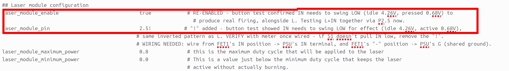

From your configuration file, this, area in red, makes me wonder what exactly they mean.

Thanks both - lots of useful detail here, let me try to address everything.
**Jack - re: the highlighted config section and “did you change L wiring”**
That’s `laser_module_pin 2.5!` - the `!` inverts P2.5, which is the pin I was using for IN (not L - L is still separately configured via the switch module, unchanged, still on P2.4/the K40 PWM Output connector). I added the inversion because a separate test (a small button on the machine’s panel PCB) showed IN reads ~4.26V idle and ~0.68V when that button fires the laser at low power - so I inverted P2.5 to try to replicate that “low = more power” behaviour on IN, same logic as L’s active-low enable.
So to be clear on current state: **L hasn’t changed** - still P2.4, still confirmed toggling correctly via M3/M5. What’s changed is I added a *second* signal on P2.5 for IN, tested alongside L, rather than L alone.

Update: confirmed the `!` inversion fix was actually live on the board when I tested (checked the config on the SD card directly to be sure - `laser_module_pin` reads `2.5`, no `!`, and `switch.laserfire.output_pin` reads `2.4`, no `!`).
Jack - to answer your question on M3/M5: these are standard G-code commands (M3 = “laser/spindle on”, M5 = “off”). In my config, I’ve mapped them via Smoothieware’s `switch` module to directly toggle a GPIO pin (P2.4, wired to L) - M3 pulls that pin low, M5 releases it high. So M3/M5 in my setup are purely acting as a manual on/off switch for L, nothing more sophisticated than that.
With that corrected config in place: L alone (IN left disconnected) - Laser Signal indicator lights correctly via M3/M5, as before. As soon as I reconnected IN (via the FET1/P2.5 screw terminal, now correctly un-inverted), the Laser Signal indicator **stopped** lighting at all, even with L still being pulled low via M3.
So right now: L alone → indicator lights (still no real current, as always). L + IN together (even correctly polarized) → nothing at all, not even the indicator.

2. Keep L as-is on the switch module (P2.4, confirmed toggling).
3. For IN, skip Smoothieware’s PWM for this test and use a simple two-resistor divider from the PSU’s own 5V terminal to G, tapping ~2.5V at the midpoint into IN - removing the controller from the IN side entirely to test whether P+L+IN fundamentally works before troubleshooting how to generate the right signal from the board.
Will report back with results once I’ve got P permanently grounded and the resistor divider wired in.
Without a schematic I have no clue what fet anything really is, so that part I don’t follow. I don’t remember a lot of gcode as I never use it if I can help it. Follow the m3/m5 commands.
I don’t like to call anything incorrectly wired to be called permanently. The L and P inputs are critical to it operating properly. You need to pull both L and P low. P is water protection and when you get this working, you need to wire P to your pressure sensor. If this ever goes high it will stop lasing. If L ever goes high it will stop lasing.
If that controller has a way to stop on a fault, you could use that. The Ruida has an input for both door protect and water protect. The advantage is if you use the P terminal wired a switch for water and it goes high, it will stop lasing. The controller doesn’t know it’s stop lasing, so job recovery is much more difficult. On my OMTech machine, P is wired to ground because my chiller tells the Ruida there is a problem and the Ruida stops everything.
Let us know what you find out.
Good luck.
:grinning_cat:
Good progress to report - got real firing for the first time. With P grounded, L held low via M3 (switch module on P2.4), and IN driven via a simple fixed resistor divider (~2.5V, no Smoothieware PWM involved) - ran a proper LightBurn job and it actually cut/marked the paper. Ammeter showed ~0.4mA.
New issue though: it started marking before reaching the intended target - specifically, a diagonal line appeared connecting to the corner of the rectangle, suggesting it fired during the initial G0 travel move into position, not just during the intended G1 cutting moves.
Looking at the G-code LightBurn generated:
G00 G17 G40 G21 G54
G90
M3
M106
G0 X143Y29 ← travel move into position
; Layer C00
G1 Y29.824 S1 F500 ← intended first cutting line
M3 (arming L low) happens right at the top, before the G0 travel move - and since switch.laserfire holds L low continuously from M3 to M5 (no per-move toggling), L was already low during that G0 travel. If IN wasn’t cleanly at 0V during that same travel move (residual voltage, or the demodulation circuit not dropping instantly), that would explain marking during travel rather than just during the intended G1 line.
Jack - this seems relevant to your point that both L and P need to be low together for lasing - it appears that’s sufficient on its own, independent of G0 vs G1, which means IN’s actual voltage during non-cutting moves matters a lot more than I’d assumed. I’m going to test IN’s voltage during a plain G0-only jog (no M3 sent at all) to see if it’s genuinely clean at 0V or has some residual voltage between commands.
Will report back with that result.
Maybe your external ammeter has the water protection signal turned off. Without the water protection signal on, you can’t control the machine to emit light via LightburnMaybe your external ammeter has the water protection signal turned off. Without the water protection signal on, you can’t control the machine to emit light via Lightburn
