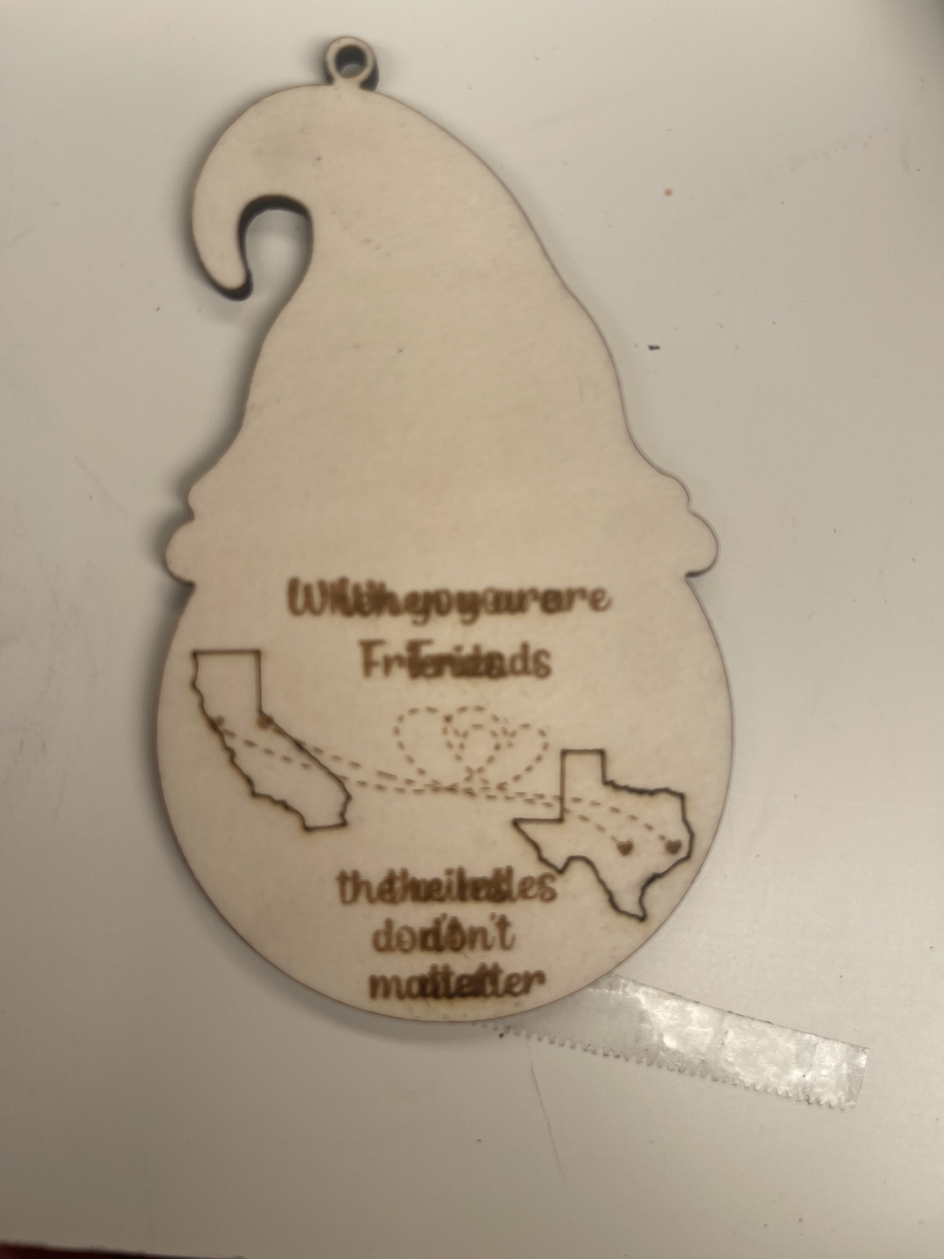

Hi we recently had a power outage and now when we try to engrave a leather patch in fill mode it is doubles everything. Is it a factory setting that somehow got changed or reset. It worked perfectly fine before.
It’s very easy to post a photo… that tells us more than you can…
Most of these machines, like the Ruida will recover after a power outage…
Turn off bi-directional fill and see if it is better. I’m wondering if PWM rising got triggered on or off.
I will try that. A few weeks I called omtech and they told me to turn off PWM rising on the x axis cause I was getting off center cuts. Which fixed my cut issues.
