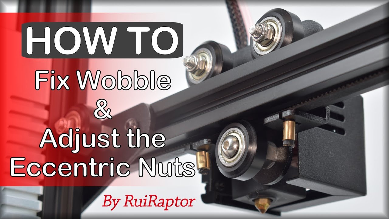

I dont have any knowledge of this laser, only the Ortur LM2. I had similar problems with mine. It turned out to be the eccentric nuts on the inside of the rail wheels. These tighten or loosed the wheels to the rail. Mine were too tight on the x axis so when i created a circle i had the same issue you are having. Not the bolts holding the wheels in place but the ones actually next to the wheels.
I dont know if this helps at all or if your machine even has eccentric nuts.
Cheers
[![](https://img.youtube.com/vi/GsEdU8ZtI6U/maxresdefault.jpg "HOW TO - Fix Wobble & Adjust the Eccentric Nuts (3DPrinter)") ](https://www.youtube.com/watch?v=GsEdU8ZtI6U)
