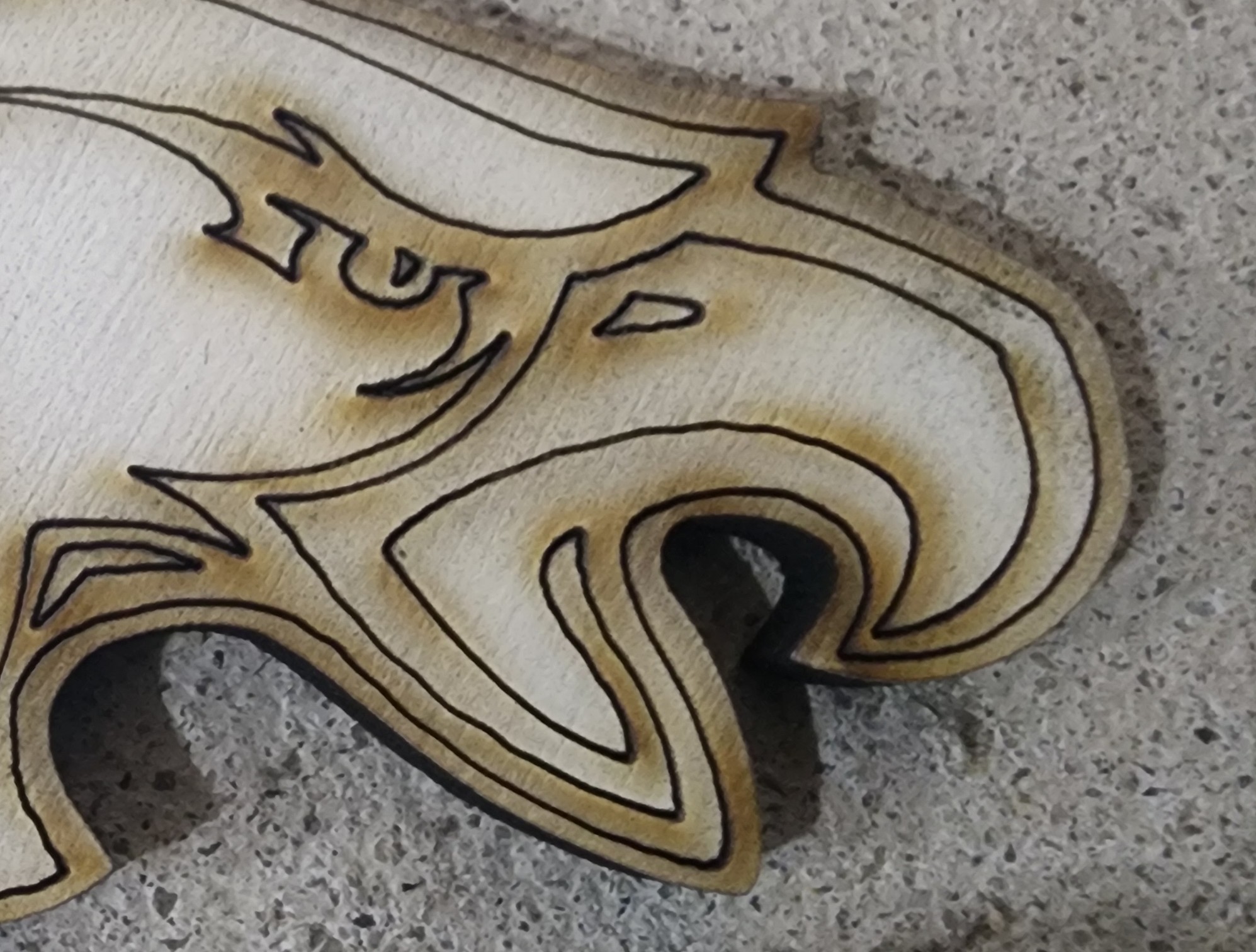

To the OP - did you end up resolving this? I have a new 100W 20x28 OMTech that has really bad wavy/squiggly lines. I’m in conversation with tech support but apart from having me check the belts and tension pulleys, we haven’t gotten anywhere yet.
I’ve tightened/loosened the belts, checked the lens to make sure it’s not jiggling in the laser head. I will do the circle test on all 4 corners to see if there’s a difference. Similar to the OP, this is only an issue when both axes are in motion.
See attached image.
My Ortur LM3 does not have this problem at all so I know this isn’t normal laser behavior.
the difference between CO2 and diode lasers is the CO2 uses mirrors and the Diode does not. Look for wobbling mirrors, or even the tube and make sure the lens is snug and not wobbling.
I’ve checked and secured all those - mirrors, lenses, belts etc. Now tech support is asking me to try RDWorks but if it is a mechanical issue not sure how that’s gonna help.
What is your curve tolerance set to?
0.05 - default I think as I haven’t messed with that before.
you can usually test if it is a mechanical issue by greatly slowing down the engraving speed. I would even go to create two vectors, a circle and a octagon inside the circle(not touching the circle) then engrave at your normal speed followed by an engraving test at a really really slow speed.
Just looks mechanical to me.
Here are some images of tests I’ve run this past week. 30mm/s seems pretty slow to me.
Figured I’d do some text as well and if you look at the second test line, all the curves are unsatisfactory. Or are my expectations just unreasonable?
There’s a lot to look for in mechanical issues like this. 30mm/s for a CO2 is rather slow and you still show the issue. Start looking at all the belts and how they fit and interact with the idlers and the drive gears. Check to make sure the belts are not too tight. Also look at the grub screws on the drive gears to be sure they are on the flat part of the stepper motor shaft and are tight.
Previously someone mentioned turning off air assist and seeing if that stops the wobble because the focus lens, if loose can wobble from air assist.
I am a noob to CO2 lasers - this is the first time I’ve heard of a grub screw. Kinda highlights the depths of my ignorance. If you have images of the grub screw and the idlers, I’d appreciate it. I’m going to google this too.
I did check the belts earlier this week and once I loosened the y-axis belts, another issue I was having (lines along the edges) resolved itself. I tested with the air-assist off but also made sure my focus lens was not loose on a subsequent test. All mirror-brackets (?) are solid and aren’t moving - neither are the 3 mirrors.
grub screws are the headless bolts which have allen wrench holes recessed into them and are used to hold the drive gears for the belts onto the stepper motor shafts and hold the idler gears(pulleys) on those rods.
You have to look really closely to make sure the belts are aligned on the pulley and not ever hitting the walls of the pulley gears. Same for the idlers because very time a belt tooth hits the edge of the gear/idler it changes the diameter and pulls the laser head more or less than it should. Same goes for if they put the wrong belts on the machine and the teeth of the belts are not perfectly fitting the drive gear slots for the belts.
And it’s good to see you are willing to google for things you hear and don’t know about. There’s lots of information out there on how this stuff works and doesn’t work.
And since this isn’t really a LightBurn issue, there’s a forum called Maker Forums which has lots of laser, cnc, 3D printer experts who can chime in with help.
Ah - so grub screws are set screws - those I’m familiar with. Your explanation is brilliant - thank you for that. I’ll take a look at the belts/gears now that I know what to look for.
Checking out Maker Forums. Thanks for that!
