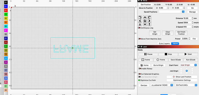

Hello! I just got a new OmTech K40+ laser this past week as an early birthday gift from my husband. I have just started to set it up and did 2 test runs on it, just a rectangle outline with a word outline inside of the rectangle, but the wording is backwards and upside down.
I have the homing position set in the rear (upper) left corner under device settings, as instructed in the OmTech manual. I am manually setting the origin when I make the design since the laser seems to only want to be in the home position otherwise. Then after jogging the laser into position, I am setting that as the origin. I have my job origin set to center.
Is there something in another setting somewhere that I am missing?I will try to attach some screen shots in a reply if that would help.

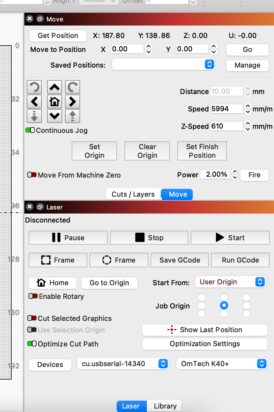

Okay, did that and now I have all of these little arrows showing on the design in the screen? I’m also adding an image from the user manual about where they suggested to set the laser origin. It could just be an error on their part.
Okay, off to try the new setting. :slightly_smiling_face:
That’s odd. Can you try restarting LightBurn to see if the problem persists?
That’s surprising. Can you confirm that this is a Smoothieware based solution? I’m questioning if something has perhaps chaned with Omtech’s K40+ offering.
Can you push the Home key in Move or Laser window, then push “Get position” in Move window. What is the reported position?
Still kind of the same issue, its backwards but not upside down at least…Ignore the line jump, the paper came untaped from the plate when it was burning. :upside_down_face:
This implies that the natural origin should be bottom-right but I’ve not seen any K40+ system be required to be configured that way.

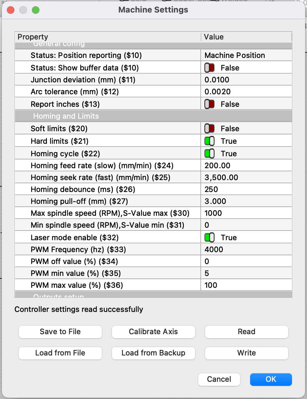

A few questions:
  1. Do your jogging controls work as expected? Left moves left, right moves right, up moves up, and down moves down?
  2. Did the machine come pre-assembled or did you have to assemble it yourself?
  3. Can you confirm that this is a Smoothieware machine? The Machine Settings you’re showing would imply this is actually a GRBL machine.
  4. Please confirm that when the machine homes that the laser head goes to back-left

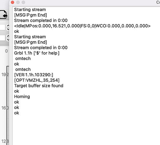

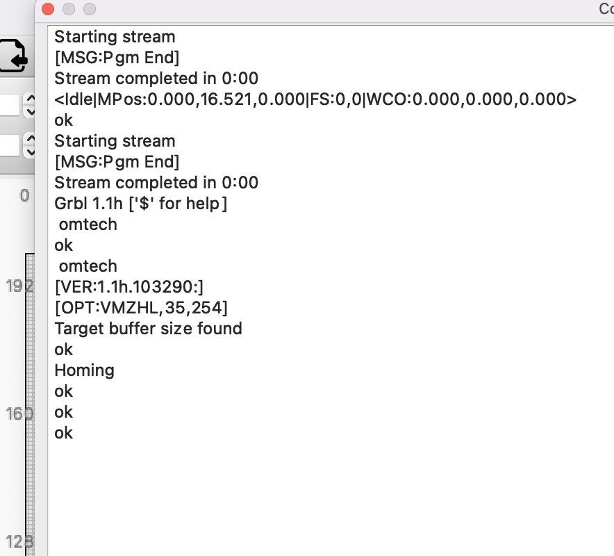

  5. Can you run these commands in Console and then copy/paste the full output:
$H
$I
I cannot confirm that it is Smoothie software. I can’t seem to find anything on their site about it or in the user manual.
The jogging controls are reversed for the up and down positions. The left to right works fine.
The machine was preassembled.
Not showing anywhere that it has smoothie software so yes, I assume its GRBL.
Yes, the laser homes in upper left/rear left corner.
Will run the commands and send you a screen shot, please give me a moment to do so. Thanks!
All were okay
Screen Shot 2024-02-26 at 7.25.16 PM
Screen Shot 2024-02-26 at 7.29.35 PM
Screen Shot 2024-02-26 at 7.23.58 PM
Okay. This must be the “revised” K40+ board. They seem to have shifted from a Smoothieware based solution to a GRBL based solution.
Let’s assume for the moment that top-left origin is indeed how they intend for this to work. Change that again in Edit->Device Settings.
The up/down jogging being backwards explains why image was flipped with top-left origin.
Let’s correct that first.
I’d suggest saving the output from the $$ that’s there now as a backup as we’ll be changing some of those.
