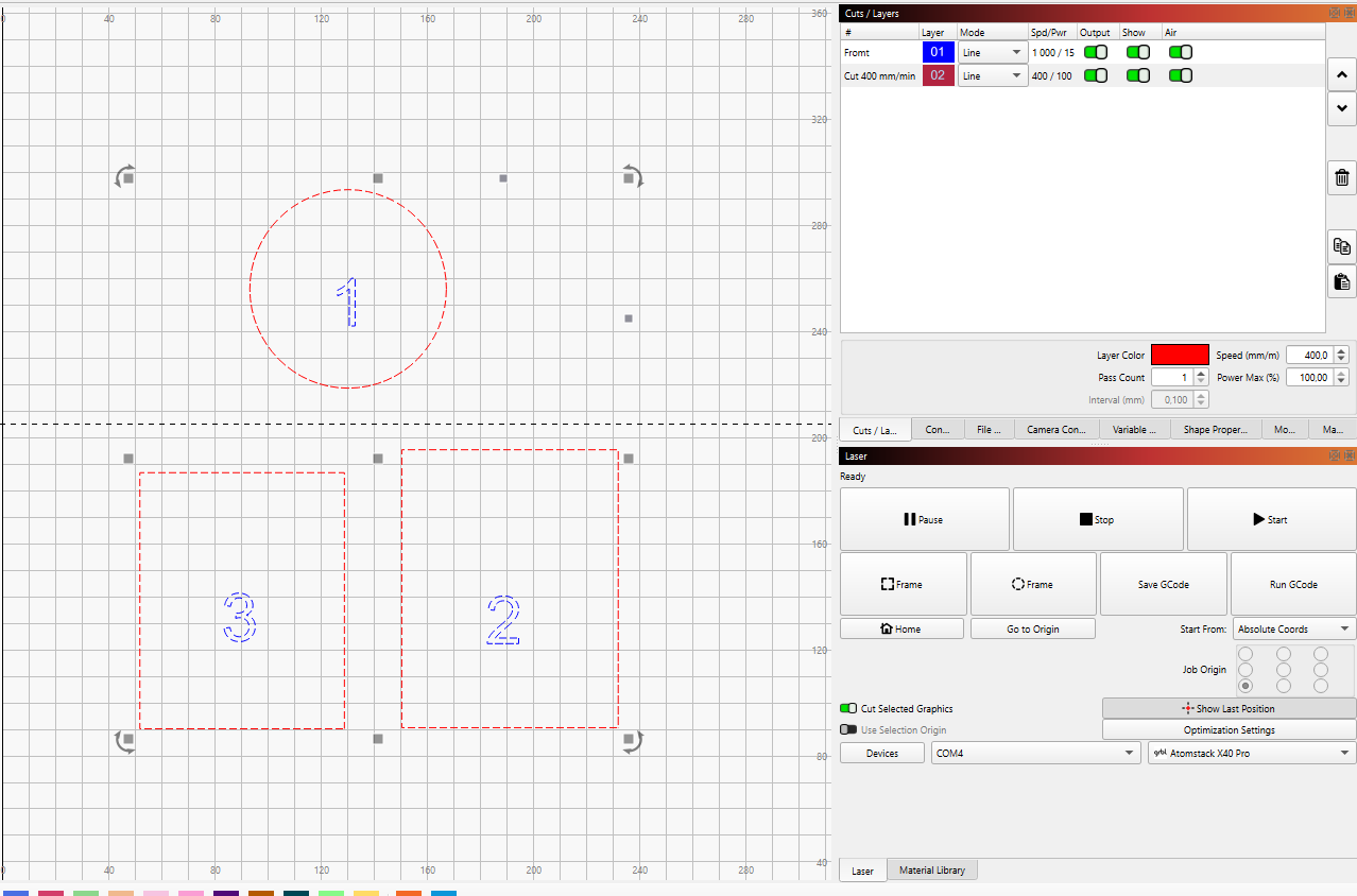

This is the preview before my cut:
Cut selected graphics set to cut all:

In your last image, Cut Selected Graphics is not turned on. Red is off, green is on.
Hi Mike - yes, I tested with both on and off
If on, graphics outside your selection will be ignored. I keep mine on all the time.
The only other thing I can think of is for you to do a Save GCode with the file I sent you. Save it with a .txt extension and drop it in a Reply. I will compare it to my version to see what might be different.

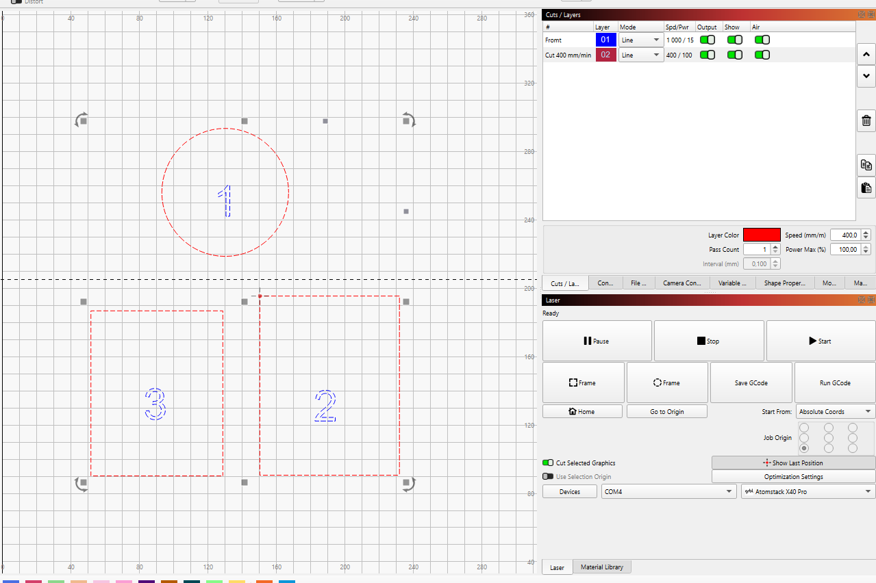

I re-installed 2.0.02 and re-ran your test.

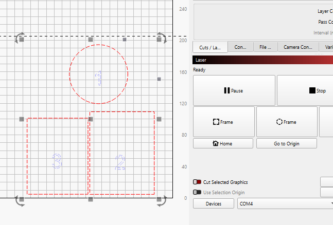

The first image is of my settings where Cut selected Graphics is switched on and where all objects where selected :

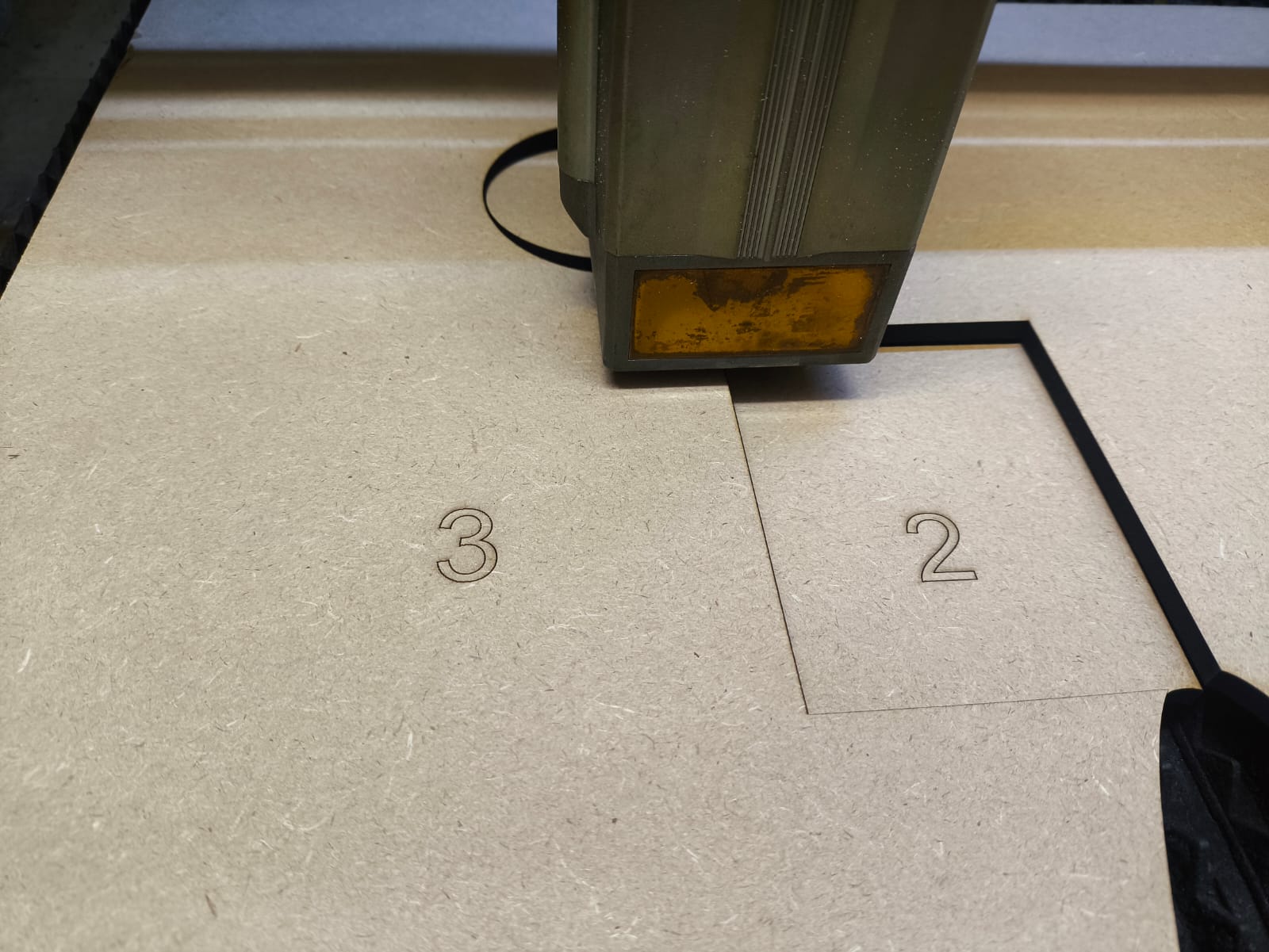

All 3 engravings where done but only object 1 and 2 where cut and then the laser stopped.
As per this image you can see that I get a Ready sign indicating that the job completed.
This is a photo of what engraved and cut (3rd object did not cut)
The laser also did not return to home as it usually does but got stuck where it ended with object 2

I think I see what is going on. Are you seeing any error messages in the Console window when it stops?
I have edited your GC file (attached) with comments. Your Lightburn appears to be generating the GCode for everything. There are no wonky GCode commands in it, so it is not being told to stop. Lightburn is good to go. The laser controller is deciding to stop on its own.
I notice every stop is when it is commanded to do something near the front left corner. the #3 was processed, but the rectangle around it was not. This tells me you are hitting a boundary over there. And this means your coordinate settings will not let you get there.
You willing to go through the steps to get this sorted out? If so, we first need to know if you have Limit switches.

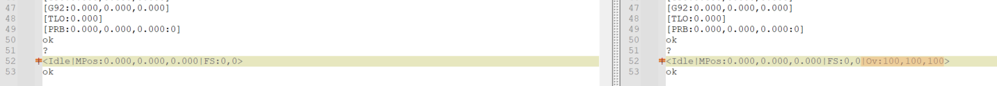

I also did the same for ver 1.7.08 :
Console Output v1.7.08.txt (700 Bytes)

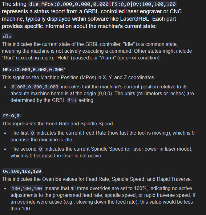

I comared the 2 files and only found 1 difference :
Ver 1.7.08 has the Ov:100,100,100 bit extra in the FS:0,0|Ov:100,100,100 value.

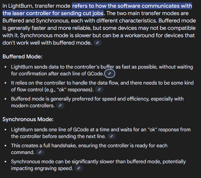

Previously my transfer mode was set to Synchronous.
I changed it to Bufferred and then I was able to run your test file without issues.
After this, I imported my file and placed objects all over the cut area and was able to cut every one without issues !
Thanks a million for your support !
Hope this will help someone else also :wink:
