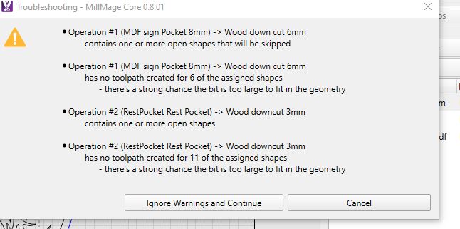

Open shapes not showing or closing
done the usual - went to edit
close selected shapes , auto join shapes
select open shapes set to pocket ,only thing still highlighted , clicked that again nothing shows
even tried select shapes smaller than selected using one of the smallest pieces
still comes up as above in preview , saved restart still there

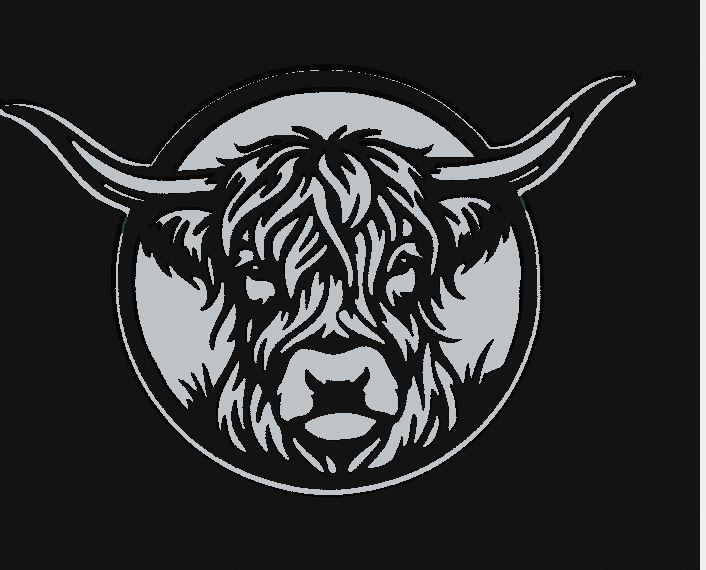

in preview it looks ok
am i missing the obvious

found problem after about half hour of searching found a minute little dot causing issue
Yes, there was a very small shape (less than 0.001mm) causing these two warnings:
Operation #1 (MDF sign Pocket 8mm) → Wood down cut 6mm
contains one or more open shapes that will be skipped
Operation #2 (RestPocket Rest Pocket) → Wood downcut 3mm
I’ve asked the dev team why the alert description mentioned “open” shape, I as that threw me off initially when I tried to “Select Open Shapes”, but perhaps because it is so tiny it also is effectively like an open shape also in some circumstances in the program?
But the shape can be found if you turn on start point visibility or use Edit>Select Shapes Smaller than Selected
It shouldn’t have caused any issues with this job if this particular warning was ignored.

LightBurn and MillMage are using the same core engine, but MM has more checks against this kind of thing. LightBurn has a few more mature “filters” for things that are so small you’d never see them anyway, and will automatically remove things that won’t contribute to the output.
MillMage’s output builder is entirely new, and doesn’t have those same checks. Typically, CNC work uses less complex geometry and designs with larger features than you would for laser work, so I didn’t expect to need this kind of filtering.
Have you reported this before? If you can reproduce it consistently and tell us how, we should be able to fix it.
What’s happening here is that MM is doing a bit of cleanup on the shape to remove line segments that are too short. In this case, all the line segments were too short, so the resulting shape was “open” - meaning the start wasn’t connected to the end.
I’ve changed the code to keep at least two segments, to make sure you can have a closed loop, which gets rid of the “open shape” warning. You still have the problem of the teeny shape that the bit doesn’t fit in, but that’s actually true. :slight_smile:
