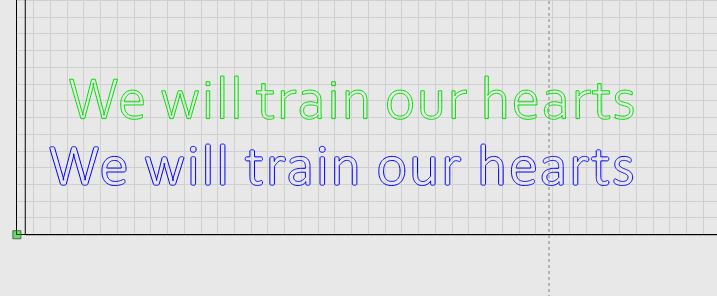

when do signs I will type some words set a tool and operation do a test , than copy text, set a dif operation and toolpath and do this multiple times till i find what i like with pervious RCs it has worked sweet
now in RC 10 every time i copy text and add new operation i have to save and restart MM for operation to work
this one green registered path and ran job, but when running wouldn’t lower to material.
after saving , restarting MM it cut sweet as
test dojo oath.mage (1.6 MB)

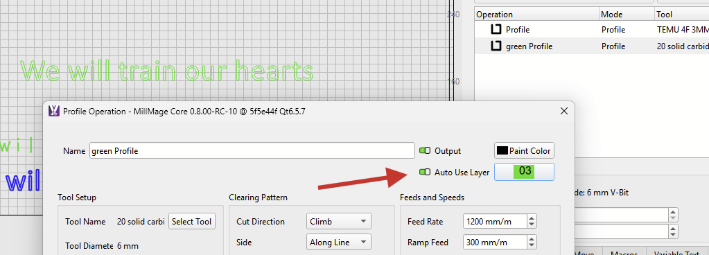

BTW: If you often need to assign the selected shapes to an operation, you might appreciate the Auto Use Layer feature.

copy paste the text in trailing to another part of work area
use this regularly when creating multiple operations. but not when im in trial mode

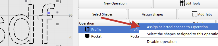

When you copy and paste text, the operations assigned to it don’t det copied. This is by design.
You need to either select the new text and assign it to the op with a right-click
Or enable the Auto Use Layer feature.
I just tried this with the old RC6, and saw the same behavior. (So I might be missing your point still.)
yip understand that , i copy text and set new operation and different tool , i do test runs to see what tool suits the text , eg some text looks better pocketed , others look better with a v bit along line,

yes preview shows it, but i prefer to see it physically to see the finish on the material, and then decide what i like the best
