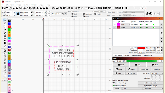

Origin does not match starting origin
My origin does not match up with where the laser starts. I have a xtool D1 Pro Tanks Ray
Your start point is currently set to User Origin - please try changing to Current Position or Absolute in the Laser panel, bottom right corner.
Have you tried absolute coordinates?
