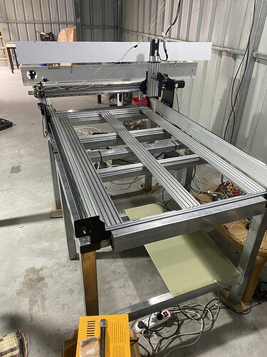

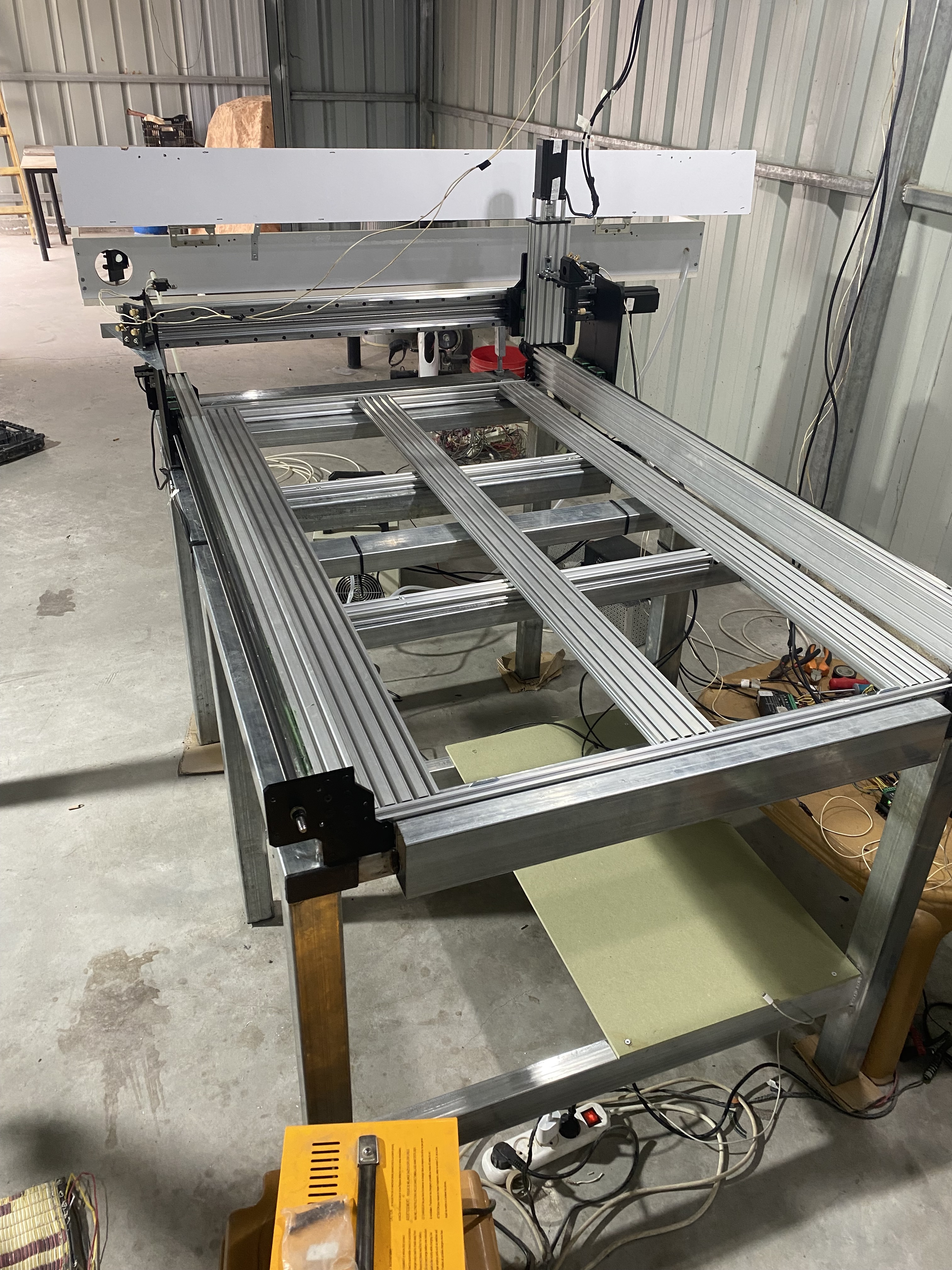

I build this machine in photo size 850mm*1500mm When I put go to the origin point there is an error I don’t know what the reason is

I have home switch and all directions axis true
The problem x axis origin not true (5cm difference)

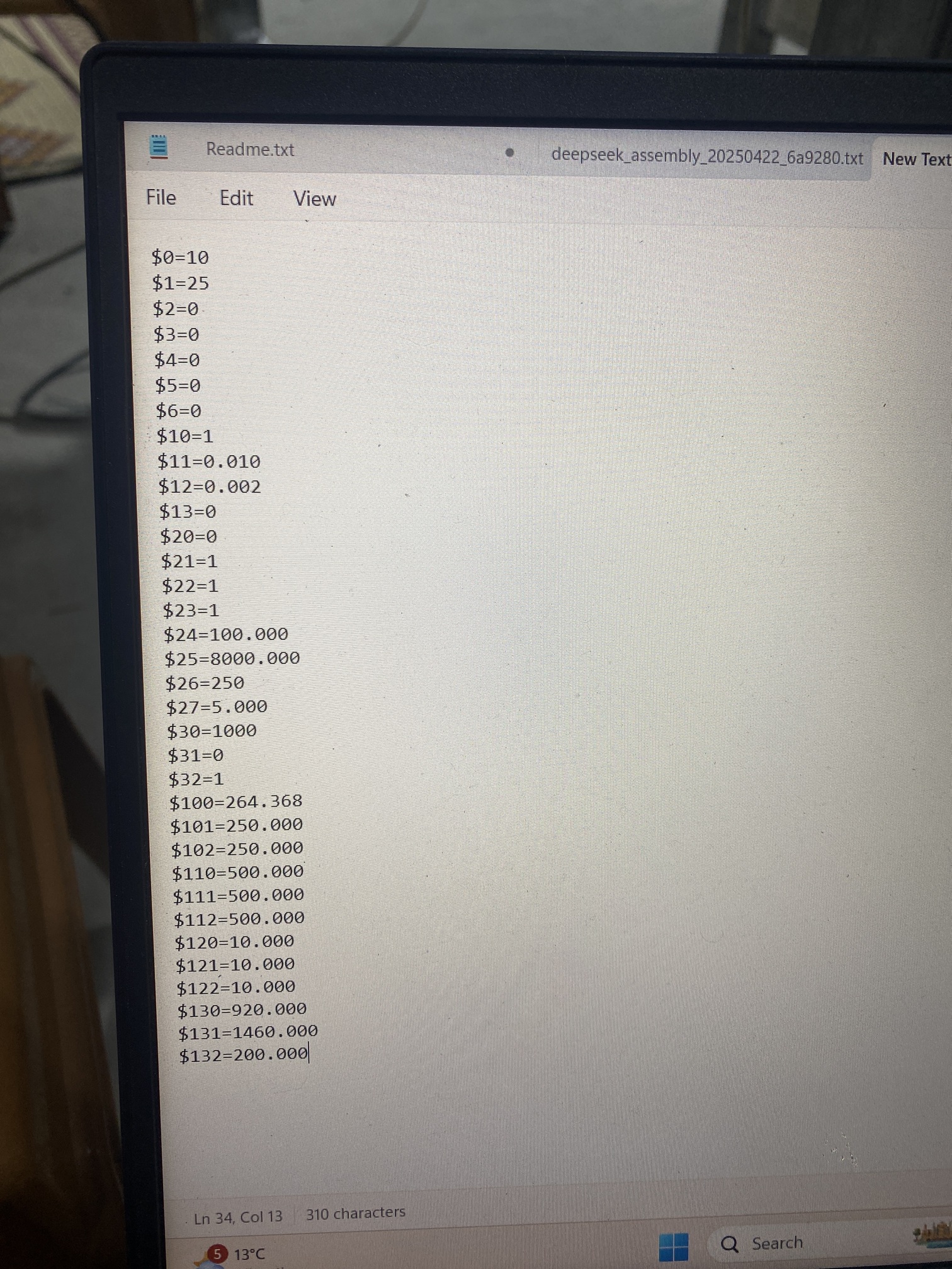

What do you mean? You are homing, but then the position is wrong? If you homed, the laser should sit at 5,5 (5mm from zero) according to your configuration. Did you set some offset? What’s the output of $# ?

No offeset
It’s still a firmware issue then. LB only sends the $H command to make the device home. If the position is incorrect afterward, LB can’t do anything about it.
