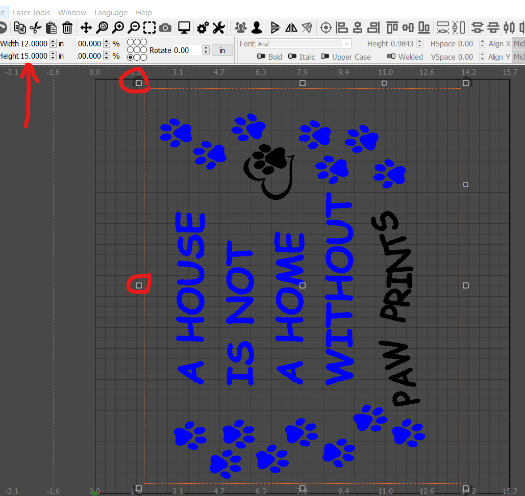

You need to re-size the image:
Click on the object.
Select a corner (drag handle)
click and drag to make the object bigger.
-or-
Use the Height and Width boxes. This image is 6.343 inches by 9.06 inches.
click inside the Width and Height boxes to enter the value you want…
handles circled
