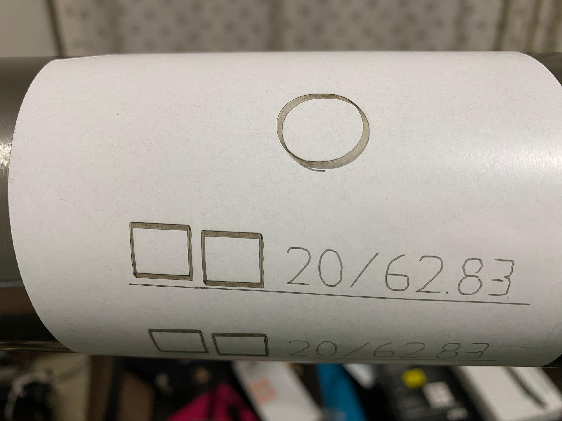

Then I try to engrave a Thermal Printer paper roll (for test), but I can’t get a good engraving. The laser don’t pass two times for the same place.
I change the “roller diameter” and “mm per rotation” values, with no success.

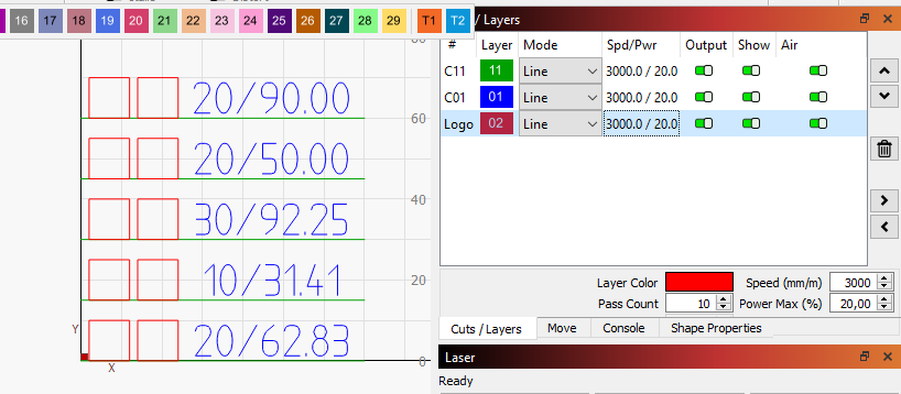

In the sample file, first number is “roller diameter” and second value is “mm per rotation” used to engrave. Red layer set to 10 pass.
Attached the test file I’m using and this are the results:

It looks like your paper roll might be slipping on the rollers. Try putting a rubber band around the thermal paper roll and the rotary rollers.
I tried now in an aluminum bottle. Same result.

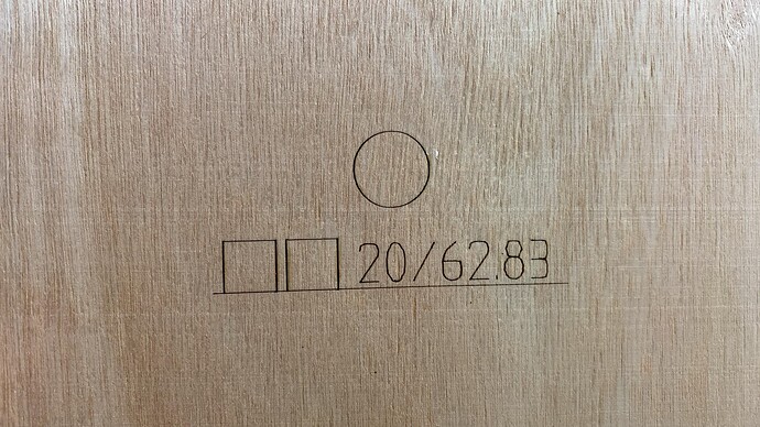

I tried with a circle, same result. It’s like it’s moving further in one direction. Something like 10 steps forward, 9 steps backward (random numbers for the example).
Same file in wood without rotary:
I really appreciate your help. Thanks!
If a rubber band (assuming you had it holding the cup against the rollers, and not just around the cup) and reduced acceleration did not fix it, I say it has to be an error in the rotary motor positioning commands from the controller. In other words, there is a settings error.
Try this… Put a mark on the driven rotary roller. With the rotary attached, enter G00 Y251.327 in the Console window (if you get an out of bounds error, reverse the sign). That should command the rotary to rotate 4 rotations, and the mark should be in the same start position. Now enter G00 Y-251.327 (note the polarity change) and it should return to the exact same position it started from.
If it does not, your rotary calibration needs a correction.
If it does return to the same position, I am asking for @misken and/or @bernd.dk to step in because I am traveling today. If they join the conversation, expect them to ask you to redo what you have already done. That is part of the diagnostic process.
Basically, the steps or mm per rotation settings do not contribute anything to the issue. Those settings only change the actual size of the design, but it should be repetitive, just with a wrong distance.
