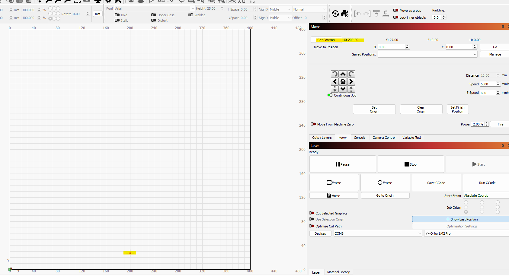

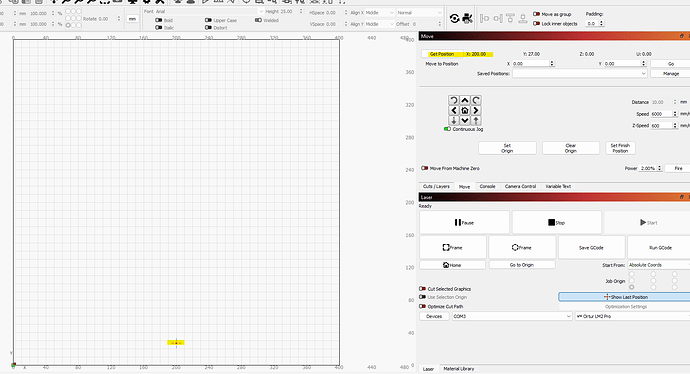

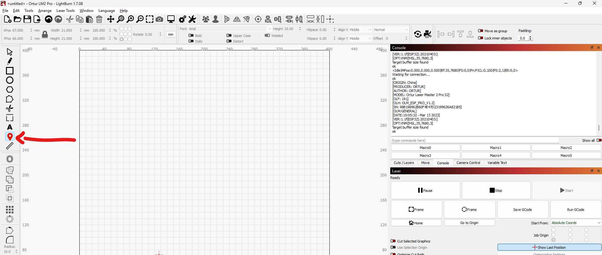

 ![image](https://forum.lightburnsoftware.com/uploads/default/original/3X/5/9/599caaebe07456575c9e004273ebf55051ad30df.png)
The button for setting laser position in the map
 ![image](https://forum.lightburnsoftware.com/uploads/default/original/3X/1/b/1b0e55f765337a93dcaa5bceb16f3a0a28fe9003.png)
When clicked the button, you set the laser position in the map, and the laser will move to the selected position.
With that function, the laser moves ok in every direction.

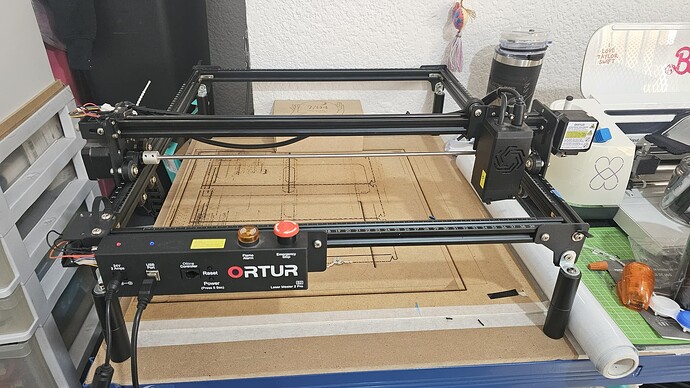

![Grabación 2025-09-08 110128](https://forum.lightburnsoftware.com/uploads/default/original/3X/d/5/d5eef0d5fdd2fd65b0a52b860f1ac6d83e2ddaee.gif)
The initial position it’s now at zero correctly
 ![image](https://forum.lightburnsoftware.com/uploads/default/original/3X/5/1/51b8a96dec189f566518d76e233e4119d5038758.png)
BUT physically it’s on the limit.
 ![20250908_110404](https://forum.lightburnsoftware.com/uploads/default/original/3X/d/d/dde6d8441ba83570e6887f2a05070ca4b5cb98a2.jpeg)
<div class="post-metadata">
**Post date:** [September 8, 2025, 5:32pm UTC](https://forum.lightburnsoftware.com/t/ortur-lm2-pro-s2-freezes-in-busy-state-in-lightburn-works-fine-in-lasergrbl/178002/24 "2025-09-08T17:32:50Z")
</div>
**THAT is where it Homes?** Your Xaxis Home switch is on the left in the image. I cannot see the Yaxis Home switch, but I am guessing it is on the front left corner.
When you hit Home in the Laser window, does it grind when it stops?
_ **If we do not get the Home cycle right, nothing else will be.** _
1. If the laser module goes right instead of left when Homing, switch the **X Homing direction invert ($23)**. Then try again.
2. If the laser module goes back instead of front (towards the control box) when Homing, switch the **Y Homing direction invert ($23)**. Then try again.

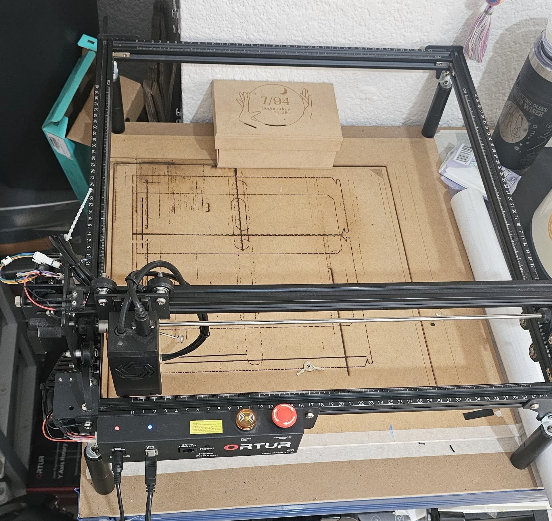

No, there’s where when I set the Teardrop tool, the laser goes.
What I’m trying to say, is that, that’s the limit for my laser, as it was the 200 mm, but it’s the 400 mm X. Same for the Y axis.
**HOME**
 ![20250908_113438](https://forum.lightburnsoftware.com/uploads/default/original/3X/d/3/d3bd2a1fe7288a792695bdcdff54626d7ebef7d2.jpeg)
In the previous images:
Here’s the laser (teardrop tool) set at the 200 mm
 ![image](https://forum.lightburnsoftware.com/uploads/default/original/3X/8/8/889d31e8a3b923f107bb1e2e1db509878f76b260.png)
But physically on the 400 mm
 ![image](https://forum.lightburnsoftware.com/uploads/default/original/3X/8/5/85cd4aa4d46905c83cff52023d54b7c0cc29419c.jpeg)
Still getting “busy” and freeze.

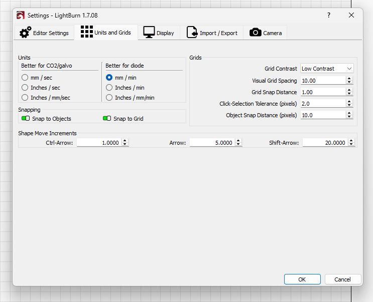

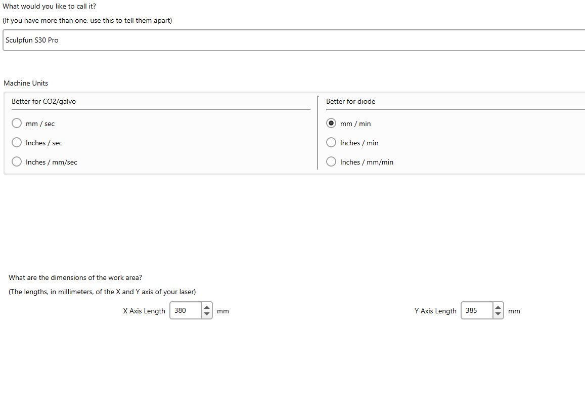

In Laser window, click on Device → Edit → Next 2 times. You should see a window like this one. Please show it…
 ![Device Setup](https://forum.lightburnsoftware.com/uploads/default/original/3X/f/2/f255b90e8664cf8f4df2120c78f84765dd6ab37c.jpeg)

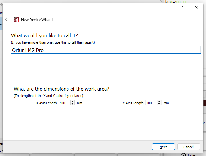

Here’s the one:
 ![image](https://forum.lightburnsoftware.com/uploads/default/original/3X/2/e/2e9ff5123a72309d5f0468541526061c85eab34e.png)
**Post date:** [September 8, 2025, 7:06pm UTC](https://forum.lightburnsoftware.com/t/ortur-lm2-pro-s2-freezes-in-busy-state-in-lightburn-works-fine-in-lasergrbl/178002/30 "2025-09-08T19:06:00Z")
</div>
400x400 in Lightburn.
$130=400.000 and $131=400.000 in GRBL.
It should be able to go farther back. 😡

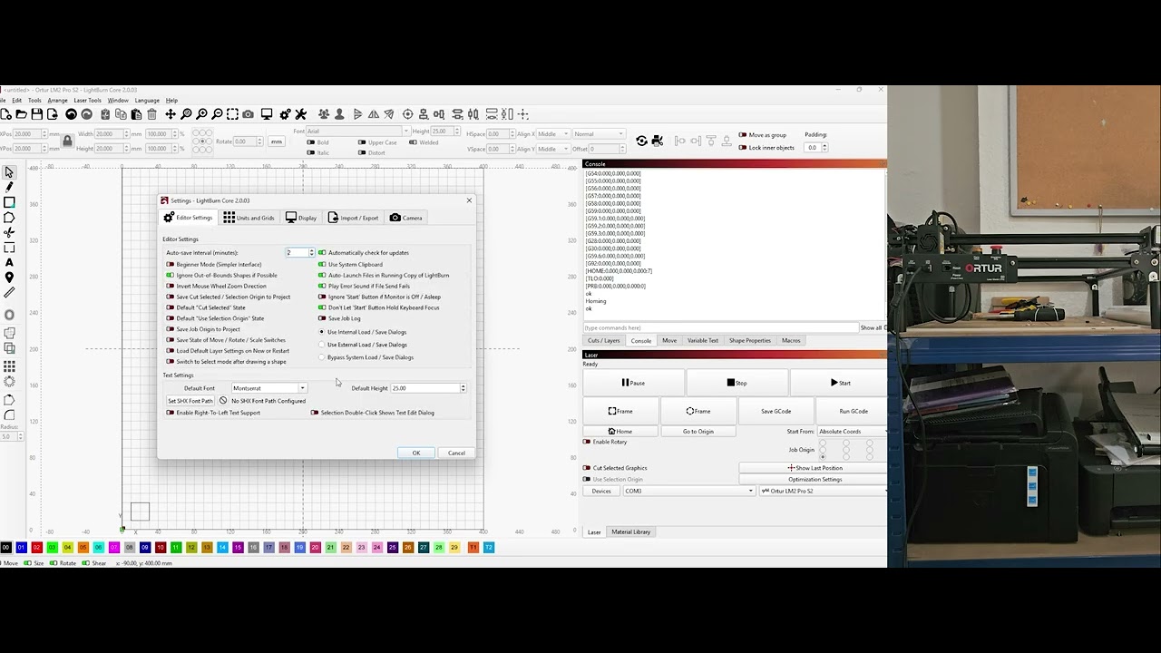

I recently upgraded to **LightBurn 2.0.03** , and I can finally move the laser in any direction without getting the “Busy” signal.
**However** , when I try to **start a project** or use **Frame** , the machine immediately shows “Busy” again and won’t proceed.
I also noticed that the **Y-axis movements are very rough** , unlike the X-axis.
I recorded a short video to show the issue. Here’s the YouTube link:
[![](https://img.youtube.com/vi/j06h2l4qRR8/maxresdefault.jpg "Error Ortur LM2 Pro S2 - 10/09 - Lightburn 2.0.03") ](https://www.youtube.com/watch?v=j06h2l4qRR8)
**Author:** ![NicholasL](https://forum.lightburnsoftware.com/user_avatar/forum.lightburnsoftware.com/nicholasl/32/40942_2.png) [@NicholasL](https://forum.lightburnsoftware.com/u/NicholasL)\
**Post date:** [September 10, 2025, 10:02pm UTC](https://forum.lightburnsoftware.com/t/ortur-lm2-pro-s2-freezes-in-busy-state-in-lightburn-works-fine-in-lasergrbl/178002/34 "2025-09-10T22:02:02Z")
</div>
Go to your [Console Window](https://docs.lightburnsoftware.com/UI/ConsoleWindow.html), and enter these lines one at at time;
$100=80
$101=80
These GRBL settings determine how many microsteps are sent to the X ($100) and Y ($101) stepper motors for every 1mm of travel. You seem to still have them set too large.

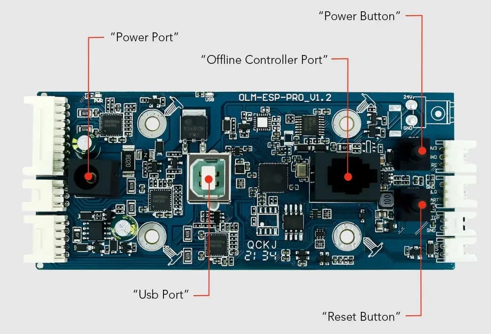

The motherboard is OLM-ESP-PRO\_V1.2
 ![image](https://forum.lightburnsoftware.com/uploads/default/original/3X/e/9/e99964691cd8e5dcc7fe373253ad864f3b358fa2.jpeg)
**I’m So Stressed Out! 😫**

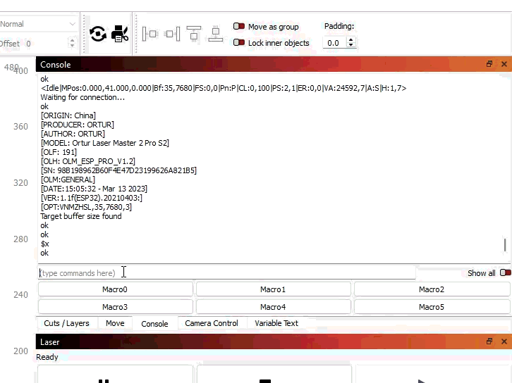

The controller responds with “ **Ok** ” to let Lightburn know it is ready for the next command. It appears it is **not sending the Ok after it sends** the \<Idle|MPos:0.000,0.000…" string to Lightburn. This is a Status Message sent by the controller.
Turn on Show All to see if there is anything else being sent after the status message.
Have you contacted Ortur about this?

With **show all:**
[ORIGIN: China]
[PRODUCER: ORTUR]
[AUTHOR: ORTUR]
[MODEL: Ortur Laser Master 2 Pro S2]
[OLF: 191]
[OLH: OLM\_ESP\_PRO\_V1.2]
[SN: 98B198962B60F4E47D23199626A821B5]
[OLM:GENERAL]
[DATE:15:05:32 - Mar 13 2023]
[VER:1.1f(ESP32).20210403:]
[OPT:VNMZHSLW,35,7680,3]
Target buffer size found
ok
[G54:0.000,0.000,0.000]
[G55:0.000,0.000,0.000]
[G56:0.000,0.000,0.000]
[G57:0.000,0.000,0.000]
[G58:0.000,0.000,0.000]
[G59:0.000,0.000,0.000]
[G59.1:0.000,0.000,0.000]
[G59.2:0.000,0.000,0.000]
[G59.3:0.000,0.000,0.000]
[G28:0.000,0.000,0.000]
[G30:0.000,0.000,0.000]
[G59.6:0.000,0.000,0.000]
[G92:0.000,0.000,0.000]
[HOME:0.000,0.000,0.000:7]
[TLO:0.000]
[PRB:0.000,0.000,0.000:0]
ok
Homing
ok
$x
ok
Starting stream
Stream completed in 0:00
ok
Starting stream
ok
Starting stream
ok
Starting stream
ok
Starting stream
ok
Starting stream

> [@segorada](#):
> $100=160.000
> $101=160.000
This is normally 80, not 160. If you tell it to move 1mm, it would move 2mm (twice as many steps) instead.
I watched your video again:
1. You do not have Continous Jog turned on. It is moving in 10mm increments, one for each click of the mouse.
2. I saw **GRBL-LPC** in your devices window. Were you specifically instructed to use the -LPC variant for your Device type? Maybe you can create a Device Manually and select just plain **GRBL** as the Device Type. Manually creating one is really easy. Then select the new one and see how it behaves.
