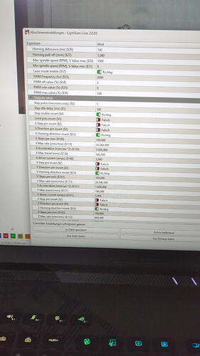

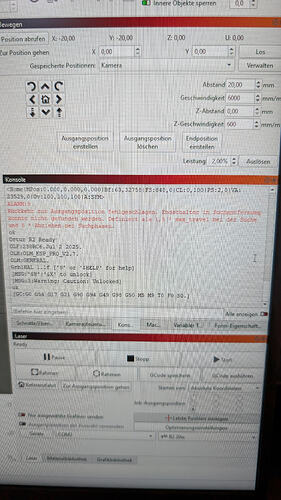

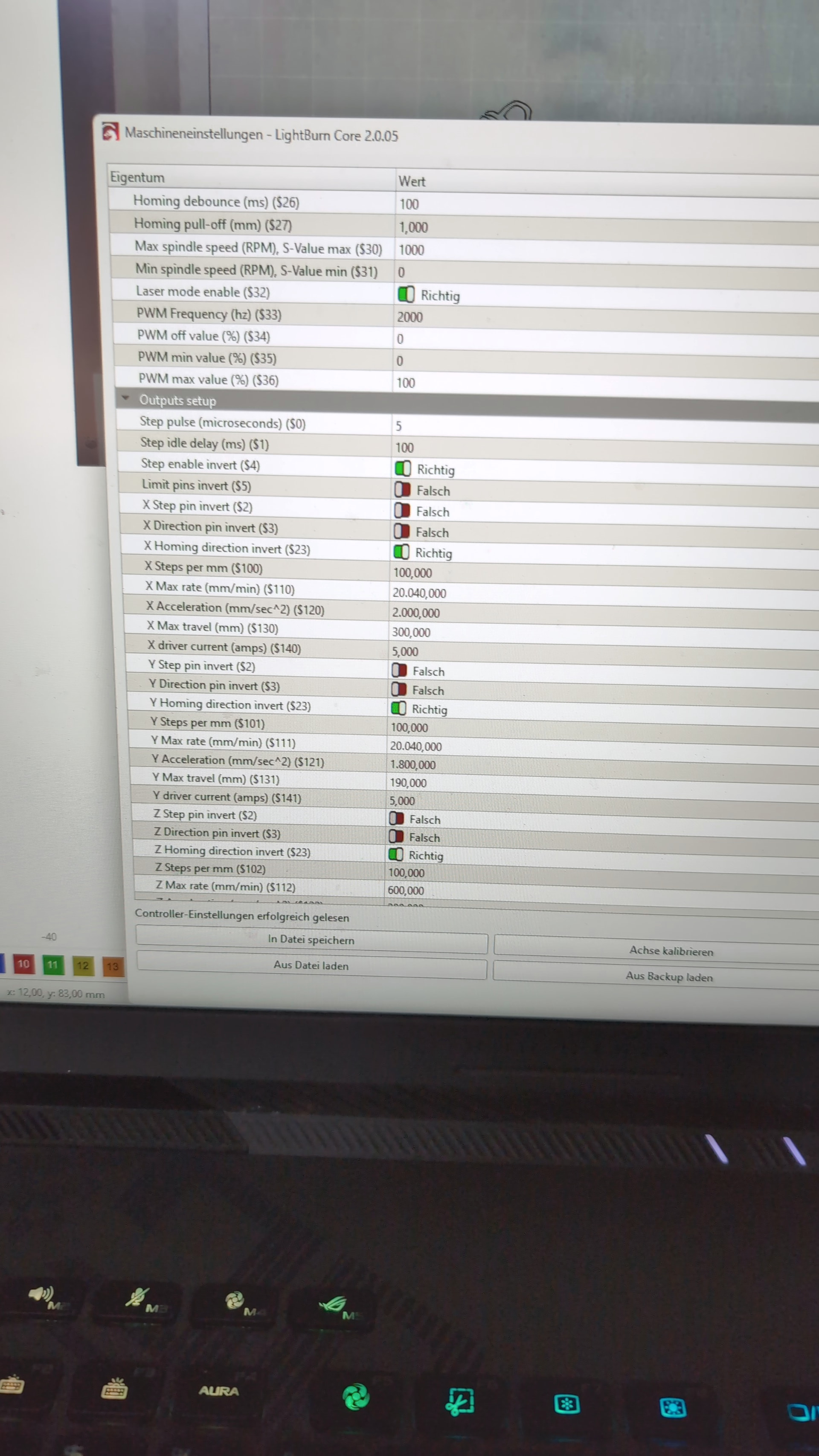

Hi
I’ve recently started getting this error message in LightBurn when I click the Home button. I haven’t changed any settings on my Ortur R2, except for switching the laser module from 20W to 1064W and back again.
Before the switch, this message didn’t appear:
ALARM:9
Return to home position failed. Limit switch within search range could not be found. Defined as 1.5 \* max\_travel during the search and 5 \* subtraction during search phases.
What does this mean and what’s causing it?

Hi @Tolzi_Woodwork
Alarm:9 relates to the limit switches, as you say. If you’ve recently changed some hardware on your machine, make sure that you have reseated all the wiring as carefully as possible. It is possible that your new, more powerful module is generating electrical noise that could be affecting the limit switches.
If you have a tangle of wiring around the new module wiring, try separating it a bit. You can, of course, also approach Ortur’s own tech support. This issue is very much about the hardware of your machine, but we’re happy to help, to the best of our ability.

I was already using the 20W module before switching to the 1064 1.3W module, as I was laser cutting metal.
After using the 1064 1.3W module, I reinstalled the 20W module because it gave me more power.
The laser was originally delivered with the 20W module, and until the switch, I never encountered an error message like Alarm 9.
This only happened after switching back from the 1064 1.3W module to the 20W module.

@Dominic is correct, it is a hardware issue.
Move, or Jog. the laser until it is sitting _on_ the limit switches. Then enter **?** in the Console window. Now move the laser _off_ the limit switches and do the same thing again.
Copy/paste both lines containing “ **|MPos:** ” in your reply. This is to confirm the controller is seeing both switches.

I looked up your model laser and I am believe it has limit switches for Homing. But please check to make sure.
**There were supposed to be 2 MPos lines.** With only one, we do not know if you were sitting on the switches or not. You may have to hold the switches with your finger.
This is something like what we are looking for (my Yaxis switch was held closed by finger):
**\<Idle|MPos:105.350,62.160,0.000|FS:0,0|Pn:Y\>**
There will be no “Pn:” if a switch is not closed. Hopefully your controller reports in the same way.

Move the laser head to the home position and enter the ? command. If you don’t see
`Pn:XYD|` then your switches are not being contacted properly by the laser and are not activated.
The previous test where you activated with your fingers shows the switches are functional, but that test doesn’t prove if the laser is making contact with the switches in the home position.
