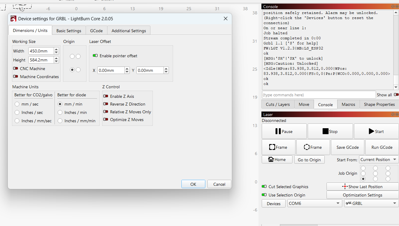

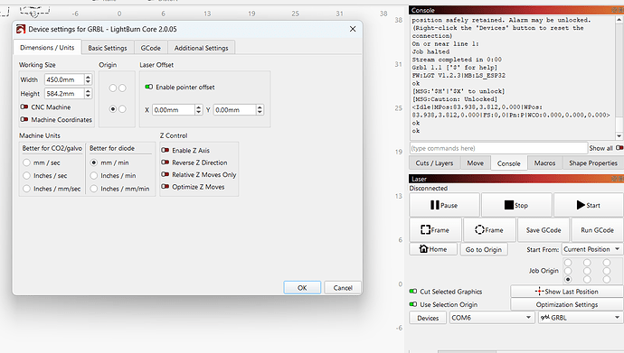

hello, i need help with the laser, it was working fine. but now when i try ti frame a large image it keep saying its out of bounds, and i try to fix but it keep doing it.
Here is the error message from lightburn:

Homing
ok
Project loaded in 13 milliseconds
<Idle|MPos:0.000,0.000,0.000|WPos:0.000,0.000,0.000|FS:0,0|Pn:P>
ok
Starting stream
ALARM:2
G-code motion target exceeds machine travel. Machine position safely retained. Alarm may be unlocked. (Right-click the ‘Devices’ button to reset the connection)

$131
$131=440.000
ok
$130
$130=450.000
ok

I also did a video, to show even though I couldn’t frame because out of bounds. I started the laser anyway to see, and it stop after like 15 seconds. I did it twice to verify.
I see you are using Current Position. Would using Absolute Coords possibly help?
