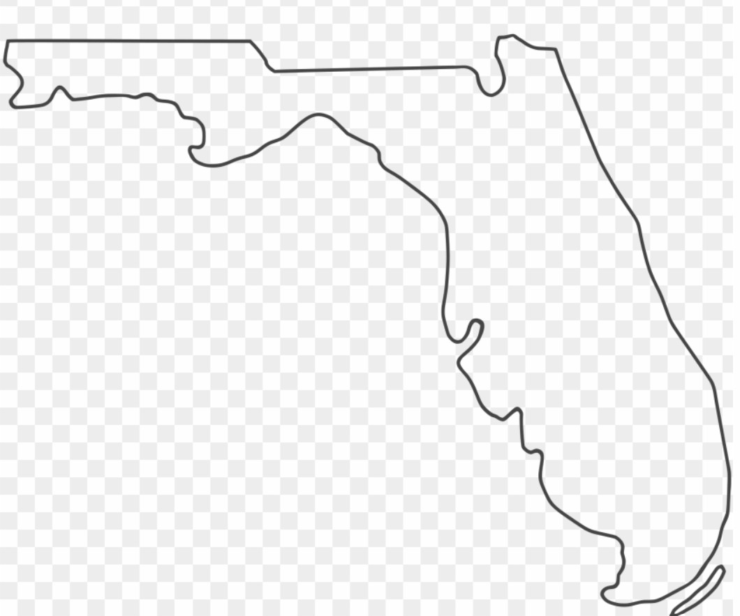

FL Cutout-5in Zap (a.k.a. “Zap”) is the original file, and FL Cutout-5in (a.k.a. “New”) is a rebuild where I only used 1 state outline.
I originally thought my SF-A9 had a screw loose. In the “Zap” output, A, B, and C were the same size, but C, D, and E were all different in size and rotation. So I switched to my S30 machine with burn corrections.
The S30 produced the same results with the “Zap” file. I created the “New” file thinking “Zap”might be corrupt. In that one A, B, D, E, and F were all good, but C was the wrong size. So I reinstalled LB and rebooted Win, still with no happy.
I tripple checked (3X) the sizes of the outlines in the grid, and found they were all the same.
I ran some tests using a line instead of a cut, and that made no difference.
I can use some serious brain power here!

  1. Uninstalles Lightburn, downloaded a fresh v2.0.05, and installed.
  2. Did a Windows 11 repair.
  3. Uninstalled the C++ Redistributables and installed from a fresh MS site download.
  4. Saved a FL outline JPG using the Preview.
  5. Opened a blank copy of LB (new project creates from scratch).
  6. Imported outline (attached) and removed inner path.
  7. CTRL-D’d 5 copies and manually arranged.
  8. Ran design on cardboard to save dollar$.
  9. Although identical in the LB grid, outputs were not identical.
ACER i5 laptop, Win11 25H2
250Gb HD about half full
USB to laser
The original FL file runs fine on a different laptop. I can determine neither the cause nor fix for this issue. PM me if you need more information.

  1. The SVG used to create an entirely new file made no difference on the SF-A9 machine.
  2. The GCode from the faulty PC output (to SF-A9) also produced non-matching outlines when run on the S30 machine.
So it is definitely an issue in the ACER laptop with Lightburn.
I am open to try something else if anyone has any ideas. I have exhaused my realm of experience here.
