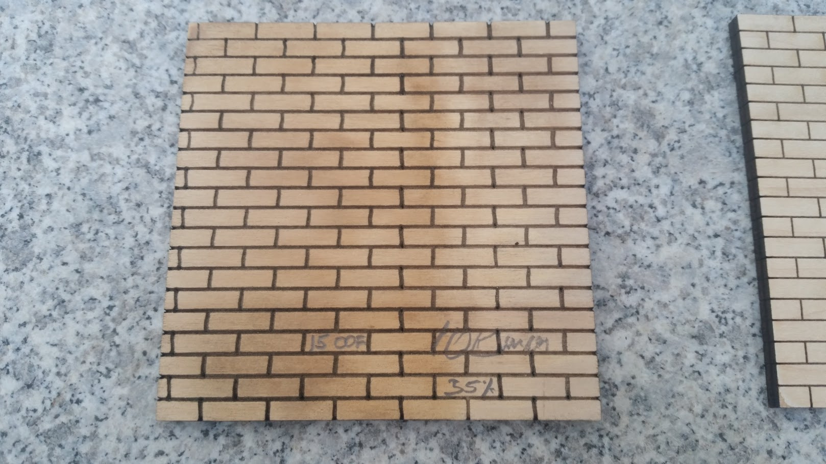

I’m trying to make some brick textured panels.
Drawn out simple brick pattern in lines, not rectangles, all brick lines grouped.
Have cut out border after that.
But sorting, no matter which i choose, jumps all over the place.
It would do its job, but for reasons i want to make laser draw horizontal lines first and then all small vertical lines all the way down to the bottom even if they’re broken, laser on-off-on-off, all the way down, move to next column, repeat until done.
Is there any way to sort like this ?
Not sure i’m explaining well.

I always had problems cutting small details. Brick pattern would be a doddle if i could do what i described here. Now i get this:
But if i could just cut straight down through small lines it would be nice and straight.
I know i need to fix underlying condition, but at least sorting by “co-linear” would make cutting square things easier.

When ‘Reduce Travel Moves’ is set, you’ll pretty much always get a connected line preferred over a disconnected line, even if the disconnected line doesn’t make you change direction. The scoring that causes this could be adjusted some, but what’s in there now works well in the general case, and yours is relatively esoteric.
Having said that, I checked the code, and I’m weighting direction changes by area, and the area of a line is zero, so that’s likely causing this not to work well for your case.
It’s also worth noting that with a speed of 12mm/sec, direction changes are not costly and the travel moves are a small fraction of the time spent in this file. Rearranging this file by hand to force it to take the “perfect” order you’re looking for makes the file take longer.
This is the perfect, top to bottom, left to right, line only version, with about 2090mm of rapid moves, taking a simulated 7 mins, 27 seconds to complete:
And this is the first order that LightBurn comes up with, doing one square at a time, zig-zagging from top to bottom, with only 1400mm of rapid moves, and taking a simulated 7 minutes and 9 seconds to complete:
My point being, I’ve put a fair bit of time and effort into making the cut planner choose the things it does because they tend to be faster in the general case, even though some of those choices might seem counter-intuitive.
