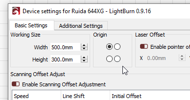

When I send the pattern to the laser, a Boss 1420, it comes in upside down. Have to invert the pattern on the computer and resend it. Is there a box I have accidently checked that flips the design automatically? Thanks for any help. I’m really new.
Go to Edit > Device Settings and change the Origin to match the corner that your machine seeks when you first power it up:
I will try that on my next job after the one that is running now. Thank you.
