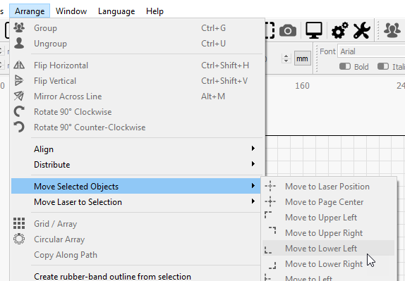

In your case, you could also just ‘Select all’ then click ‘Move to lower-left’:
