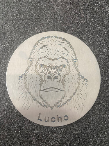

Hello, j’ai effectivement gravé sur du metal il y à plusieurs jours, mais je n’ai pas eu de soucis (photo jointe)j’ai re gravé sur du bois après ça a bien fonctionné,c’est après que j’ai voulu graver une autre plaque en métal que le problème est survenu. Merci
Hello, I did engrave on metal several days ago, but I didn’t have any problems (photo attached). I then engraved on wood and it worked fine. The problem arose when I tried to engrave another metal plate. Thank you.
Engraving wood can cause smoke and tree sap to collect on the surface of the lens that faces toward your project.
It can happen quickly without a strong smoke extractor.
The manufacturer of your laser should offer advice and techniques on how to best clean the lens.
