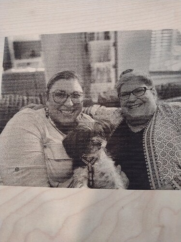

My question is twofold. 1. What is causing the horizontal lines and 2. Can you take a look at my settings and make any suggestions? I have an Atomstak A5 Pro. Many thanks for your help!
I forgot to mention the wood is solid Maple and has been coated with a borax solution.

I also sent the light burn file with all the settings in Shape Properties.
It’s hard to see, but I think it is either not lasing during certain lines (unlikely) or it’s Y axes is not stepping properly in those areas.
Look closely and the lines exist with no damage, so the laser is missing it or it’s not firing.
I’d look for anything loose first…
