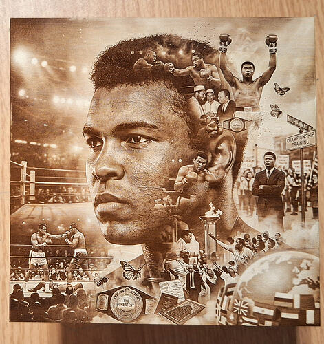

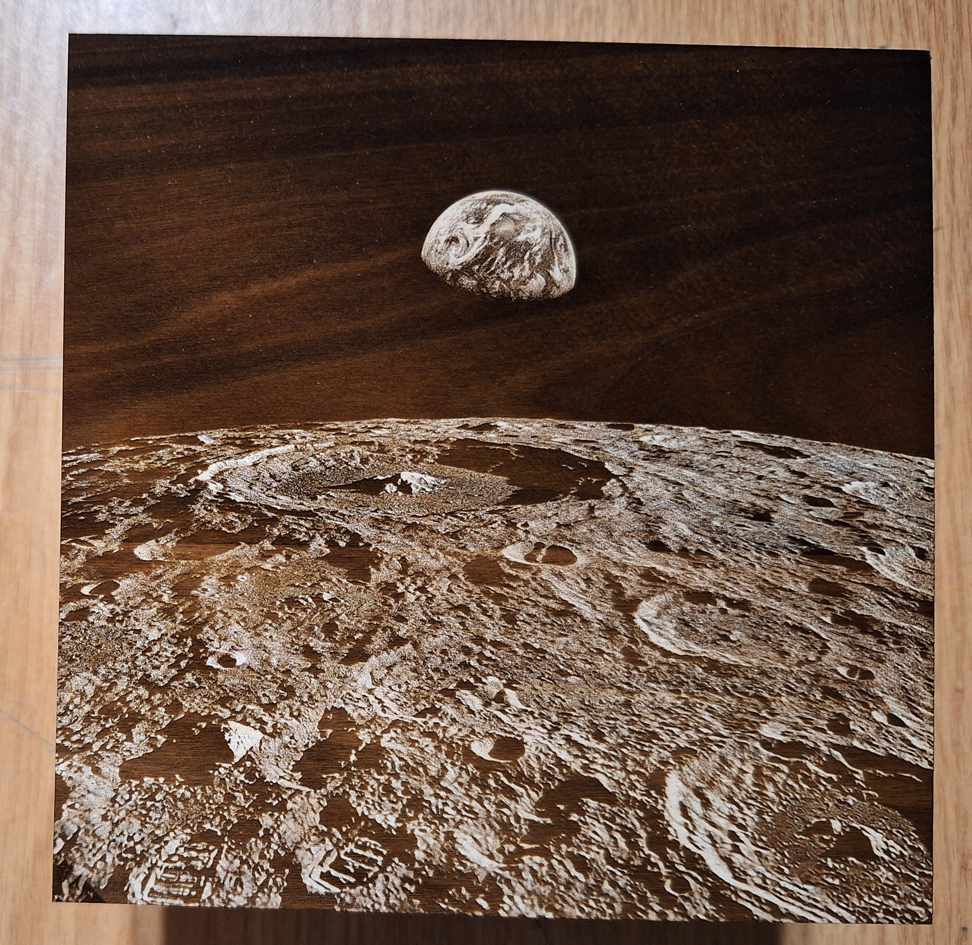

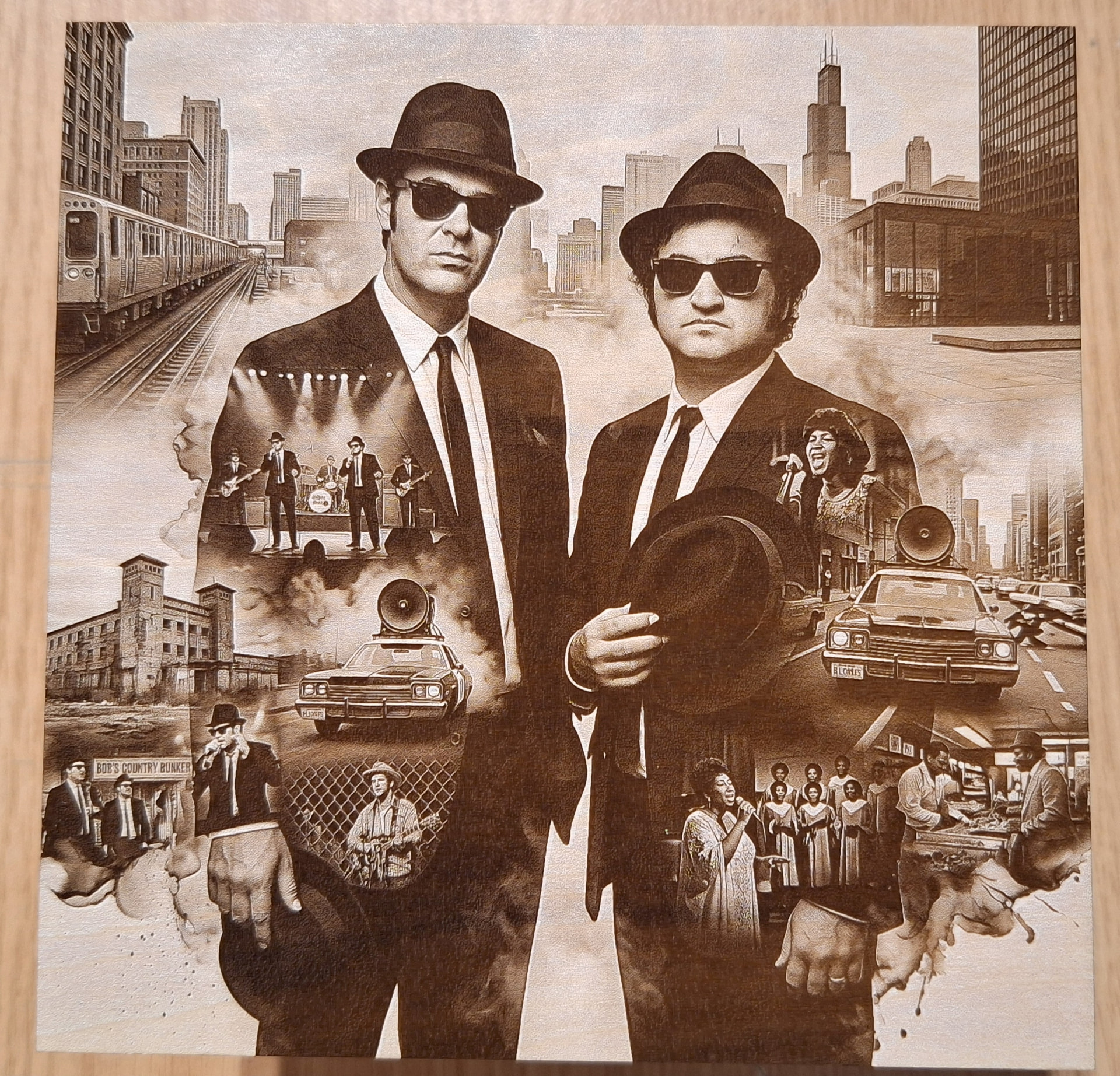

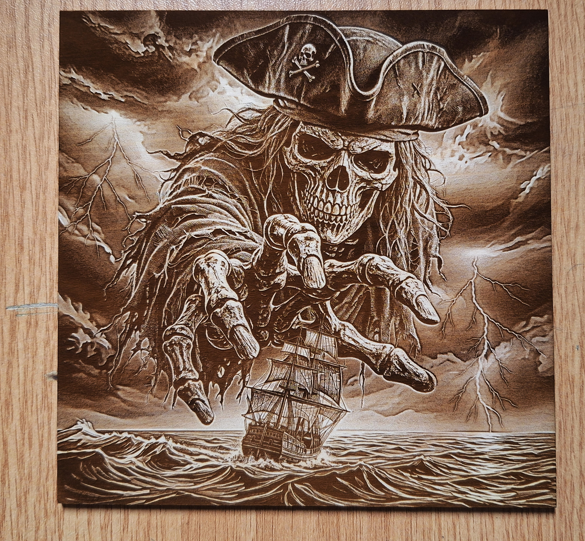

Dialling in basswood with 5 watt UV
f330 lens
LB stucki
90/80kHz/0.9 ns
 ![20260822_175412](https://forum.lightburnsoftware.com/uploads/default/original/3X/2/2/2244b30691ec0a3b066d8c0a210eafcad749a4d3.jpeg)
 ![20260822_164309](https://forum.lightburnsoftware.com/uploads/default/original/3X/7/f/7f3d699d04041cc09e83dd8ada88d936648f0179.jpeg)
 ![20260822_145916](https://forum.lightburnsoftware.com/uploads/default/original/3X/5/a/5aa0aa4defb3159f9d59ed9fb0a054be0669ddf3.jpeg)
 ![20260822_142729](https://forum.lightburnsoftware.com/uploads/default/original/3X/7/5/75aa004e5a10d6d657a82c226be8e0b123fe251b.jpeg)
 ![20260822_142714](https://forum.lightburnsoftware.com/uploads/default/original/3X/d/b/dbc9425fce05bc11dcdb8d32fb04736259a146b7.jpeg)
 ![20260821_173444](https://forum.lightburnsoftware.com/uploads/default/original/3X/7/f/7f37ef61d5576453ad3c85c1d111451e90525d58.jpeg)
 ![20260816_170902](https://forum.lightburnsoftware.com/uploads/default/original/3X/a/e/ae2b1bef6da2e3b4ed350bb286dac5f63dc7f2c8.jpeg)
 ![20260816_111001](https://forum.lightburnsoftware.com/uploads/default/original/3X/b/2/b2a9124908ad035eeac6cfcb8d783c114461f3df.jpeg)
 ![20260812_154854](https://forum.lightburnsoftware.com/uploads/default/original/3X/2/3/23584f6c9892978dfaa02be85b43b1e19a473acd.jpeg)
 ![20260812_115954](https://forum.lightburnsoftware.com/uploads/default/original/3X/1/c/1c761d6a5b5b1ec1a8686ce3e1da51f3b5fec274.jpeg)

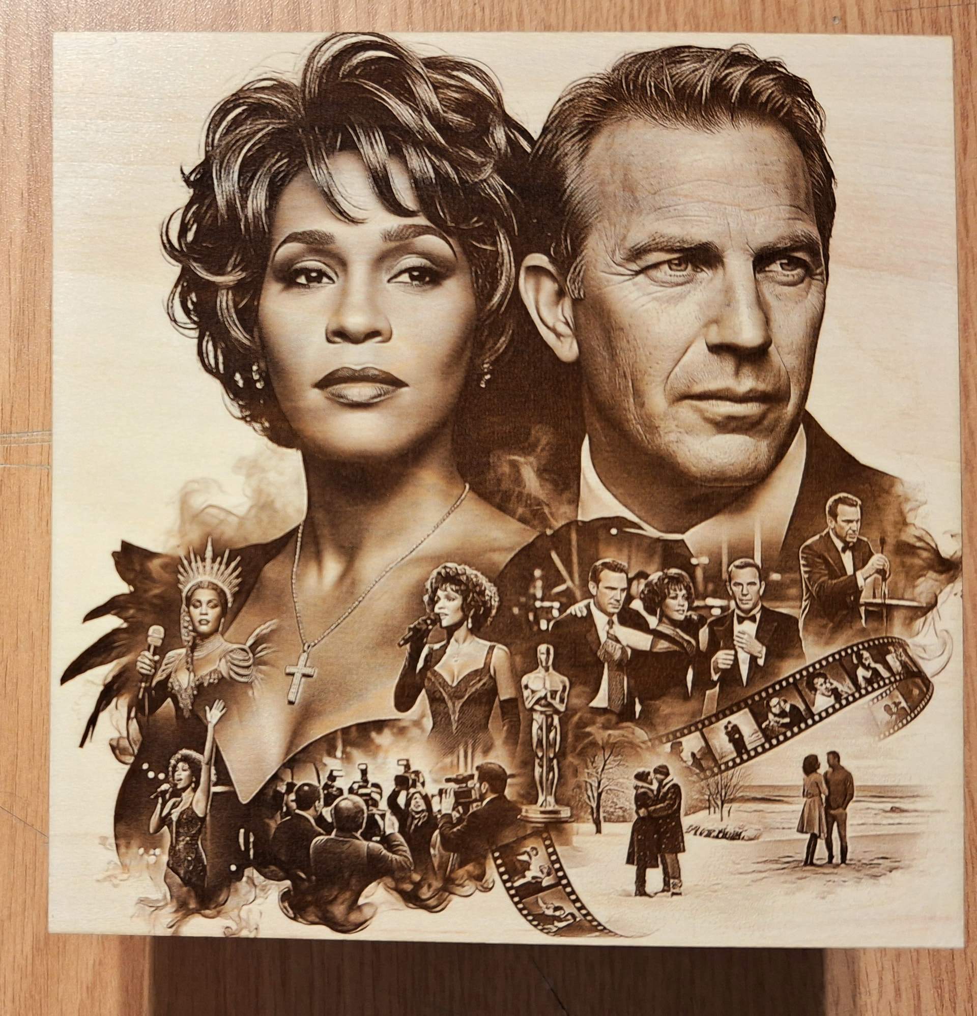

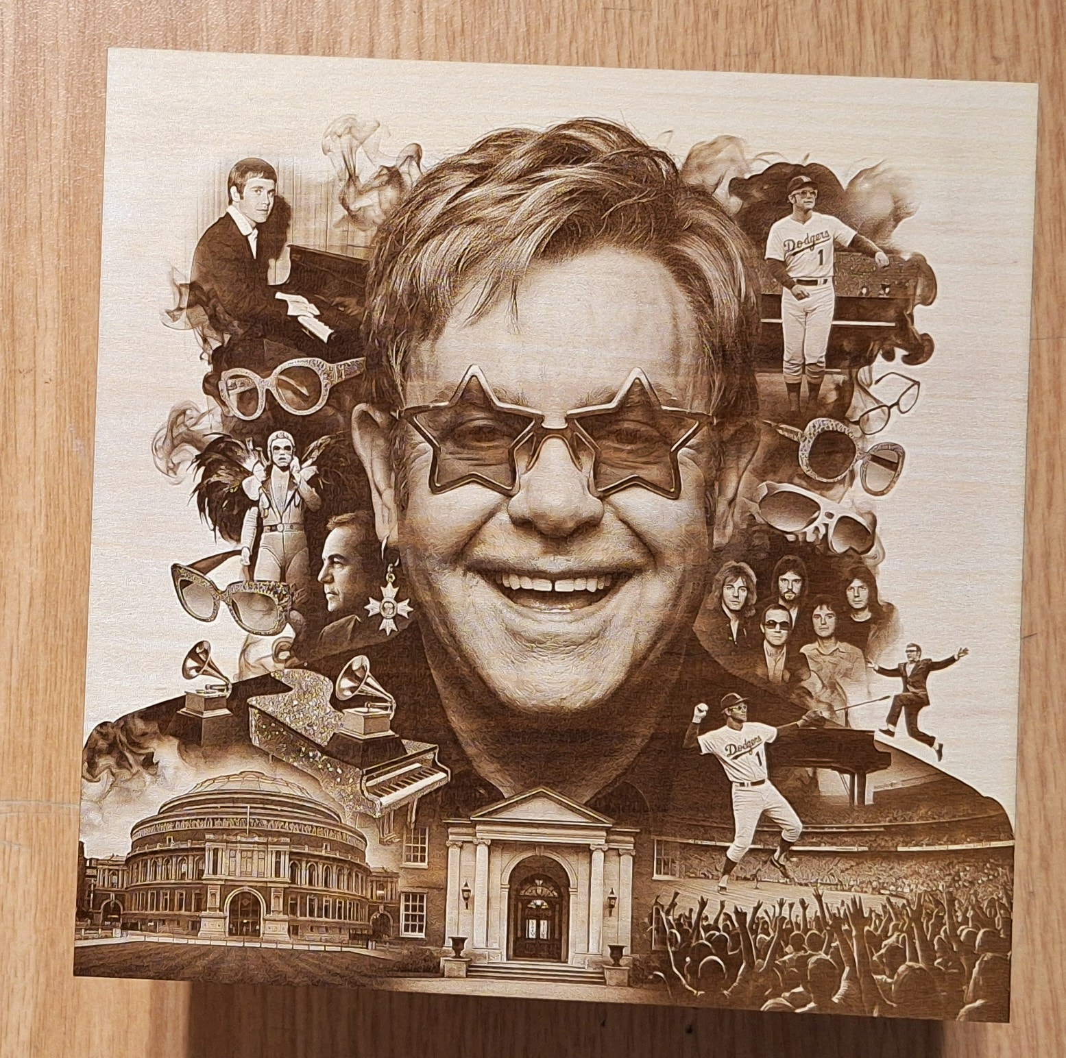

How do you get around the grain pattern in the wood.
It always disrupts my images
This is all grayscale no dithering.
 ![Image 5](https://forum.lightburnsoftware.com/uploads/default/original/3X/1/a/1ad0df9ee56a9a25a377d8e16b49b38e4b4a422f.jpeg)
<div class="post-metadata">
**Post date:** [October 1, 2026, 6:01pm UTC](https://forum.lightburnsoftware.com/t/playing-with-basswood-with-5-watt-uv/192035/12 "2026-10-01T18:01:45Z")
</div>
If you look at Elton John, you can see the grain in the middle of the image.
The only solution I know is to buy wood that had no grain.
> Woods like **basswood, ebony, popular, and sugar pine** have almost no visible grain or extremely fine, tight textures that appear smooth and uniform.
I have noticed quite a difference between Basswood and Baltic Birch.
**Author:** ![Rick292](https://forum.lightburnsoftware.com/user_avatar/forum.lightburnsoftware.com/rick292/32/123506_2.png) [@Rick292](https://forum.lightburnsoftware.com/u/Rick292)\
**Post date:** [October 1, 2026, 6:26pm UTC](https://forum.lightburnsoftware.com/t/playing-with-basswood-with-5-watt-uv/192035/13 "2026-10-01T18:26:12Z")
</div>
And always run the burn direction against the grain. NOT WITH IT.
