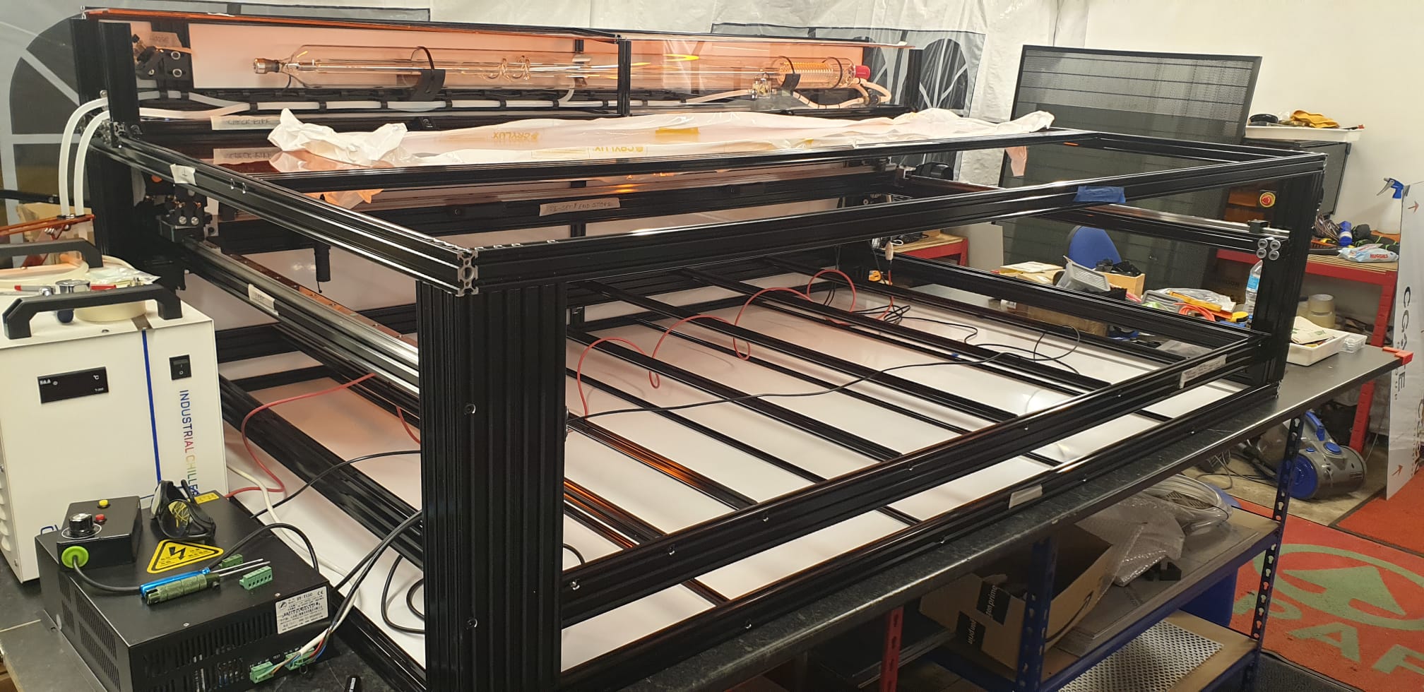

Having some problems setting up this new laser, Its running a MKS DLC32 Offline Controller 32bits ESP32 WIFI GRBL and was working perfectly on a 60 watt laser that I configured and sent out a few weeks back, move on and I’m just just finishing this large new C02 but using the exact same model of controller ( I bought 10 in a cracking deal) firmware etc but on a 160 watt tube and much larger machine like 2.5 times the size, this one is a behemoth, 2.3 metres long by 1.2 frame size. Unique positioning of the tube box etc…
The video will show the problem that is happening, it appears to be stuttering, on the other laser that went out there was no skip/pause at all when doing this, it just went seamlessly and smoothly not like this one at all in the video. I am not sure if I am doing something wrong, missed a setting or what :thinking: :thinking:

Overall view of Laser prior to optics and bed install.

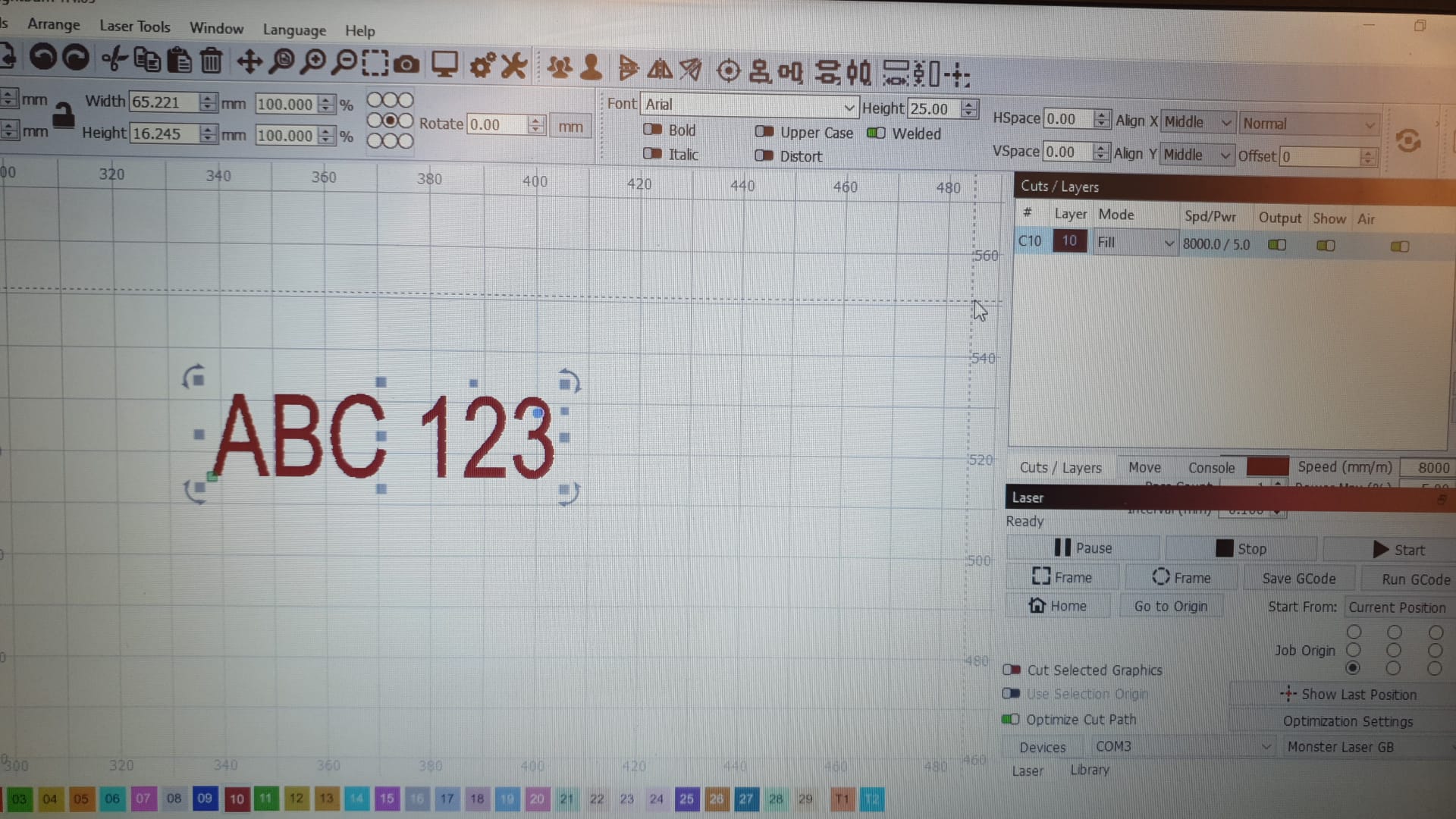

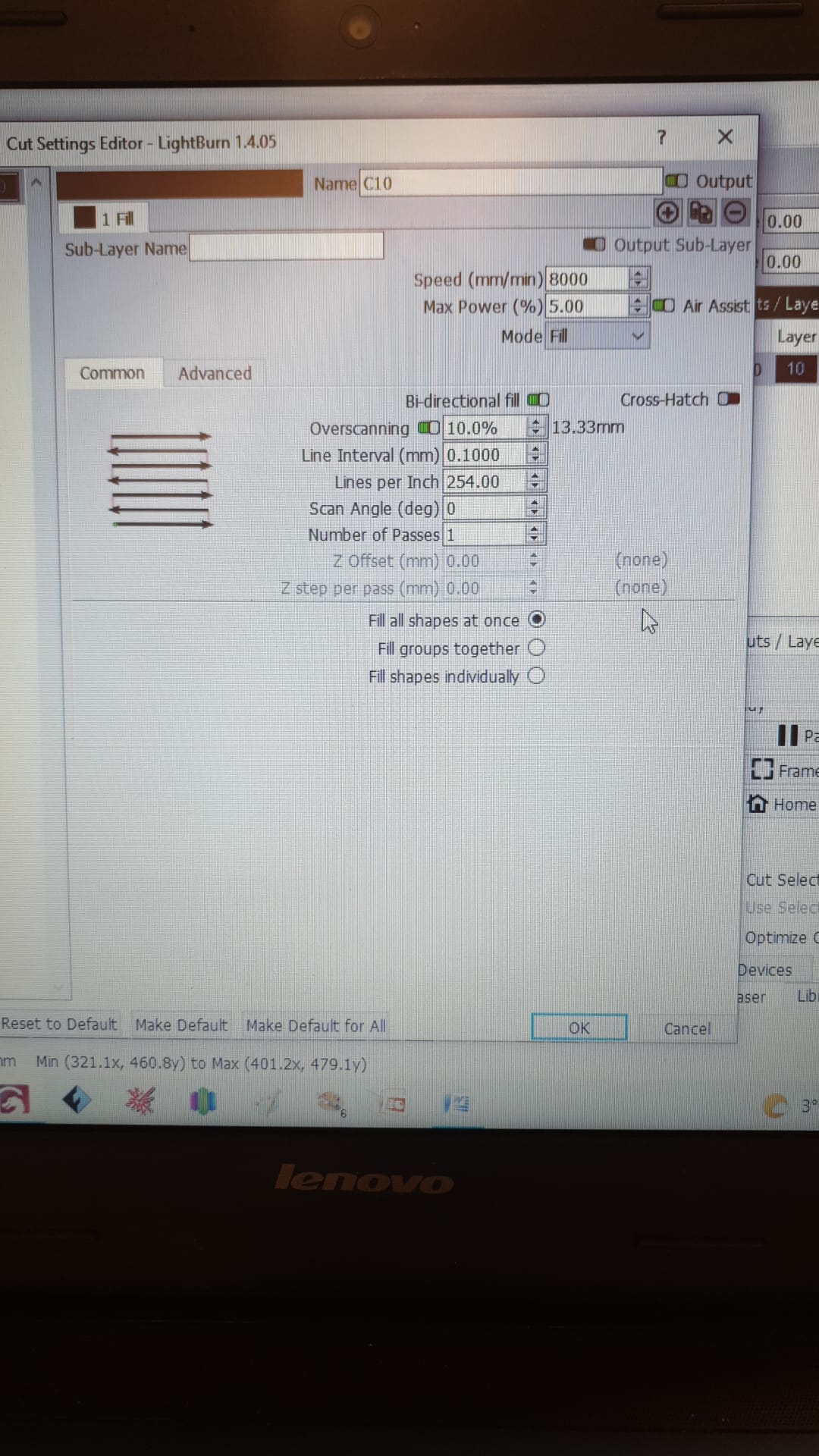

Fill Settings Page Screenshot
Lightburn Desktop Screenshot
**Engraving Video Link showing the “pauses/stutters” instead of a smooth transition.
This video shows the “stuttering” between each letter being engraved.

I assume you have sized your steppers and current settings appropriate to larger machine.
I watched that video several times. The pulsating sound appeared to be the air assist pump.
As it traversed across, it was fast in the non burn areas, and slowed down for the burn sections. this is exactly how it would move if Fast Whitespace Scan is turned on in the Device Settings window. Is that it?
