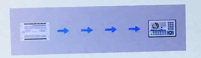

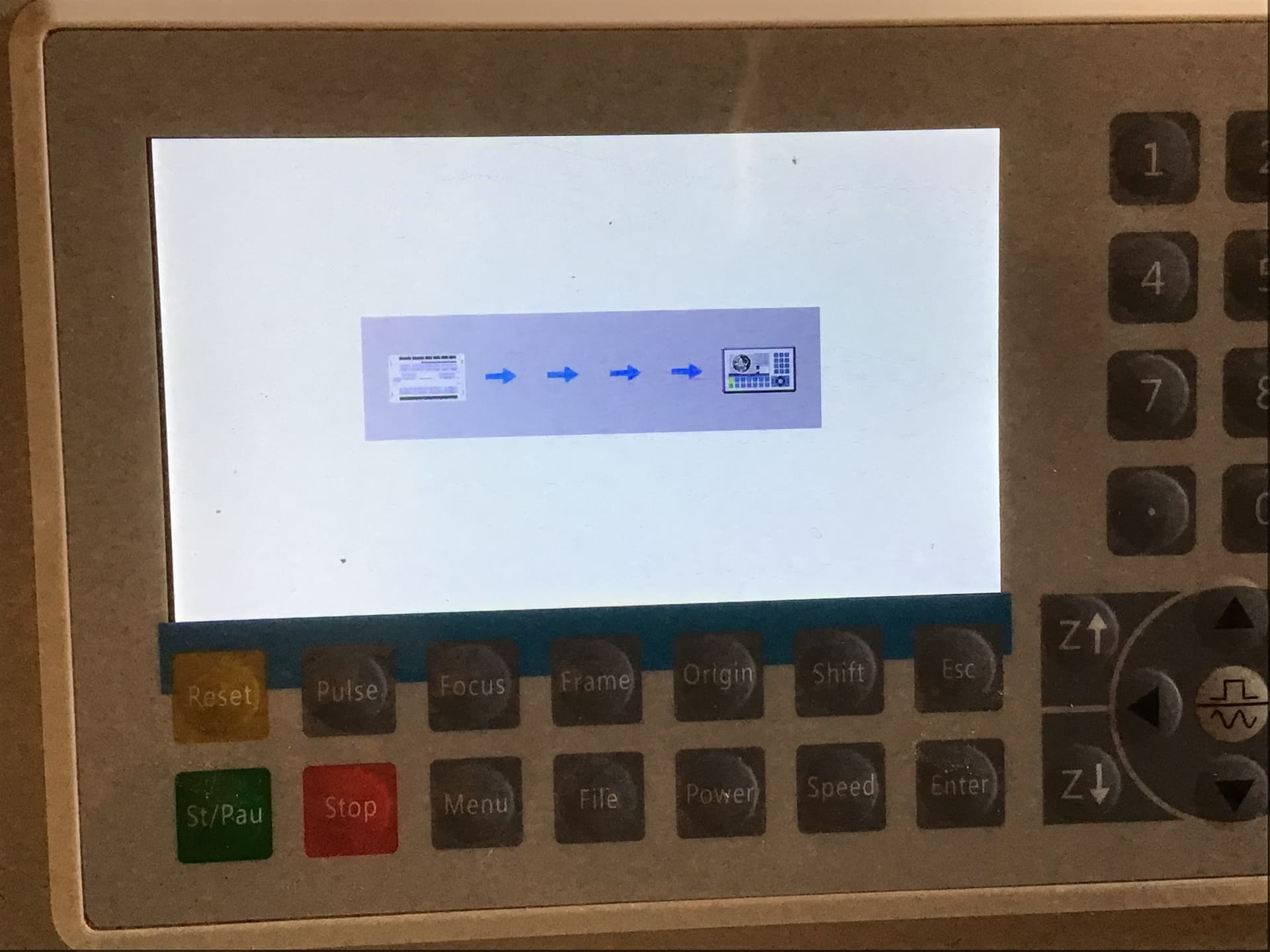

Can anyone please help. I can’t find an engineer to come out. The screen on my Chinese 100w CO2 laser is unresponsive. It has what looks like a file transfer symbol. None of the buttons respond apart from stop which clicks but does nothing. The laptop has no effect. Switched off and on - nothing. Menu is inaccessible.

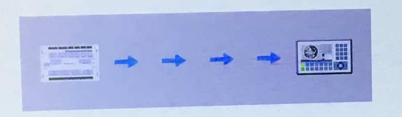

Given this:
Check the cable between the display panel (labeled HMI = Human Machine Interface) and the controller, because that image suggests it’s disconnected.
With the power off, unplug and replug both ends, making sure the connectors sit squarely in their sockets.

The console is trying to connect to the Ruida, as @ednisley pointed out.
It could be the console, Ruida or anything in between. Re-seating the connectors is about all you can do.

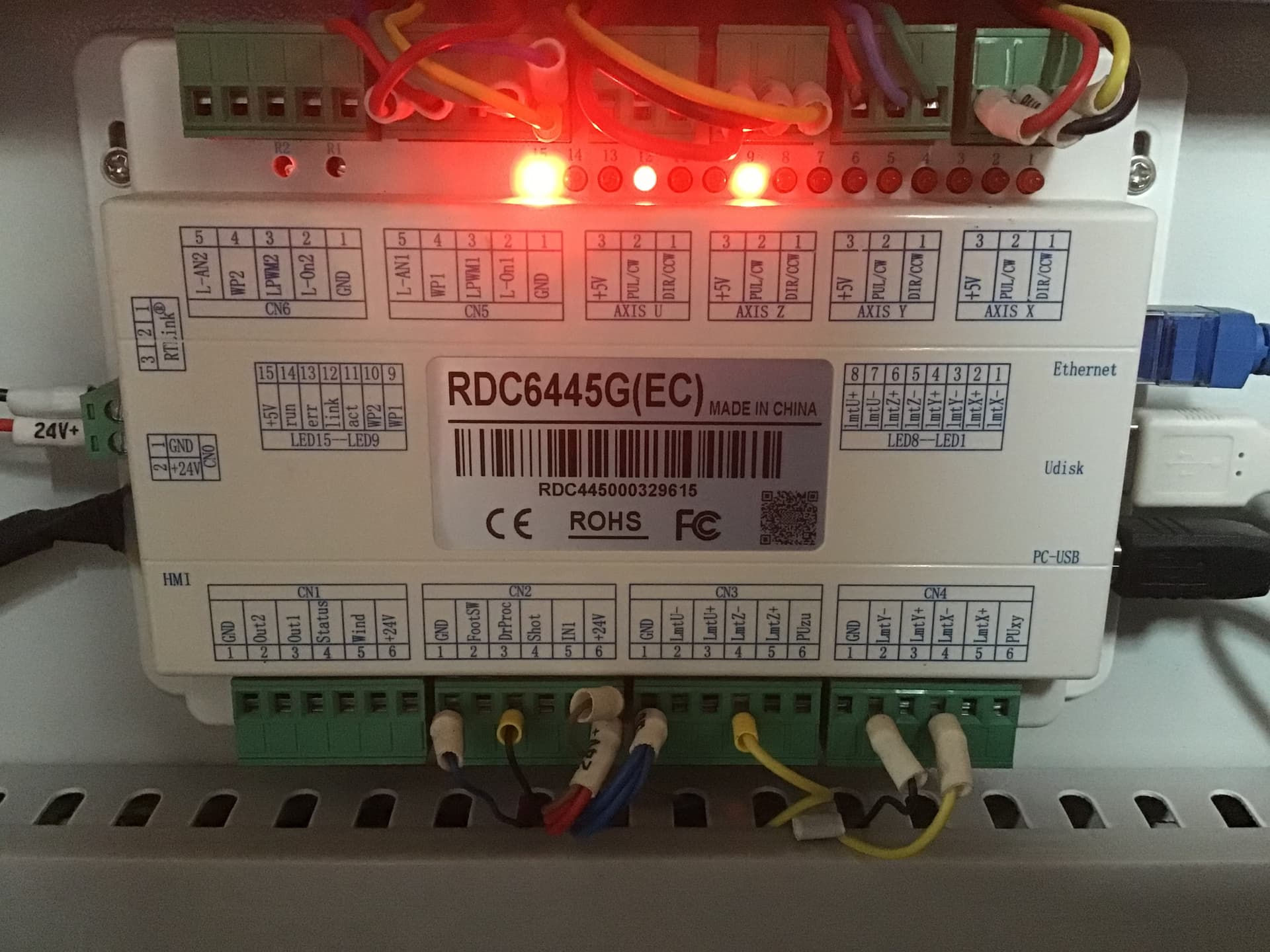

Apparently your indicator light no.13 is not on, error indicator light…I don’t have a Ruida, but I think there are one or two solutions
-1 reset with a key combination.
-2 reset via a shunt on certain contacts on the terminal block, or a vault in the box. It’s curious.

LED 13 being off is the indication for no error, so the controller isn’t indicating a problem. There is, in fact, a problem, but not connecting to the HMI doesn’t trigger that LED.

I’d check the +24 V power supply (which seems OK, but it’s easy to check), extract the controller + HMI from the machine and wire only those parts on the bench to a different power supply, then see if it suddenly starts behaving.

When I got back I was out in the workshop trying (and failing) to do some of the things you suggested. HOWEVER - I discovered that with the screen attached nothing works, but if I disconnect it I can work the laser direct from Lightburn to the RUIDA via USB. (I discovered that my laptop doesn’t have an ethernet socket.)
I’m trying to get hold of my mate with the multimeter.
I plan on testing the HMI communication cable and if that’s ok I’ll buy a new screen.
