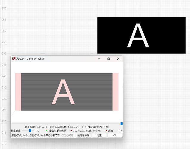

As you can see in the image, I don’t want to do anything to the “A” part, but I want to cut around it. Please tell me how to create that data. You can also create it using Illustrator.

Is this what you want?
that’s right!
However, how did you make the inside of the square black?
That’s not possible.

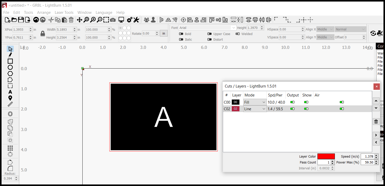

Create the square. Put the Text inside it. Set the layer to “fill”. If you don’t see the fill on your screen, make sure you have view style set to “Filled/Smooth” or “Filled/Course”
You are want to engrave everything around the A?
yes. That’s right.
thank you!

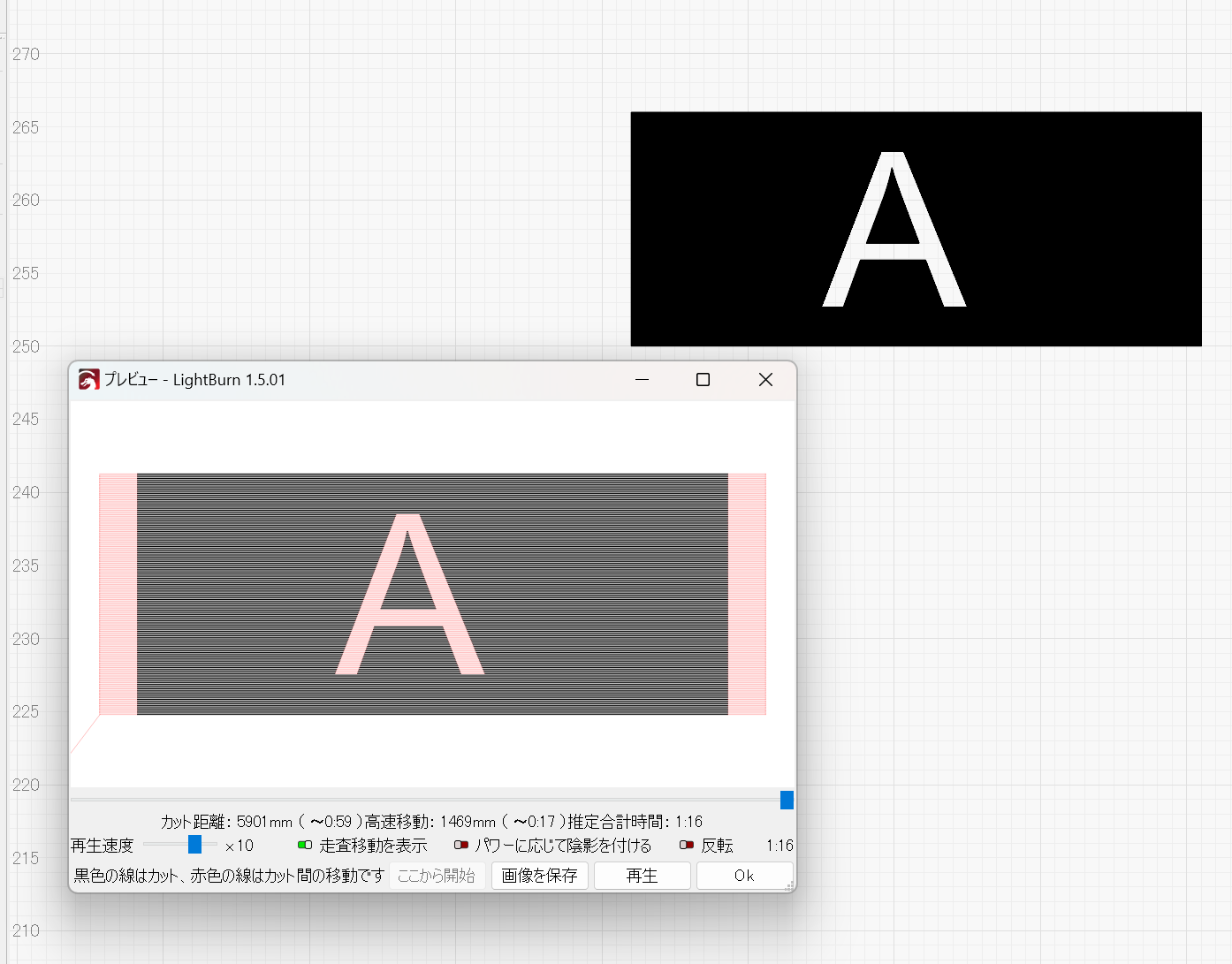

But when I preview it, it looks like this

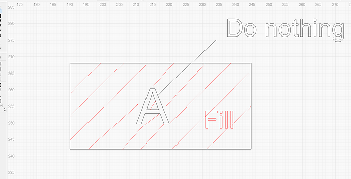

Do you think you might want to FILL “A” too?
Maybe it could have been done? !
Is this OK? ?
You can also do something like this, where the RED is cut, and the BLACK is a fill.
Thank you very much!
Thanks to you, I solved it!
