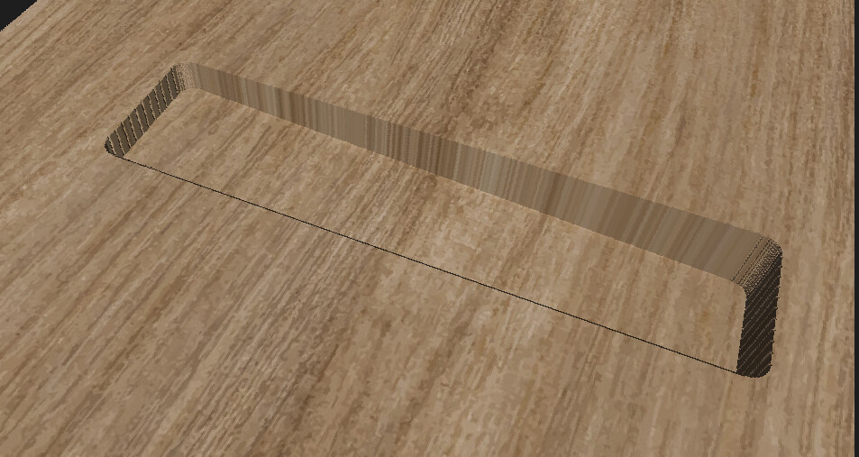

I’m wondering how to create a pocket where the bottom slopes. For my case it would be a linear slope starting at 1 mm depth and going down to 4 mm across the length of the pocket.
Are there tools built into millmage to accomplish that or would I need to import a model?
Thanks
Millmage will not currently support this.
It’s planned, but dynamic Z handling within an operation won’t be available for a fair while yet.
The next version of MillMage will have Fluting operations. It won’t create sloped pockets, but you can create sloped lines, and an array of those will likely do what you want.
